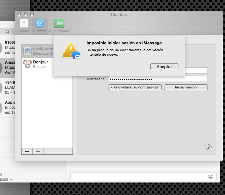

In my case, El Capitan works very well. IMessage has always worked fine without a proxy. But Yosemite does have a problem. With your proxy installed, IMessage asks for the code. Apple sends it and adds it to the password, but it hasn't been activated: "An error has occurred." I can't identify the error
2025-09-16 07:31:38.jpg
Reactions: DurltazorOSXPower
Only with my proxy? This sounds like https://apple.stackexchange.com/que...n-into-imessage-on-os-x-10-9-mavericks/474585, but that wouldn’t be proxy related.
Maybe Apple is using certificate pinning on Yosemite too? I only test Aqua Proxy on 10.6 – 10.9, it’s called Aqua proxy after all!
¿Solo con mi proxy? Parece algo como https://apple.stackexchange.com/que...n-into-imessage-on-os-x-10-9-mavericks/474585 , pero no estaría relacionado con el proxy.
¿Quizás Apple también esté usando la fijación de certificados en Yosemite? Solo pruebo Aqua Proxy en las versiones 10.6 a 10.9; al fin y al cabo, se llama Aqua Proxy.
I understand. I'm having problems with and without your proxy. I'm also having problems with the keychain, and it could be the expired certificates on the server. Thanks for the heads-up.
