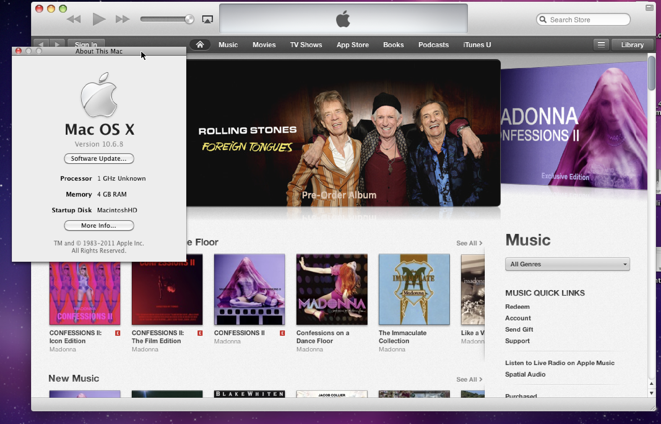

hello man, my itunes its working but i not updated my aqua proxy, i have used version older.
my itunes is version 10.

That 32-bit slice is compiled against an older version of Go and may not work as reliably. Sorry, 32bit isn't a priority, as long as it nominally works that's where I'm going to leave it.
No problem, I just found it viable to comment, other than that, everything is working as it should, I can read my icloud emails and my calendar perfectly, thank you for the software.
