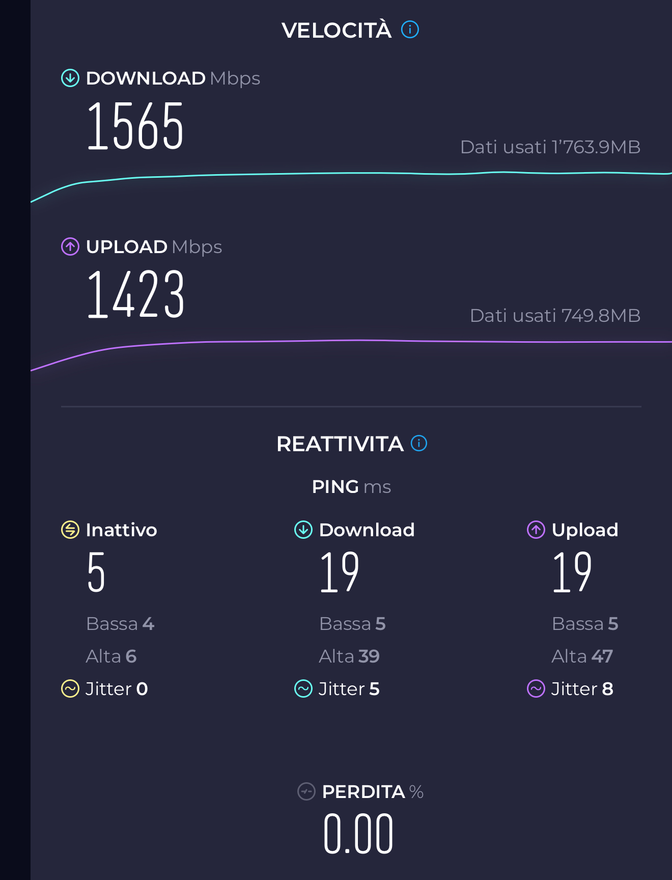

Fiber is 10 Gb, so WiFi is faster than wired when I am close enough to the main router:
Still, I use wired connection wherever I can, like for the iMac, a Mac mini used as headless media server (mostly for Roon), the tv, the Apple TV, a media streamer and so on.

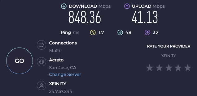

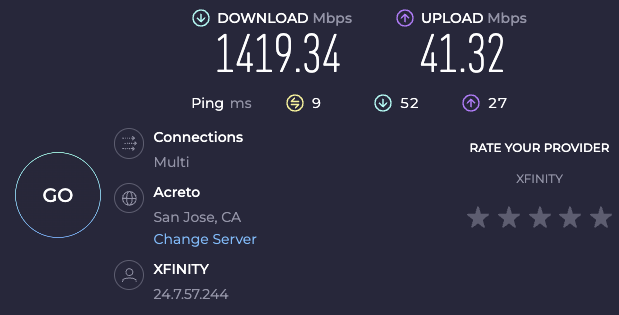

also have base M4 Mac mini setup, I endup using hard wire USB4 to 5G adapter plug at the back of mini4 (thunderbolt port), see speed differences Wifi 6 (AX) vs hard wire (Cat 5e), Xfinity plan 1.2gb/40gb.
Reactions: Kargo and alecgold
