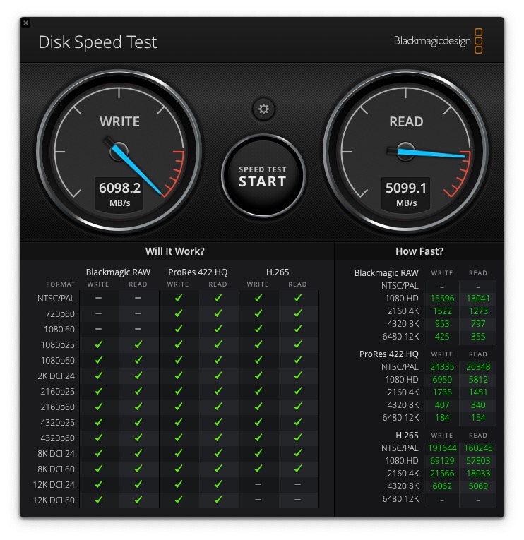

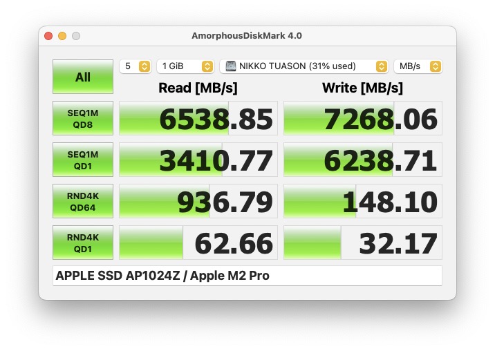

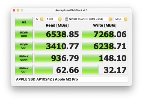

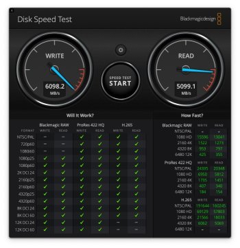

On a M2 Pro 1TB:
Edit: I just re-read your question. Yes the 512GB M2 base is slower than M1 base.

On a M2 Pro 1TB:
Your terms are confusing the issue.
For the M2, the 256GB disk is slower than the 256GB M1.
For the M2 Pro, the 512GB is slower than the M1 Pro, but it is equally as fast as any of the computers with the M2 (non pro, non Max) processor and it’s faster than any Intel Mac, except perhaps some of the very largest disks in the 2019 Mac Pro.
I regularly use a 1TB M1 Pro and a 512GB M2 Pro and cannot feel the difference in performance. It’s only when I run a benchmark app that I can tell something is different.
