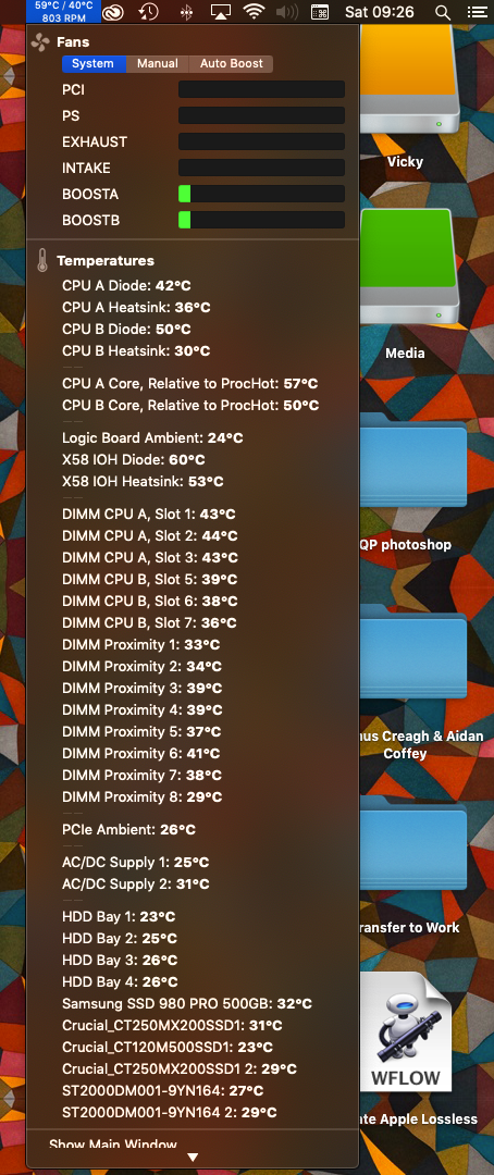

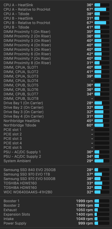

Apoolgies for hijacking the thread! I also recently upgraded CPUs and wonder if my CPU and NB temps look OK? The screenshot below is from iStat Menu at idle. My system specs are in the signature. Thanks!
CPU A is fine, CPU B cooling is bad.
The CPU B temperature is OK at this moment, but the fans need to work harder than normal. Also, CPU B will have higher chance to get into thermal throttling.

Read it again on idle,
fans set to standard speed.
if all is well I guess bad paste, maybe a fingerprint on processor or heatsink.
Hmmm, crap. I dunno why? Bad paste job? Heatsink not fully screwed down? It's the diode that's high, the heatsink is comparable to before. Does anyone have any advice?

+1 for checking contact CPU B heatsink /die.
As suggested by @Macschrauber too: read Temps at idle with fans on auto , if possible post a screenshot.
The Delta NB looks excellent !👍

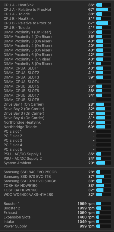

Thank you all for your feedback. Much appreciated! I have monitored temperatures for about one week now since your replies -- I wanted to make sure the screenshot I posted here last week was indeed consistent over time -- and indeed it is! Pretty bad temps for CPU B and they get worse with more pressure, like 20C difference!
I have to say that I never had temps above 40C for either CPUs up until I upgraded to Big Sur, but anyhow, regardless of that, I understand that I need to take care of this temp issue ASAP!
Please help me better understand the following (and hopefully your answers will help future newbies as well!!!):
1- What is the preferred range/difference (so called delta?) between CPUs Tdiode and CPUs HeatSink?
2- What is the preferred range/difference (so called delta?) between NB Tdiode and NB HeatSink?
3- Why is the NB delta higher than the CPUs delta..? Or so I seem to understand form several threads on temps?
4- Would you suggest I first try to tighten a very tiny bit (like 1/4 turn) the HeatSink of CPUB before I do a whole new paste job for that CPU? When I swapped new CPUs I was very paranoid with over-tightening and I am pretty sure I tighten less than I should have for both of them. Apparently CPU A ended up OK but CPU B definitely is loose.

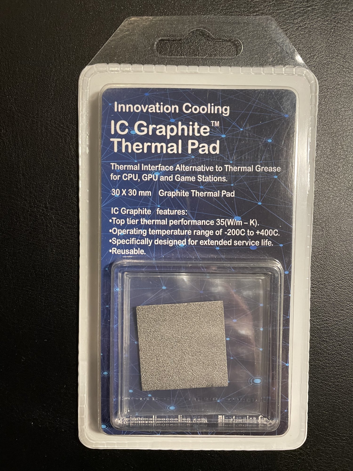

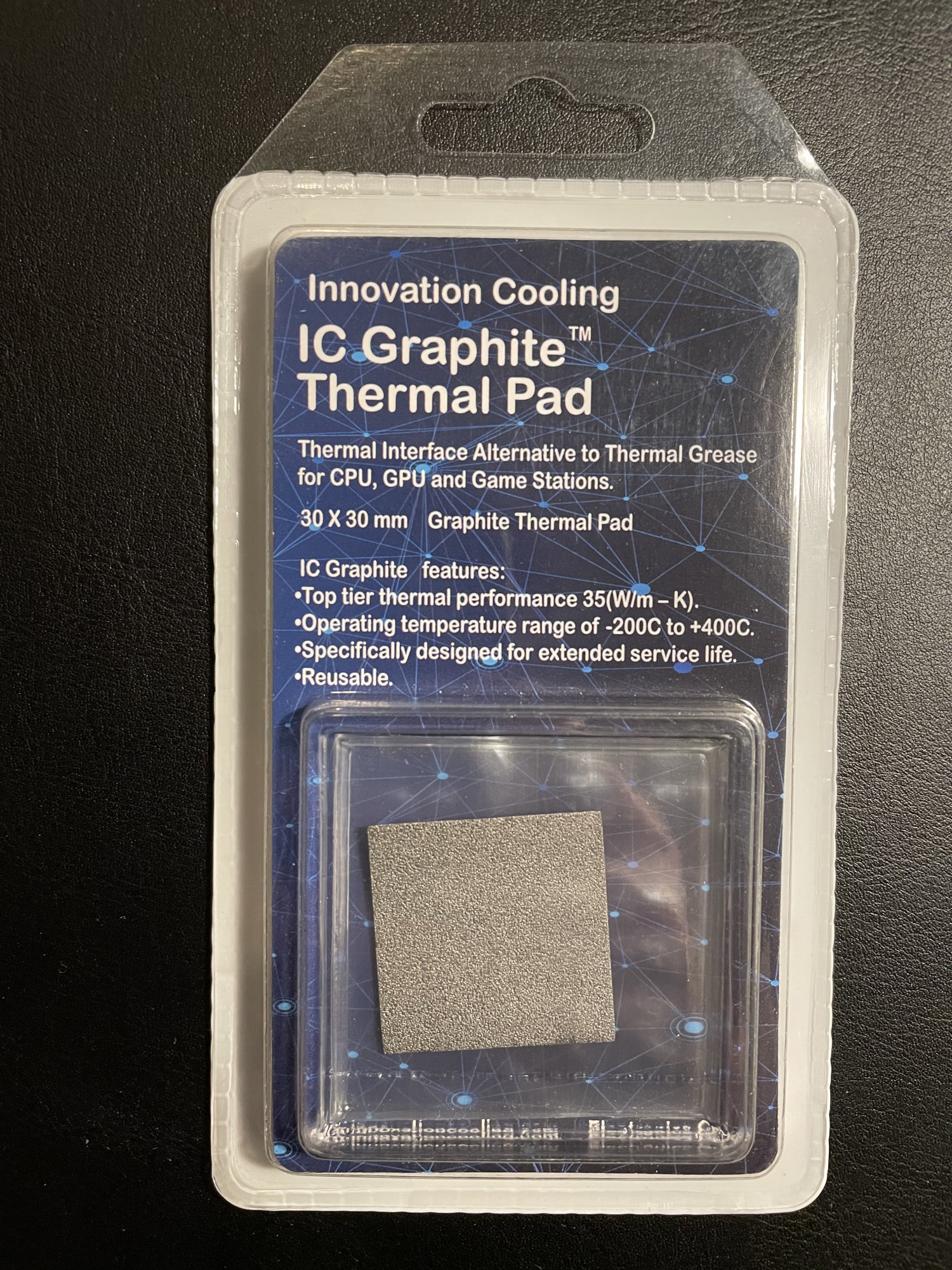

5- When I swapped CPUs I used the MacRumors-famous Arctic MX-4 (but not the 2019 version!). At the time of getting ready for the CPU swap, I also got the graphite little thingy here attached as an image and recommended by @h9826790 in another thread about temps... should I try that graphite thingy or stick to the paste instead? I still have enough MX-4...
Thanks! In cMP we trust!!!

Imho when CPU Diode, Heatsink and Core have a delta of 3 Celsius at idle its basically ok.
When heating up the results vary cause the massive heatsink is taking temperature slowly.
thanks. how about the NB optimal range? it seems from various threads that it is a much wider range between 6-12C is this correct? My NB to HeatSink difference is pretty consistent at 15C.... which I have read it's borderline...? again, I know these temps are hard to set to stone but a "reasonable" suggested range would be very helpful to have for all newbies bringing those x56XX into our beloved cMP!!!!
when I see 9-11 Degrees Clesius its ok in idle.
you really cant set it in stone as it differs from single to dual and from what you stuff in the Mac Pro.
also the Die heats up faster than the heatsink.
its not the best method but to be comparable I prefer take a first look at Idle.
you should see processor loads very low and standard smc settings.

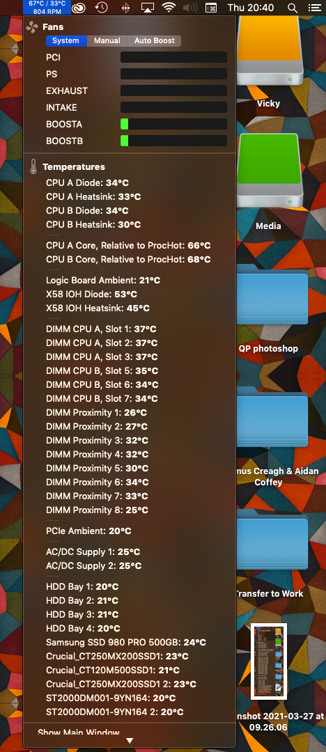

So I must confess that I hadn't actually fully screwed down either of my heatsinks post after my Northbridge stay replacement.
After fully cranking them down finger tight I get these temps at idle:
CPU A is definitely at 3ºC delta at idle (sometimes momentarily lower as seen here). CPU B rarely gets as low as 3º usually 4 or 5ºC. Is that a problem?
Thanks again...
