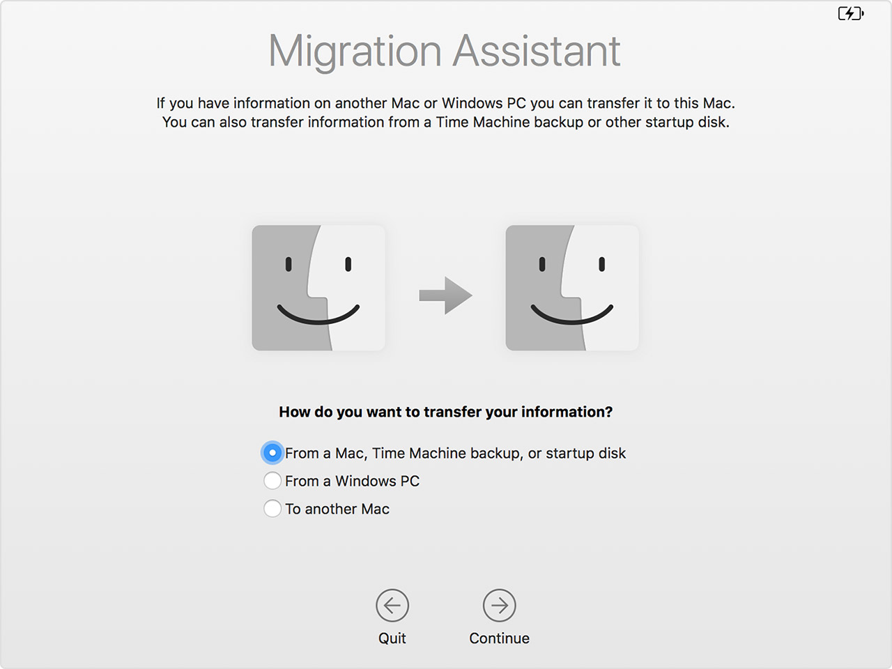

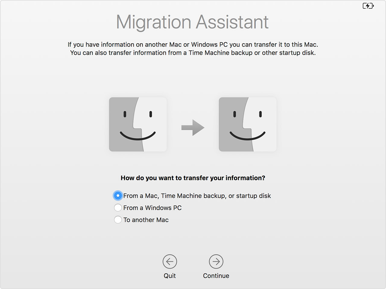

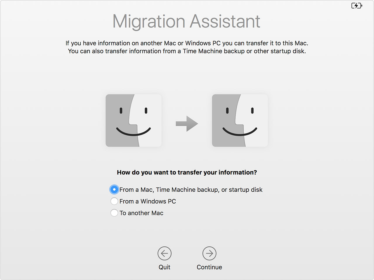

I am not a computer person and would appreciate help.
I just bought a new APSF formatted Mac with Mojave. My old Mac is Journaled formatted with El Capitan. I would like to migrate everything except the OS from the old to the new Mac.
I have ARQ, CCC and time machine backups of the old Mac. I searched the internet on how to do the migration. There are various ways of doing it, for example using the CCC backup or connecting the two Macs together and using setup or migration assistants.
I was overwhelmed with information and got confused. So I called the Stanford apple store for help. An employee told me that the easier way is to use time machine as connecting two macs together carries some risk. If I don’t know what I am doing, I may ruin the data of both macs.

Using either the TM or CCC backup as the source will have the exact same end result.
If you have an external SSD you can use for this, I would make a CCC backup/clone to the SSD. IMO that will be fastest during the import. TM uses this weird system of hard links that I think slows down imports like this.
The BIG key here, and the Apple Store tech mentioned it, is to do this during the initial system setup. When prompted, say you want to import and point to the CCC disk and off you go. DO NOT make an account on the new Mac then try to import with Migration Assistant afterwords. That can cause all sorts of permissions problems.

If I use CCC, I would select “restore from CCC backup” and click on the CCC Bakup drive icon?
So the difference between time machine and carbon copy cloner is just the speed of migration; both produce the same end result?
When I did CCC backup for the first time there was an issue whether to include the startup volume(not sure what it was). I select to include the startup vol. will this inclusion mess up the migration?
I do have a spare SSD for use in migration.
Not exactly... during initial setup it will ask if you want to import data. Say yes and you will get a screen similar to this (this one is from Migration Assistant but it looks similar). Pick the first option then in the next step pick your CCC disk as the source and off you go.
Yes... exactly. :)
I think you might have seen something about including the recovery partition. That won't matter either way for what we are doing here.
