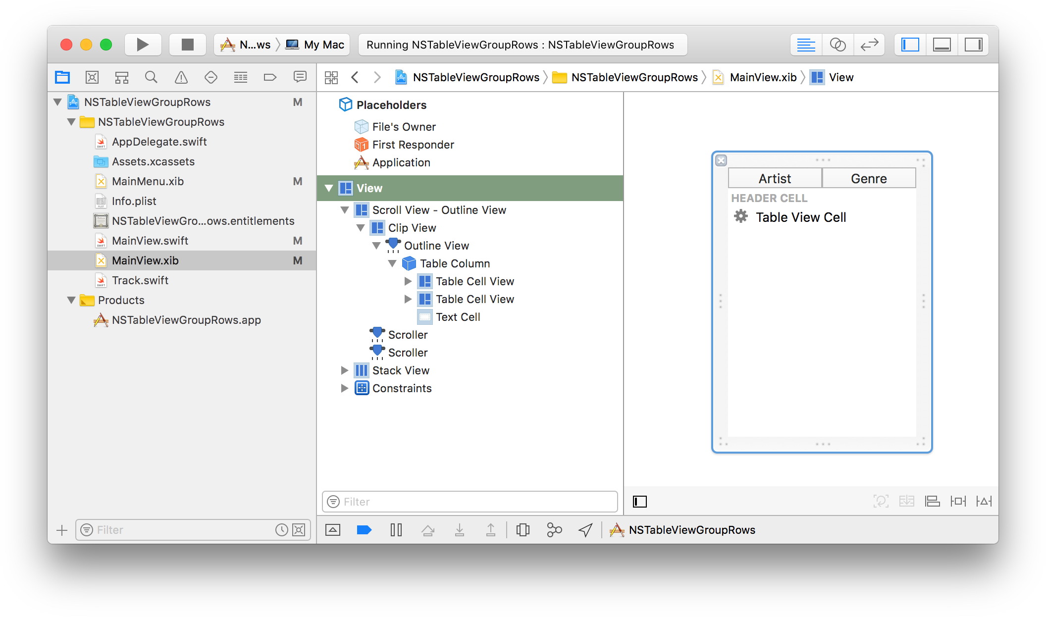

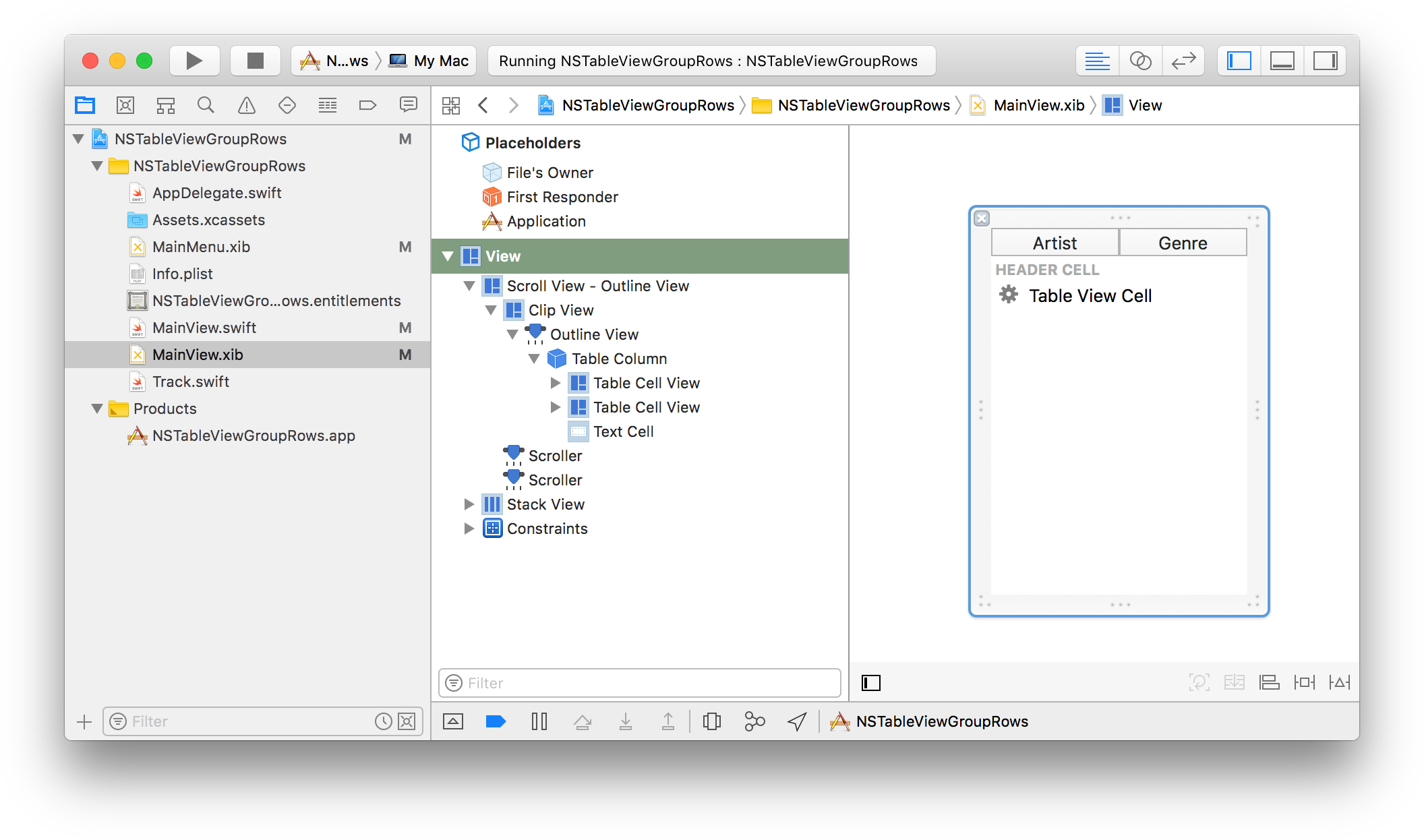

And this is the whole view structure:
View attachment 736808 Theres no tab view or whatsoever involved. Just remapping the tracks array. And only a one data model for a single track. But if you're interested in the code you could probably just check out the github.

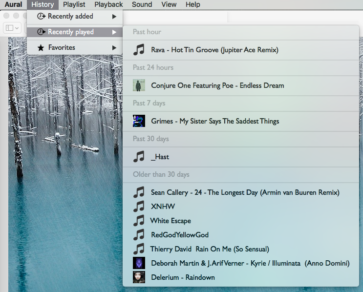

History now keeps track of a timestamp for each item and groups items in menus by that timestamp.
This is great!

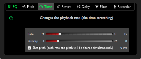

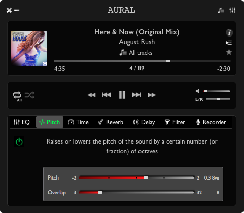

Feature enhancement - The Time effects unit now allows the pitch to also be altered simultaneously (this is similar to what YouTube's speed adjustment does ... alter both rate and pitch). The old behavior is also still an option (rate change without pitch shift).

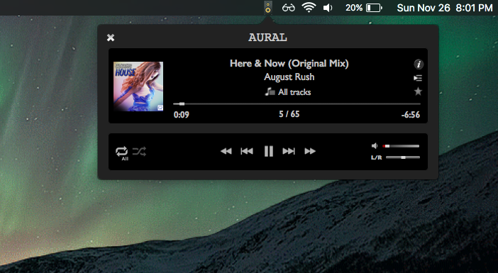

Also, coming soon ... Aural Player will be able to run in the status bar, and switch between status bar mode and regular mode.
Reactions: Tobias_Dunkel
I love the little fun things this app can do and will do. Hanging from the menubar is a great idea.
Thanks :D Yes, I figure that some users like to run music player apps (or apps in general) off the status bar, esp. since music players run in the background most of the time anyway, while the user is working on other apps. So, the ability to run in the status bar adds a bit of flexibility/adaptability.

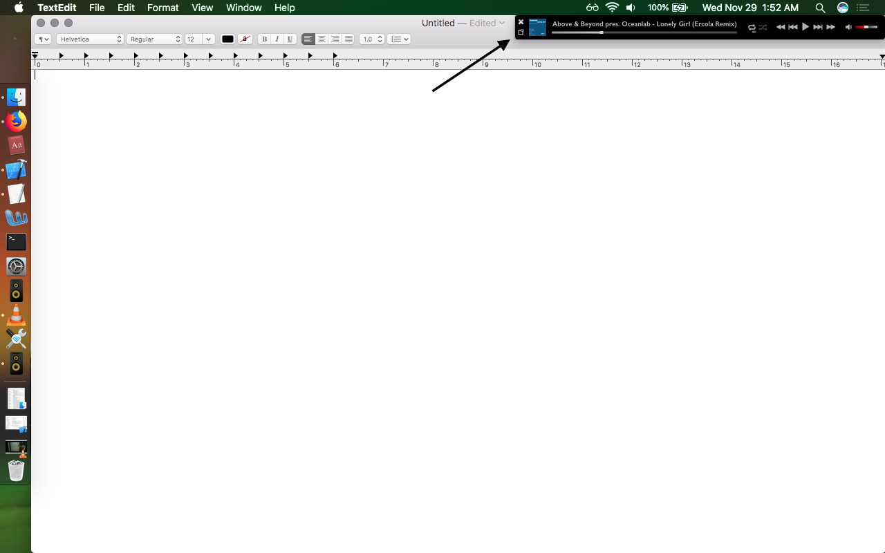

Would it be possible to make the design more square when hanging from the menubar like that? And possible to take out of the menubar and leave on the desktop? E.g. By dragging straight from the menubar with one drag downwards and again reattached automatically when left near the menubar for 1 second or between 1,2 - 1,5 seconds?
Could Aural when appearing like that then be on the Desktop when the user clicks the coverart in Aural and appear with a 96x96 pixel coverart (96x96 could a bit higher like 128x128pixels) One just have to take account for those on lower res Macs that doesn't want coverart to be the biggest size of the standard of early Mac OS X icons.
Hmm...
Actually, this mini bar is free to move. I know the picture I posted made it look like it's hanging from the menubar, but it's not. It's just docked there. It can be put anywhere on the screen, and will stay on top, so you can control the player while you're working on other stuff.
This is a different concept from the status bar player I posted about previously. I'm just trying out something new.
The drag drop idea is nice. Will have to see how easily/well it can be implemented.
And yes, there will be a button to convert the mini bar (or status bar player) to a full-size player (and vice versa).
Hmm...
If only I read the entire post you made - it clearly stated floating... sigh.. me.

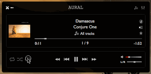

Added a new feature: Track segment looping aka "A->B loop"
The user can define a start point and end point using either a (new) dedicated control button or keyboard shortcut (Command L), and the demarcated track segment will loop indefinitely and be rendered in red color on the seek slider bar. The loop can be removed using the same controls.
The feature is available in the latest app bundle.

Working on a new concept: a "mini bar" that can be floating (i.e. always on top).

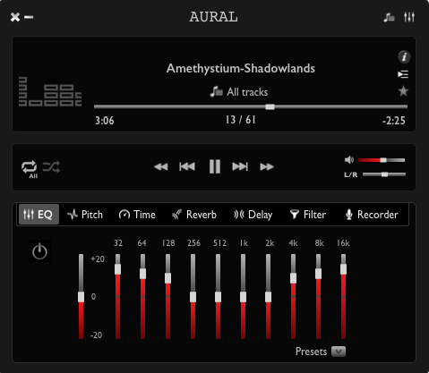

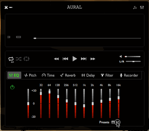

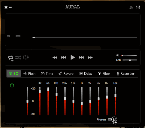

The user can now save Equalizer (EQ) presets
Damn, while writing my post you added yet again another killer feature!
Have been looking forward to something like this. It makes the Equalizer quite a lot better :D
