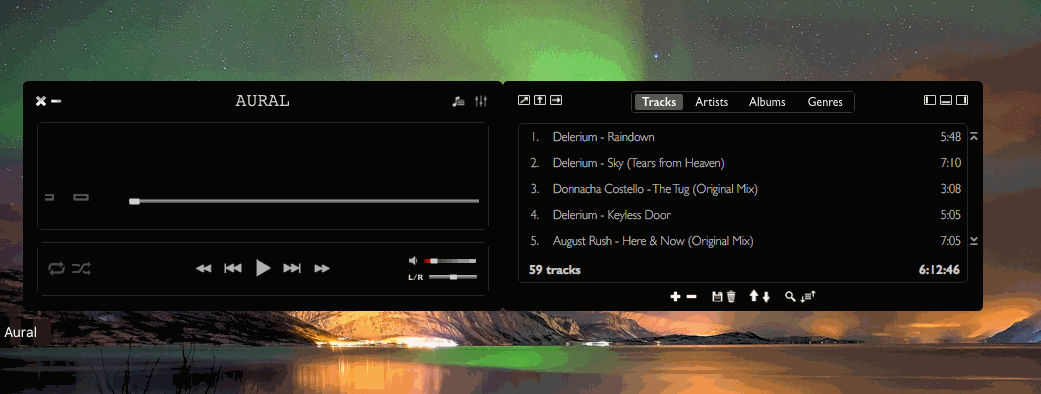

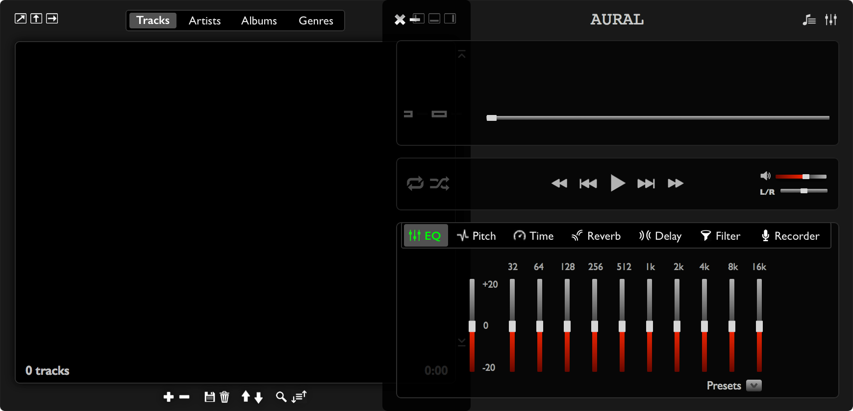

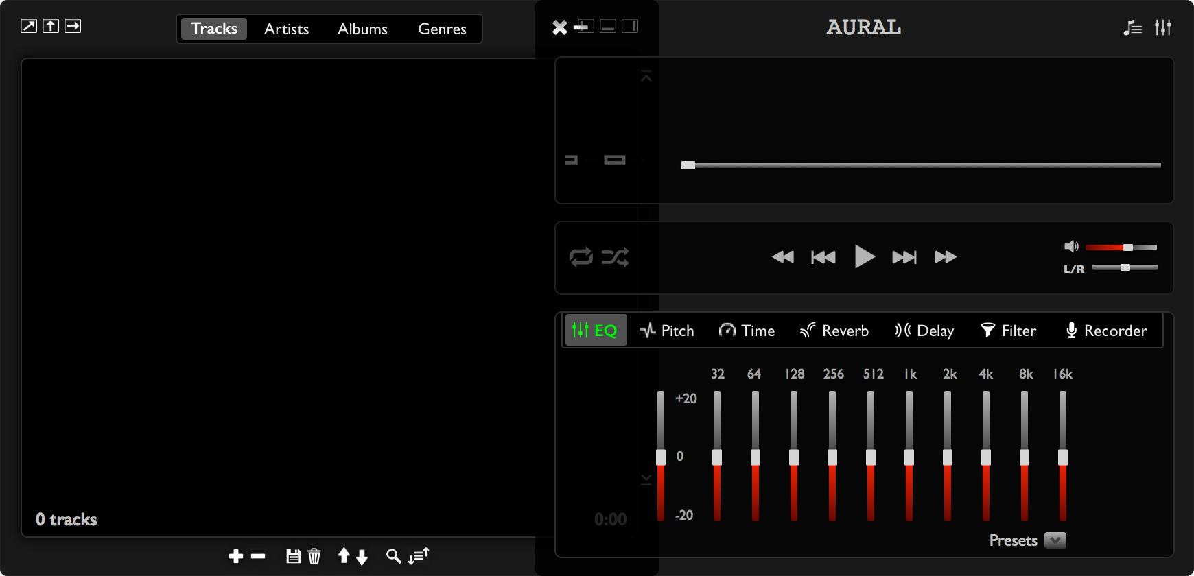

For example docking the playlist when main window movement is involved to make space to the playlist both windows overlap and it looks something like this:
So the problem here is (example):
- main window is closer to the left screen edge than the width of the playlist
- playlist gets moved first with restricted alignment to the screen
- so now, since the playlist is wider both windows overlap
- and only now the main window moves away from the edge (playlist window moves along with the main window)
Wow, I tested my docking/maximize code for hours upon hours, and it never did anything like that. Is this specific to High Sierra, I wonder ? I seriously tested it a thousand times, and that kind of overlap never happened - not one single time. But, thanks for letting me know.
To solve this (better solution in the edit below), you should first move the main window to make space. After that dock the playlist window so it will automatically align with the screen edge.
So just switch the sequence of those two actions (moving and docking)
Edit: either you do it like I described, or you keep the order but do not restrain the playlist window from going off the screen, since it will be dragged back into the screen automatically when the main window moves. Thats probably the better solution.

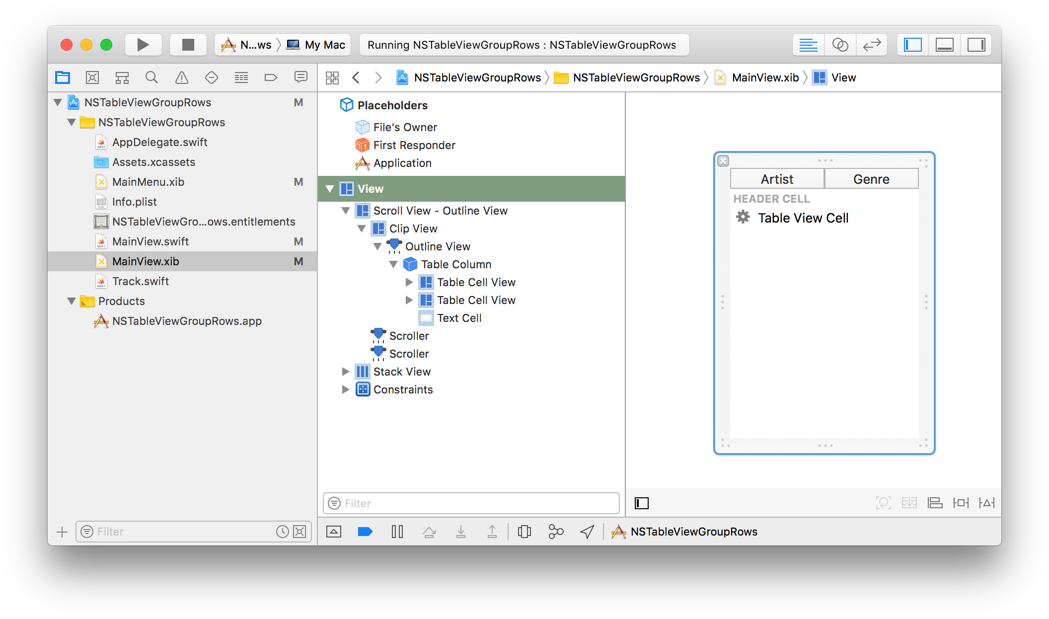

Also when you take a look at my OutlineView example you can maybe also have a look at the difference of CPU and memory when enabling/disabling CALayer of the Views. When enabled, the CPU goes down while scrolling, but memory goes up because the cells are cached as an image file with CALayer enabled (at least that's how I read it).
Kudos on doing the research ! This is exactly the kind of input I could use, because I don't have the time or patience to do it myself (remember my #1 and #2 priorities
). So, it is great that you are researching these things and providing input that can be applied to Aural. Keep it up.
BTW, about your outline view example app, can you please upload a GIF demo. I'm not able to run your code (old XCode and Swift v), and just looking at the code is not going to give me any idea how it works. Post a 30 second GIF clip demonstrating what it does. Keep the CPU/memory monitor (in XCode) open so I can see how your app impacts those parameters.
1- main window is closer to the left screen edge than the width of the playlist
2- playlist gets moved first with restricted alignment to the screen
3- so now, since the playlist is wider both windows overlap
4- and only now the main window moves away from the edge (playlist window moves along with the main window)
Actually, point #2 is incorrect. The playlist, when it moves initially, is not restricted in any way (I just revisited the code, in addition to testing it 10 more times). It goes wherever it needs to go for the docking. Yes, playlist does move first, but it is unrestricted in its movement.
Then, if the playlist is off-screen, both windows move. BTW, you're also mistaken that the playlist moves along with the main window. Yes, it will visually move, but the underlying frame does not move. I spent hours on this problem, till I realized that moving only the main window will also move the playlist window visually, but the playlist frame stayed where it was. At first, I didn't understand this behavior at all. If the playlist moves visually, its underlying frame should also move, but for some reason, it doesn't.
Maybe, somehow, this was a bug on Sierra, and I compensated for it in my code. Then, Apple fixed it in High Sierra (so the underlying frame moves with the window), and so you're now seeing the extra playlist movement causing the overlap ?
I guess I will have to change how the code is written, after all. Currently, I'm using affine transformations, which was a big mistake. I should be using absolute locations, like I was before.
