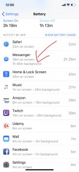

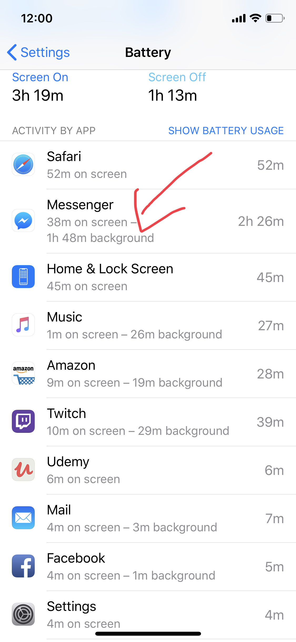

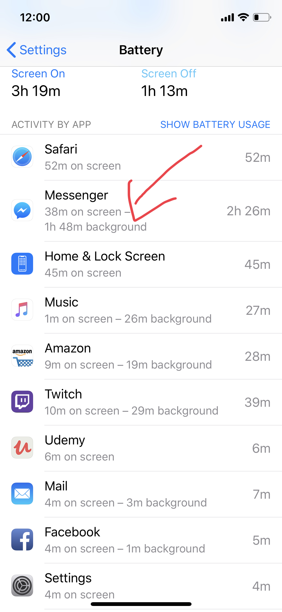

Only thing I noticed which might cause the issue is how long the facebook messenger app stays on in background (although in background app refresh it is disabled? )
Please see the screenshot, it says 1h48m in background and battery usage: 2h26m
Maybe I'm wrong, that is why I am posting here. What could be the issue? Can someone please help?

Looks like Messenger is the culprit. Do you force kill that app at night? If yes and it continues to run in the background I’d delete the app and reinstall it to see if it goes away..
Reactions: eyoungren
^^^Pretty much this. Kill the app before going to bed.
Messenger is probably checking for messages excessively, causing the phone to wake up and the battery to drain.

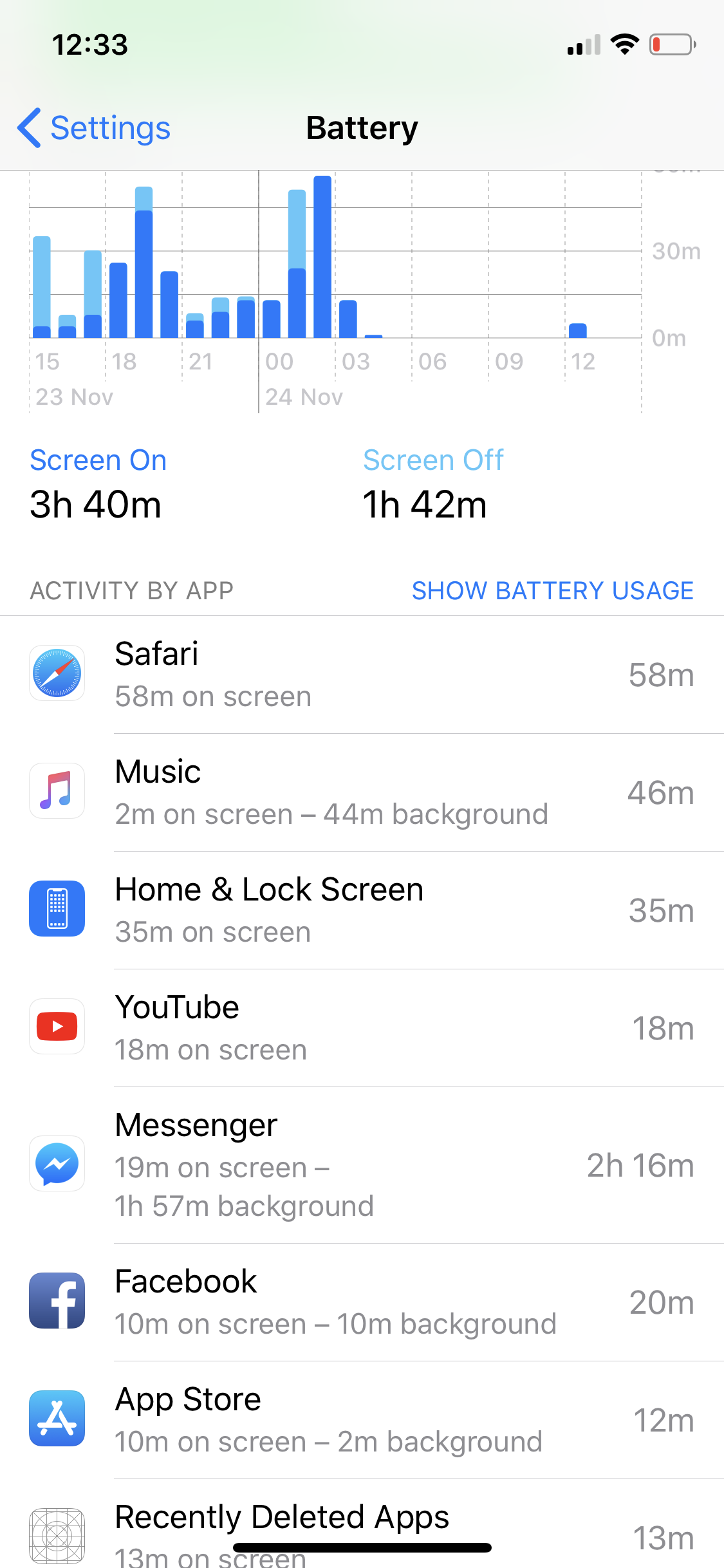

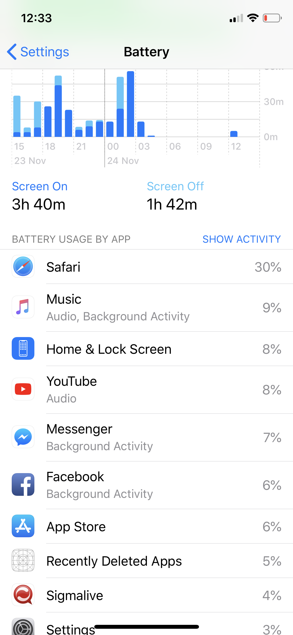

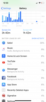

If let’s say hypothetically there’s an app causing the battery drain. It should have been displayed in battery stats right? (In screenshot I posted) showing that it drains significant amount of battery. Or is there a possibility for an app to drain battery (either because of faulty settings or not very well optimized) but not appear in the battery usage stats?
Thank you

Do the math....take the battery standby time estimates from Apple and portion it for 8 hours worth. But this time instead of having it mixed in with you’re usage. Charge to 100 then go to sleep off the charger and see what it is in the morning
