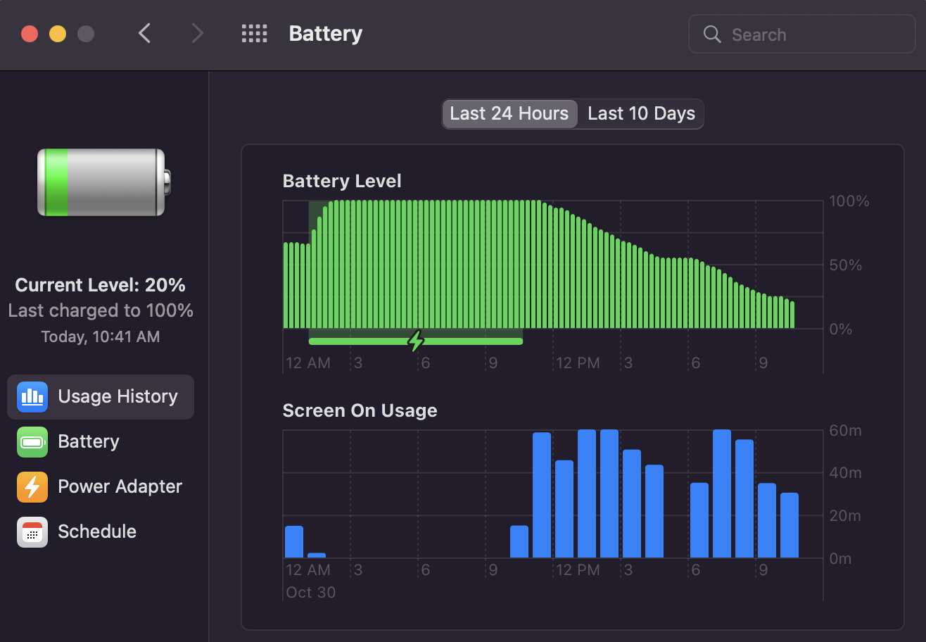

Fairly normal use on a 16 Max, 32 gpu, with 64GB. Had a Win11 VM running under Parallels, importing and editing a few photos in Lightroom, email, YouTube running sometimes full screen and sometimes PIP, Time Machine going in the background, and a short hour break in between.
At this rate, it would have run for 14-16 hrs on battery depending on what I was doing for the remainder of the day. For all intents, this is an all day laptop for this kind of stuff... probably 4-8 hrs of runtime for the video folks doing edits. Maybe less if you're running Premiere vs FCP.
