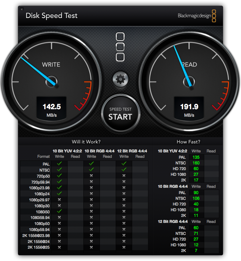

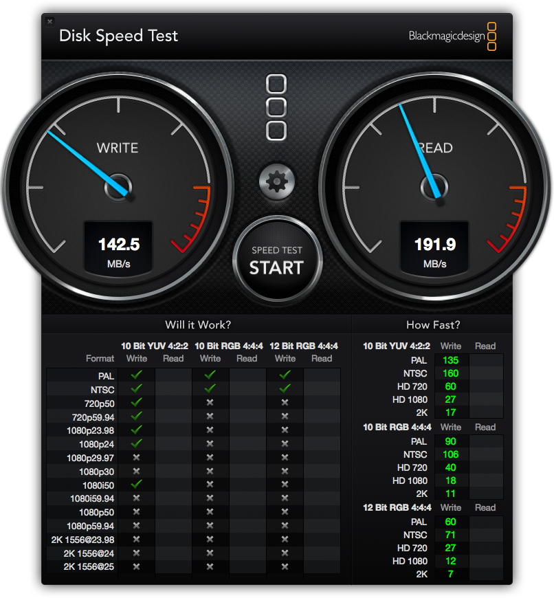

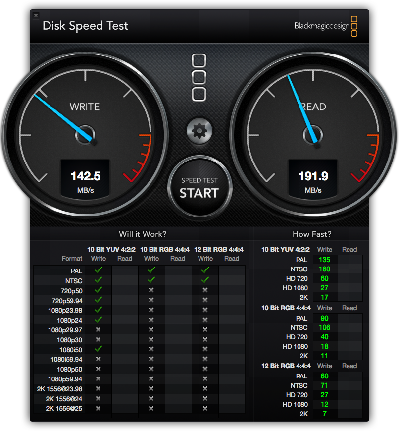

I just ran a BlackMagic speed test on the Qx2 with 4GB test file size (older 1TB drives installed):
(eSATA interface with CalDigit FASTA-6GU3 eSATA/USB3 PCIe card in Mac Pro 5,1)
-howard

Just curious! the posted speed is SPAN mode right?
FW2
No ... that was in RAID-5 mode.
I was expecting somewhat faster speeds from RAID-5 here. I wonder if it is my older technology disks, or the eSATA interface card I am using.
-howard
