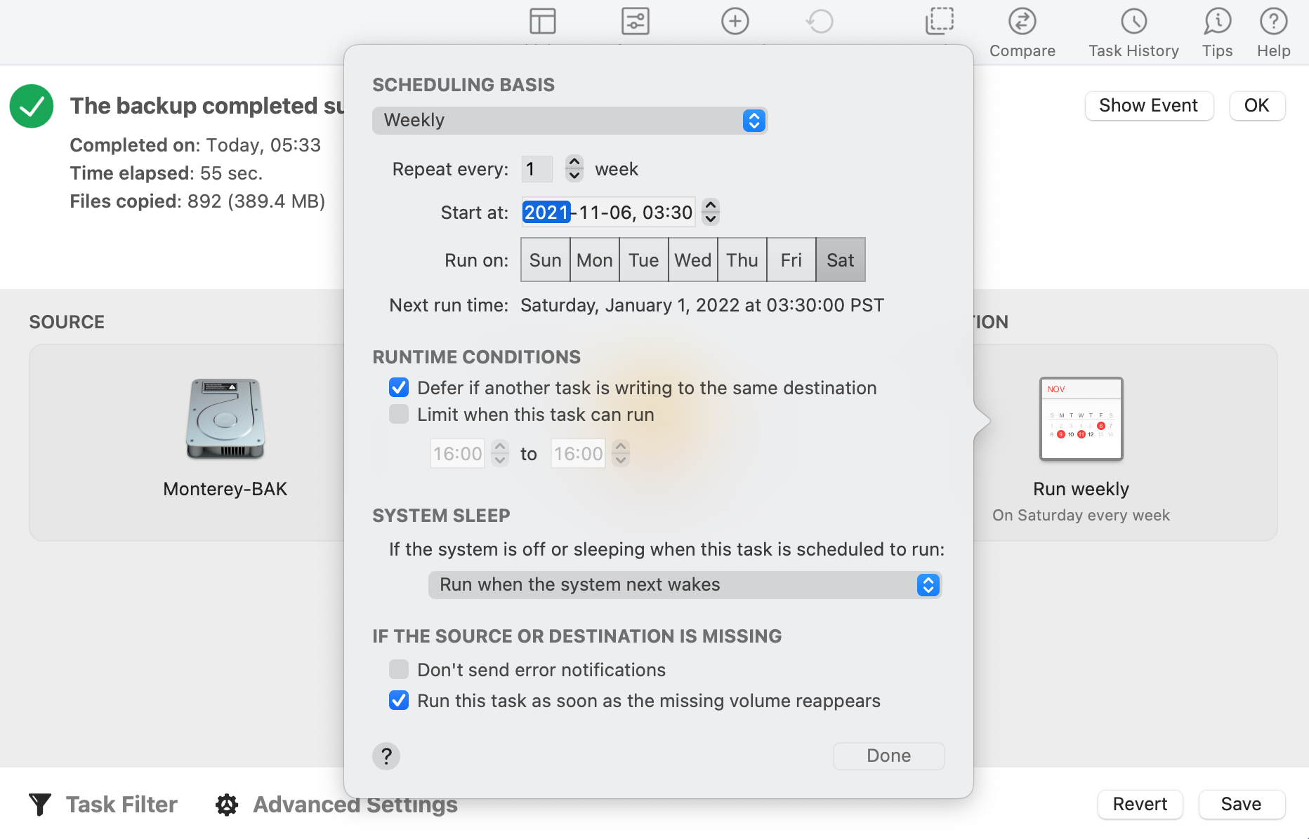

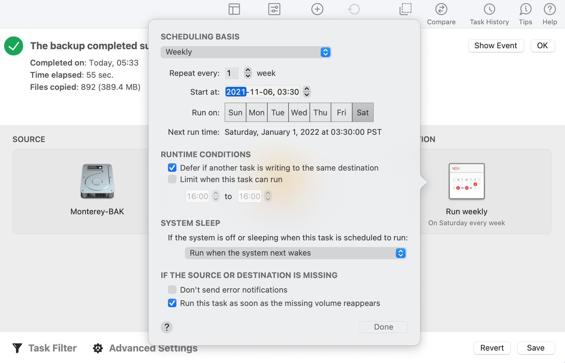

FWIW here is a screen shot of my Monterey Clone settings
