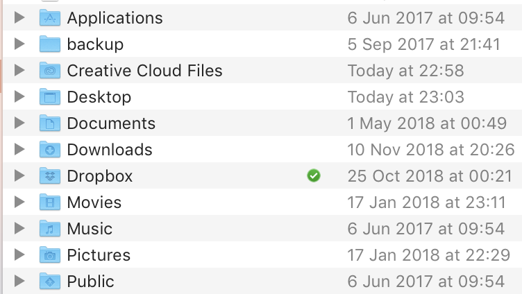

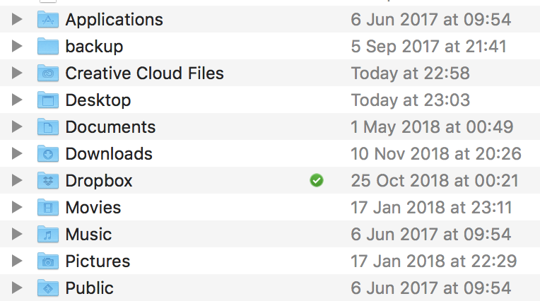

This is out of left field, but was "Use LCD font smoothing when available" checked under the mini's General settings?
Hmmm...I don't know. Maybe not. That was the one thing I didn't look at...
EDIT: Well on my 4K iMac running High Sierra, turning OFF font smoothing actually makes the fonts even thinner (and nicer actually!). See below. Please note that font smoothing isn't actually off. If you use accessibility zoom, the fonts are clearly still anti-aliased.
One confouding issue here is that I purposely turned back ON subpixel font smoothing (via terminal) in High Sierra a while ago because I noticed that the rendering was not as nice as in Sierra (even on a retina display). So now I'm not sure what Apple thinks the default should be like. I actually now quite like with the preferences pane for smoothing off (but I did also turn on subpixel smoothing, but not sure if that setting has any effect now). The fonts are light and crisp.
However, I don't know how any of this relates to the LG monitor I tested in Apple Store running Mojave though...
Images: With LCD smoothing:
Without LCD smoothing:
