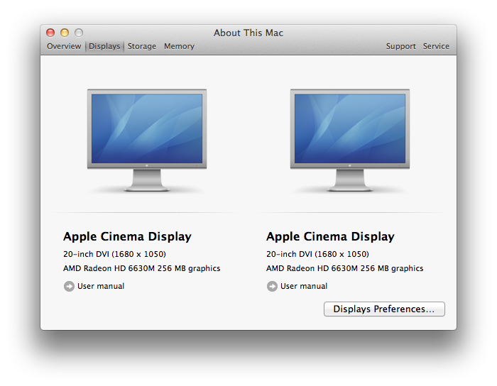

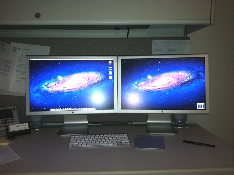

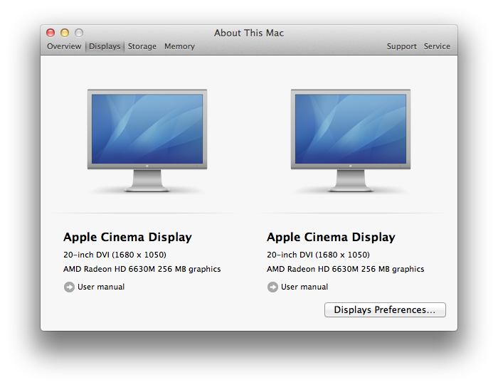

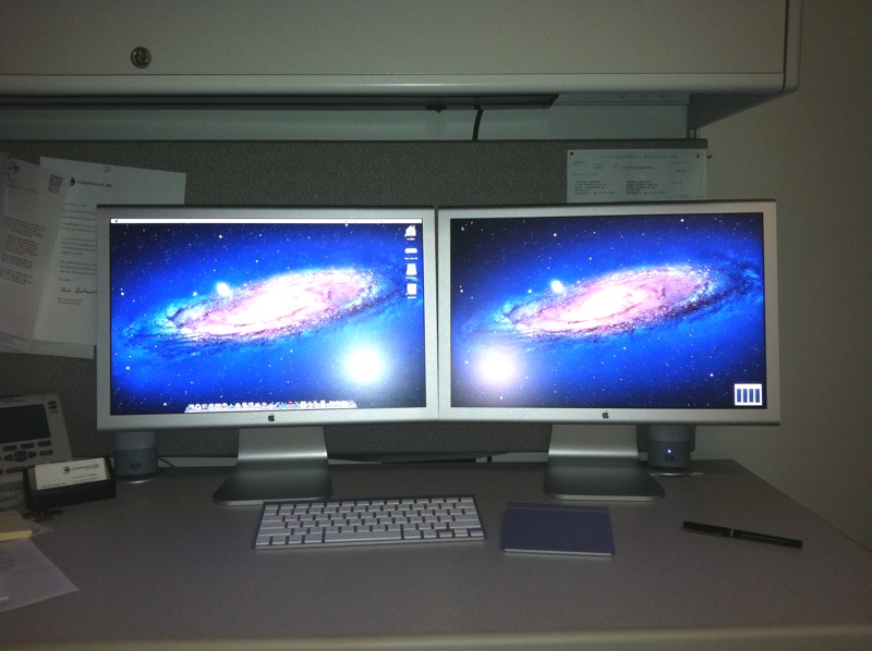

My current setup in the office at work (2011 Mac mini)
Nice monitor choice ;)
