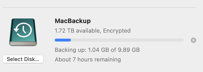

I keep getting backups like this:
Again, a 9GB backup and it is taking forever!
Not sure if something it wrong.

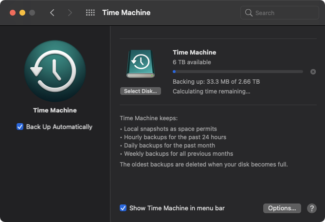

I just completely remove one of my old TM backup, formatted the drive to APFS, and try APFS TM backup. Surprisingly, it's much faster than I expect.
The total backup size is 2.66TB, which usually take more than a day for the initial backup to complete.

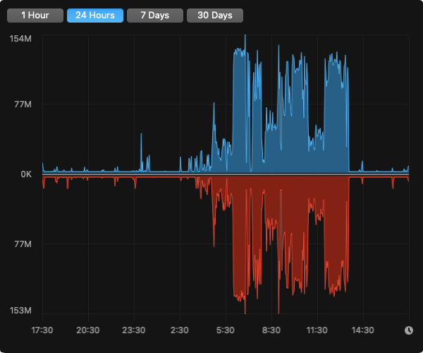

But this time, it only took ~10 hours to complete (start at about 3:30am, and finished at about 1:30pm. The asymmetrical activities before 3:30am are for something else, I haven't start the backup yet). And this is the disks' usages during that period.
2.66TB for 10 hours, the average speed is ~77.5MB/s, which fits the graph quite well.
The source drives are one SATA SSD (MX500 2TB, contain Big Sur, many uses data, mainly small files) + one HDD (WD Red 4TB, use data only, mainly contain videos + photos).
The TM drive is a SATA connected HDD (WD Wed 6TB).
Of course, there are two variables here (macOS, and TM drive file system). It can be because Big Sur Time Machine is faster. However, I think this is at least good enough to prove Big Sur + APFS TM backup won't be slower than before. Or there will be any significant slow down if we use APFS for the backup drive.
For those having slow backup issue, that should because of something else (e.g. network speed).

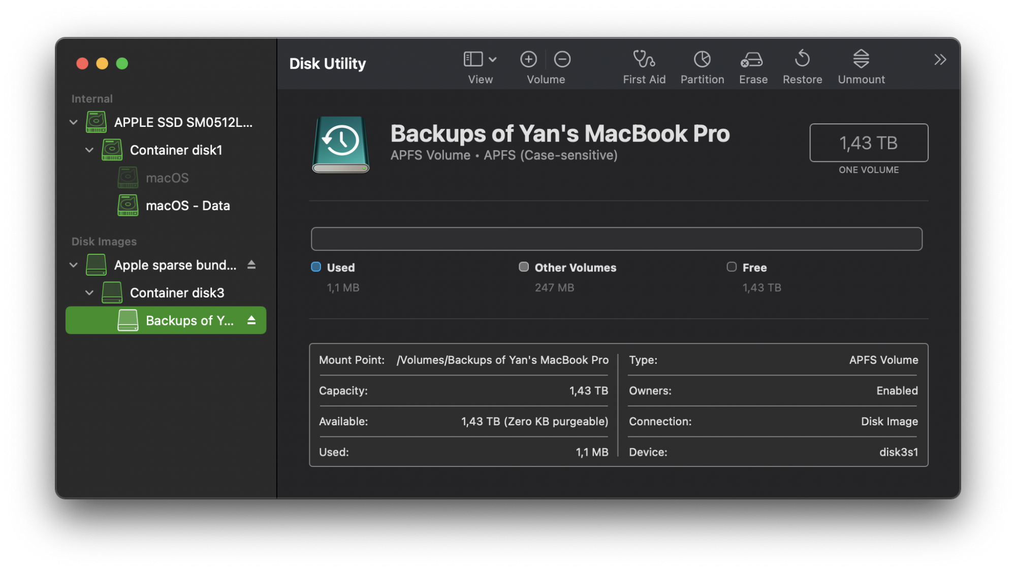

I can't find the post now, but I read where APFS does work with a TC. The TC drive is still formatted HFS+ like it always was, but the sparse bundle file used by TM is formatted to APFS with Bug Sur.
Edit: Here it is.
That doesn’t really change much in Big Sur, except that the sparsebundle is now APFS-formatted, and, when you open it, it acts the same way a local backup disk does. Our speed testing also showed improvements over the old HFS+ version of Time Machine when using a networked volume, though it was admittedly more modest than when using a local disk.

There's no need for APFS support on the Time Capsule itself. Time Machine mounts a disk image from the Time Capsule, so the disk format on the Time Capsule itself is irrelevant. I made a new backup on my Time Capsule to test, and the disk image is stored on the HFS+ disk of the Time Capsule but the format of the disk image itself is indeed APFS.

Yes, that's how it works. When you connect a disk over a network, the client system has no knowledge of the format of the drive on the server.
The disk in the Time Capsule will always be formatted HFS+. That has not and will never change (especially now that the Time Capsule is long discontinued)
What did change is the filesystem inside the sprasebundle that MacOS created to do backups to. THAT filesystem is now APFS with Big Sur. However, the sparsebundle itself is still sitting on an HFS+ formatted disk in the Time Capsule.
Think of it as a hierarchy:
- Time capsule
-- HFS+ disk shared over the network
----- sparsebundle on that HFS+ disk
------ APFS filesystem inside the sparsebundle
---------Snapshot of your Mac date A
---------Snapshot of your Mac date B
etc...
The first two lines in that hierarchy have not changed.
Hell, right now I'm doing Time Machine backups (from Catalina) to an SMB share on my Linux server, to a ZFS dataset! It doesn't really matter what the underlying filesystem is that a sparsebundle is on. A sparsebundle is basically just a disk image that's split into hundreds of small segments (bands) to make it more friendly to backup systems.
I already tested Time Machine from my Big Sur laptop to that same server and it works great. The irony is that it's using a copy on write filesystem (APFS) inside a disk image that's stored on another copy on write filesystem (ZFS).
