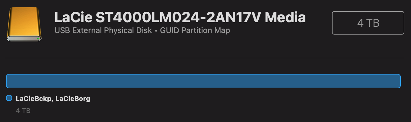

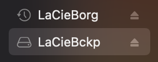

I just bought a LaCie 4TB drive to use as my TM drive and finally got an AFPS TimeMachine. WOW this is amazing. So cool! I love how I can create a partition that shares the space with the TM partition. Just amazing.
I manually copied my Parallels instance to the TM drive (am doing this right now). <shrug> just what I've always done with Parallels.
Either this LaCie drive is insanely fast or it backed up my 300GB MacBook in the fastest time I've ever experienced.... I'm pretty happy with this.

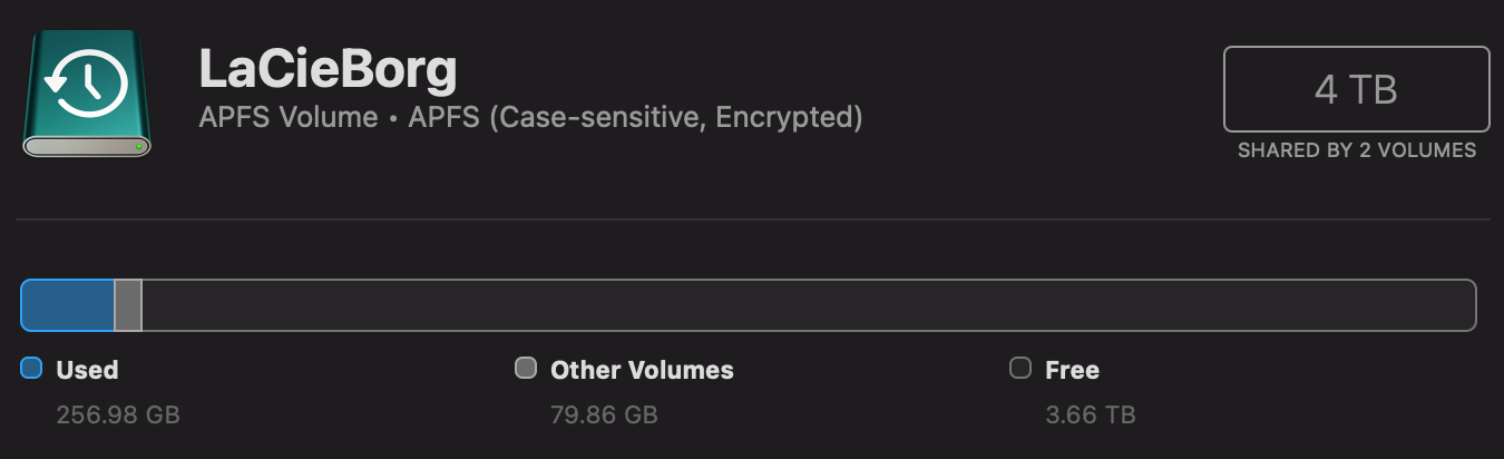

I did the same as you and mine also now shows case-sensitive. I am positive I selected only APFS Encrypted when I formatted, so TM must have switched it to case-sensitive.
I am actually noticing pretty good speed increase with TM compared to HFS+.
Same thing happened to me. I intentionally did APFS Encrypted and it switched it to APFS case-sensitive encrypted. Also noticing a massive difference in speed - the first backup especially!
Reactions: Weaselboy

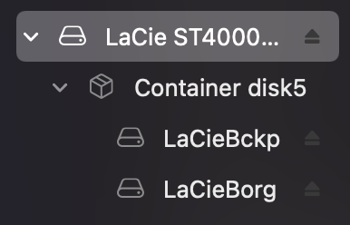

in disk utility.
Time Machine partition ^

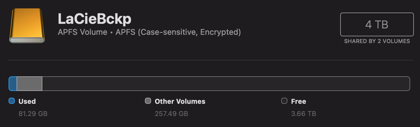

And a backup partition I can copy/paste data to (like my Parallels partition).

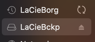

And in finder:

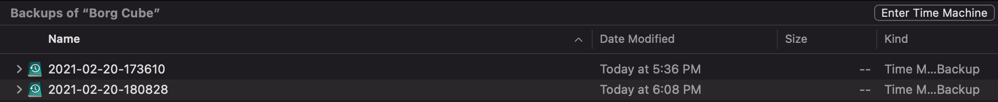

and what it looks like when doing a backup (in finder):
The first volume won't let me store anything in it but the second volume shares the space on the disk with the Time Machine partition.
What the Time Machine partition looks like in finder:

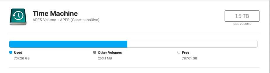

I had another External HD I had used on a MBP that I didn't need TM to backup any more. It is partitioned (1.5gb; .5gb) The 1.5gb I designated for the TM.
Does Big Sur not count "down" the TM backup now? I started the backup and it said "10gb backing up" and then went to "cleaning up" after about 10 minutes.
And, it is still "cleaning up" (for about ten minutes and counting). But I didn't see anything indicating anything happened. Yet. Is this normal?
I also discovered that when I wiped the 1.5gb of the 2TB on the External that is partitioned, it automatically created the APFS. (see below). So, I assume that was a good thing?
