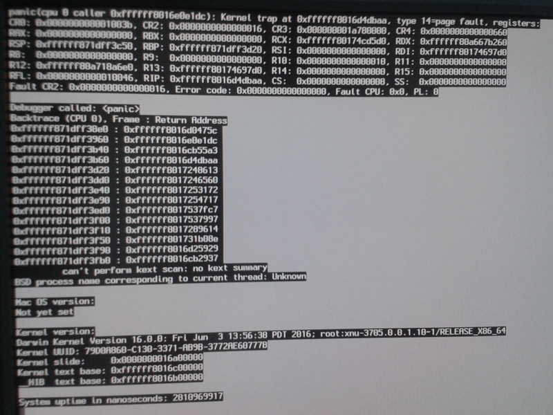

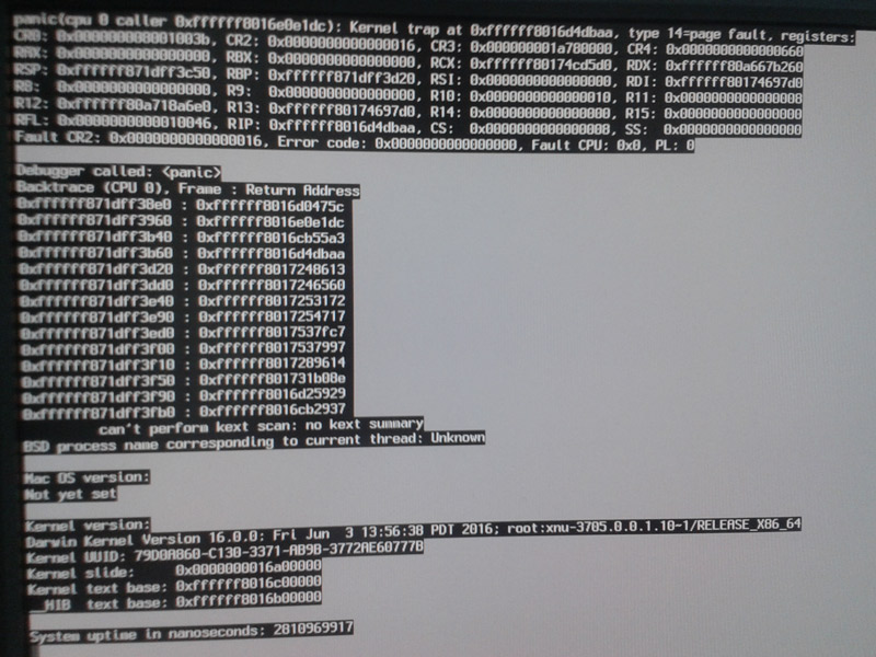

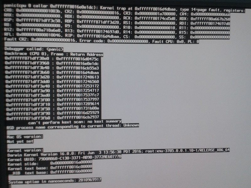

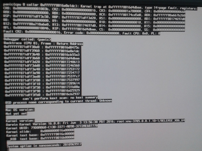

So Sierra DP has come and Pike started to work on a Sierra-compatible branch of boot.efi:
https://forums.macrumors.com/thread...1-2-1-and-macos-sierra.1977271/#post-23011268
I compiled latest commit (162fe51) and result is exactly that same as with latest El Capitan boot.efi version.
KP.
Screenshot attached.
Reactions: nounousomes
using the latest update (time 11PM my time) there I got deeper into the boot sequence but it still panics on the upside it does find root device and since im booting from a USB iPod this does indicate USB should still work on the Mac Pro 1,1/2,1 :) attached is a panic log (in this boot i tried safe mode the panic was slightly different in normal mode but it panicked at the same place but i dont have time to go grab that sadly) forgot to mention this was booting the installer.
hope this helps
