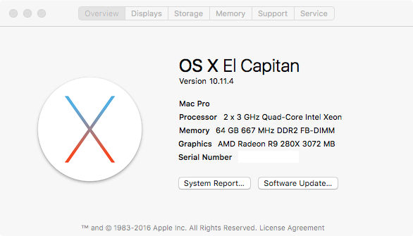

+1 here (actually it's branded R9/280X, but since the EFI part comes from a 7950 it's identified as such)

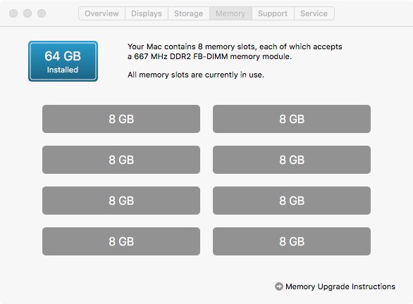

FYI - I have installed 64 GB in what was originally a 1,1 updated to a 2,1. Everything works.
Sorry but how did you manage to update from 1.1 to 2.1 and to make it recognaize the graphic card. Can you please explain it to me.
Got the same machine and card, just 32gb of RAM in it. But do not recognaize the processor either (i upgrade them a few months ago)
