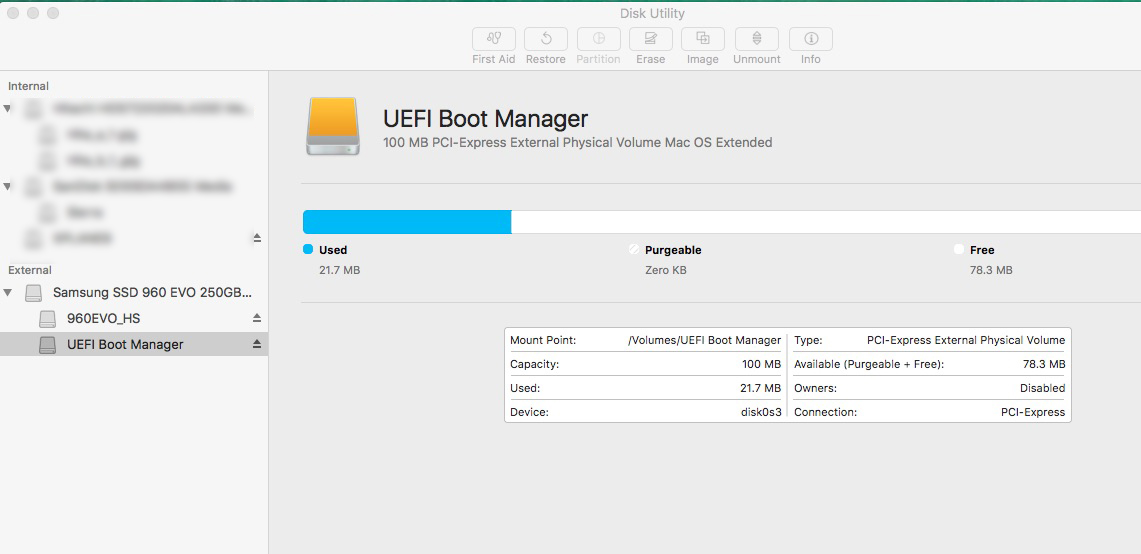

Tonight after work I'll try the second mode install method with my Samsung 960 EVO NVMe M.2 drive.
I've already created the 100mb partition on the 960 EVO.
Up until today I've been booting the 960 EVO as a Fusion drive with USB 3.o memory stick.

NOTE : Sierra 10.12.6 in a 4,1> 5.1 cMP
My bootrom version is MP51.0085.B00.
SIP is enabled.
My HIS HD 7950 is EFI flashed

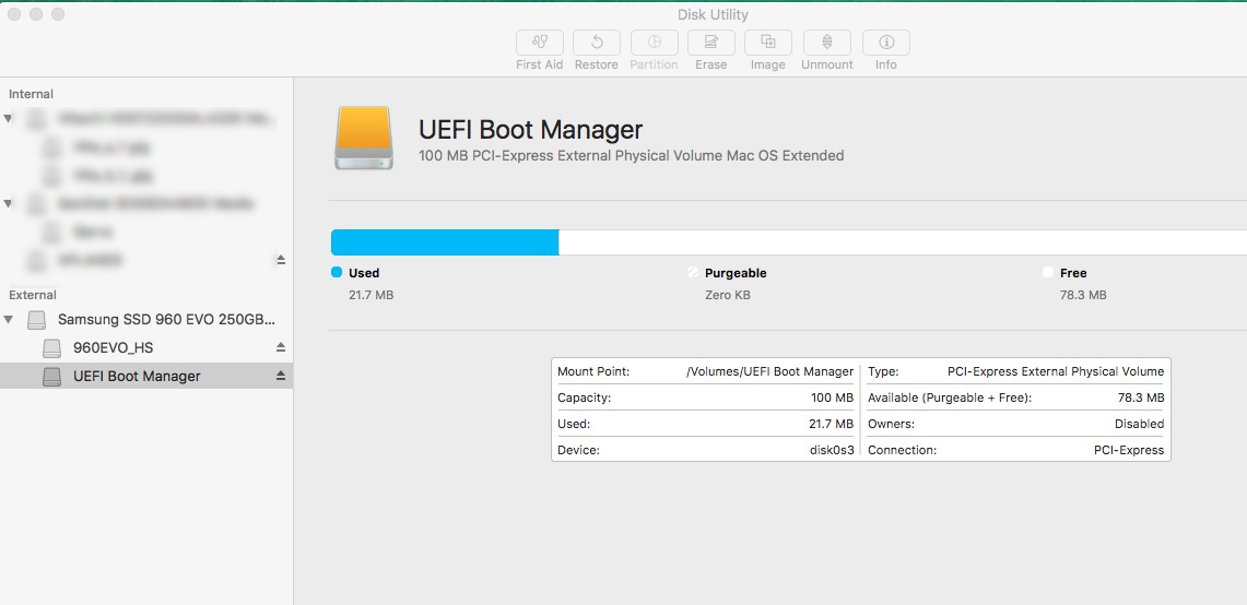

Created 100mb partition on my 960 EVO M.2 Named it " Boot"

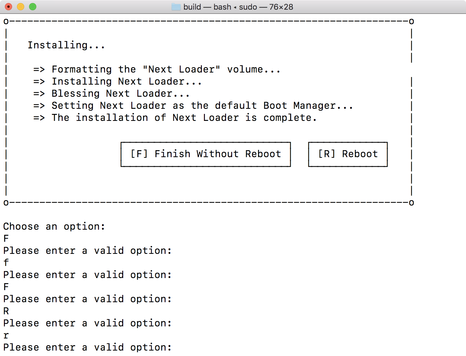

Installed the SECOND MODE option

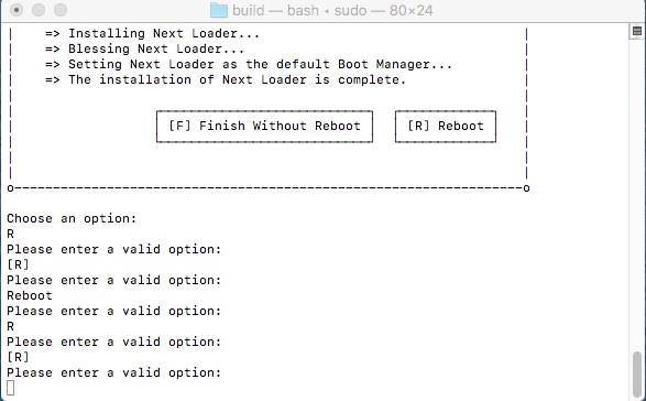

I could not complete the very last step. Could not enter " R ".
Tried many other variations as you can see from the Terminal grab
But the installer does say " The installation of Next Loader is complete. "

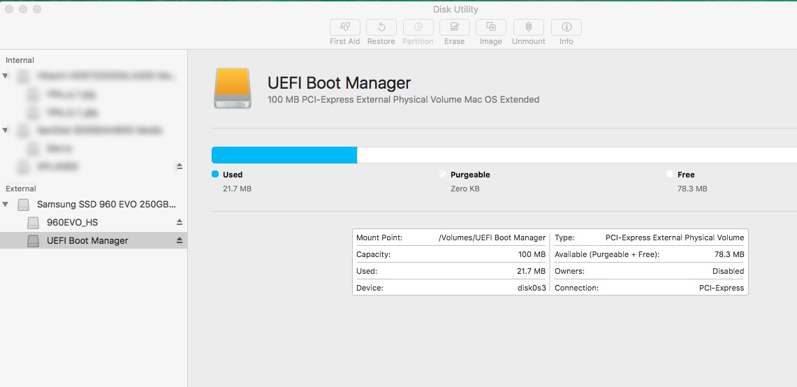

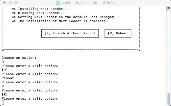

You must install Next Loader on a device that is bootable natively, not on the NVMe SSD. Any AHCI device works.
If you install Next Loader directly to the NVMe, the installer will bless it and try to boot from it, but since the Mac Pro does not have native NVMe drivers, it does not detect the SSD and displays the "?" icon.
While if you install Next Loader on a drive that is bootable, such as an internal HDD on the Mac Pro, the Mac Pro will be able to boot Next Loader and it will load the NVMe drivers and finally show you the option to boot your NVMe.
I just fixed the problem where the installer can't restart the Mac. Try downloading the installer again and replacing it with the previous one.
https://github.com/abdyfranco/next-loader/blob/master/build/install.sh
