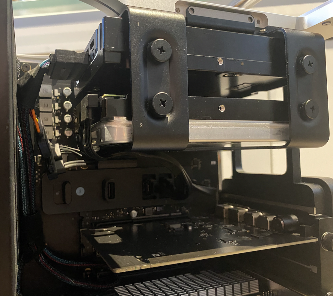

Any more updates on how this is working? Did you install the heat sink? Is it getting too hot without it? that is kind of tipping me over the edge on trying this solution otherwise.
It's working GREAT! *knocking wood* The drive is generally at 127F so frankly it's fine. That said I did order the heat sink and got it, I just need to get some thermal pads. If it goes down under 120F that will be nice, but either way, Im not sweating it.
This is, I think, the first time EVER that I've been able to put all my stuff on a single drive. I still have over 6TB free which is really great for scratch space. Super happy with the capacity and speed.
For those that need extreme speed (this does around 2.5-2.8GB/s in APFS Encrypted, and around 3.5GB/sec unencrypted) beyond this drive, there may be other form factors.
But I don't think anything competes with this on the extreme end. One could put 4 of these drives together on the Highpoitn card and have 60TB of SSD storage. Not clear if it will boot in a RAID (my guess is not but who knows until you try), but even if you make one drive your boot drive, and raid the other 3, you're going to have CRAZY speed and capacity.
I posted this in another thread, but a way cheaper solution to getting the Highpoint card, if you want only one drive, was noted in this thread:
All you need is a card like this, cheaper, way easier, no wires etc. required:
[EDIT] Sorry! I’ve just seen that the question was already answered above, but I do not know how to delete my post … [/EDIT]
Could I use this adaptor to install the Micron 9300 Pro 15.36 tb in an Mac Pro 7,1?
Thanks for your feedback!

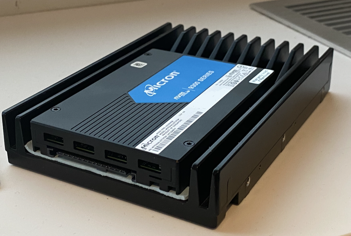

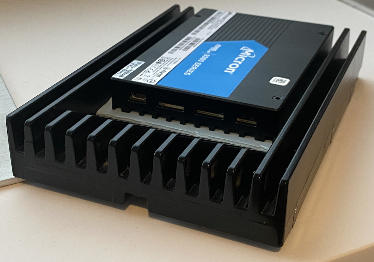

Ok so I got the heatsink for the old velociraptor. Thanks so much @tsialex.
So the old system would run somewhere between 136-144F when it was being very taxed (like indexing the drive), and mostly run at 136F at boot. It would then cool down to about 125-127F when it's being used normally but not battered.
With the new heatsink the absolute maximum temp I get is 122F when it's really being hit hard indexing. Most of the time it sits at 115F. So around a 10-20F lowering, which is great.
I got .5mm and 1.5mm thermal pads from here:
I cut the 1.5mm thermal pad to basically be the size of the entire drive. The Velociroaptor heat sink has 2 20mm square upward protrusions to help dissipate the heat, so I cut squares out of the 1.5mm pad to let those protrude through. Then I cut two 20x20m squares of the .5mm thermal pads to sit atop those protrusions (and holes out by the screws). That way all the thermal pads sat flush. Screwed it in snug to hopefully get a little compression of the thermal pads and I was done. I didn't use any thermal paste or other things. I'm sure you could drive down the temps even more if you want to get fancy, but we are now at a very comfortable temp range, so that's good enough.
A few shots of what it looks like now.
