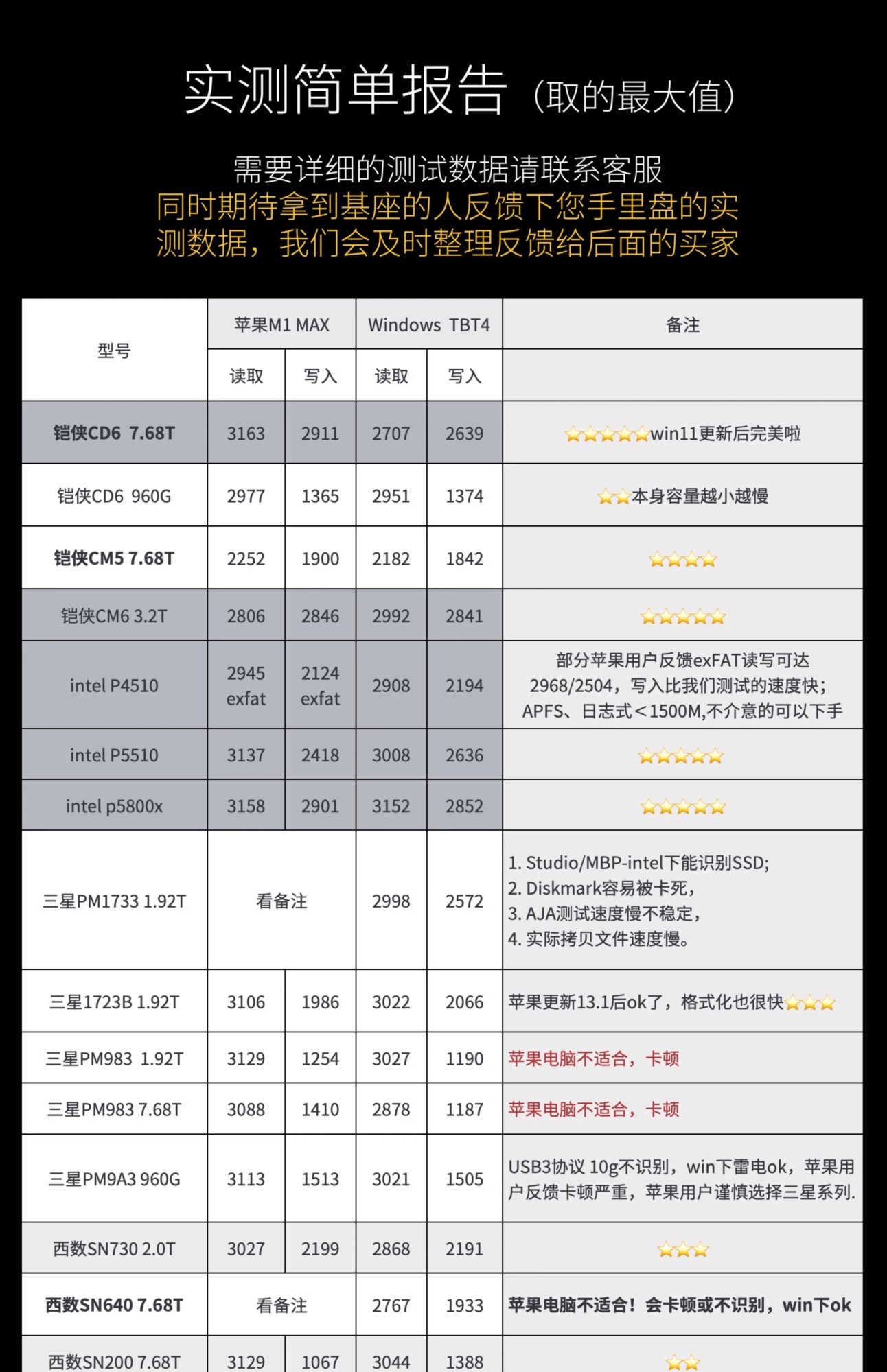

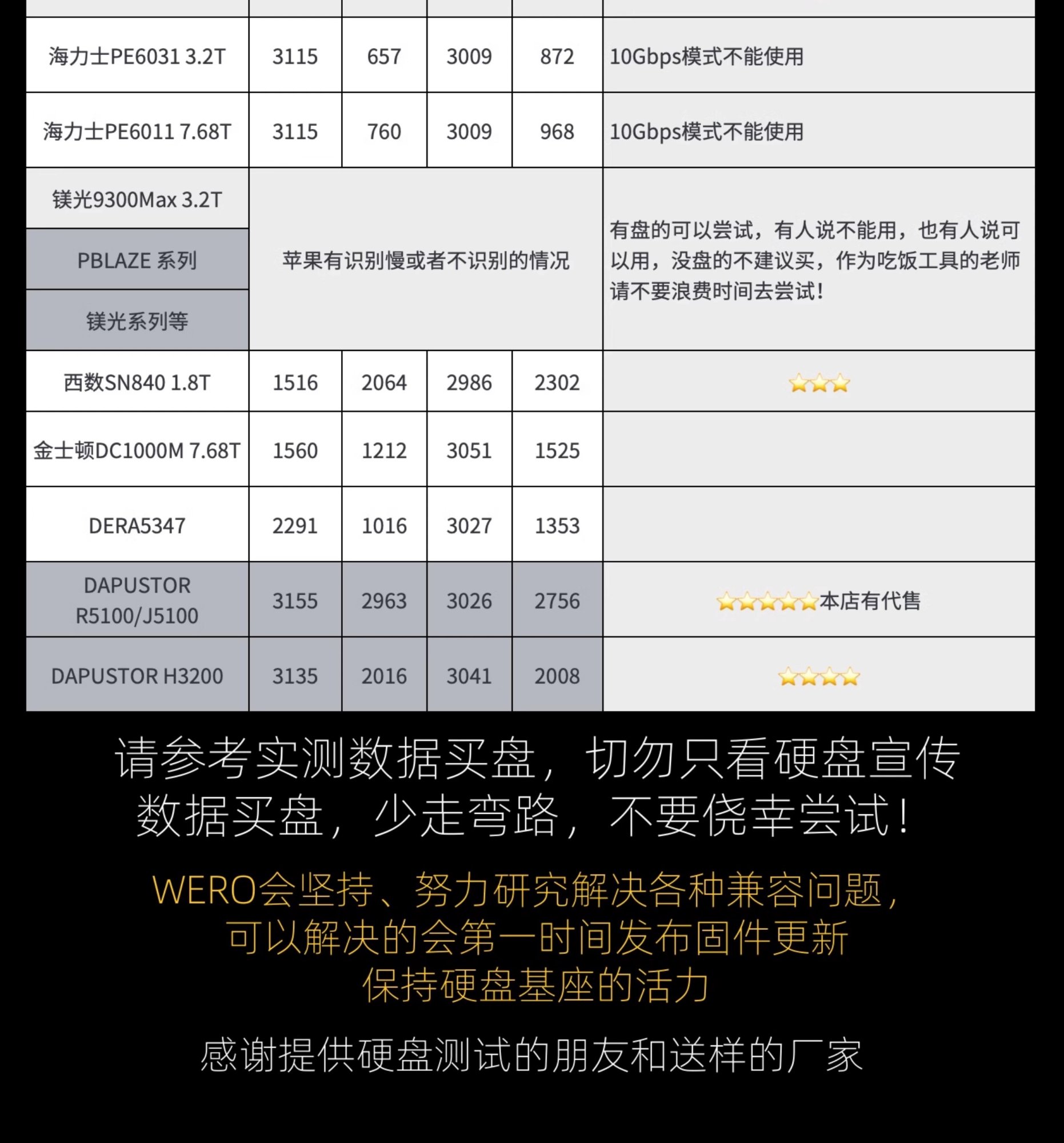

This is the compatibility list including the speed and known issue. It's not all the information they have. If you want to know if a specific U2 drive is fully supported, I can help you ask them.
View attachment 2365041View attachment 2365042
That would be amazing. Basically curious of what are the 30TB and larger U.2/U.3/EDSFF drives that are compatible at full speed. Thank you, and them, so much!
Jumping on this thread a little late. The Chinese list shows read/write speeds for the Samsung PM983 7.68T U.2 drive in the macOS column implying the drive works in macOS but the red Chinese text in the last column seems to say it is not compatible, per Google translate. Would appreciate any clarification or guidance. I have some Kioxia CM-5R U.2 SSD's working in an OWC Gemini Thunderbolt enclosure but the Samsung PM983 do not work. The drive unmounts after a few seconds of being powered on.

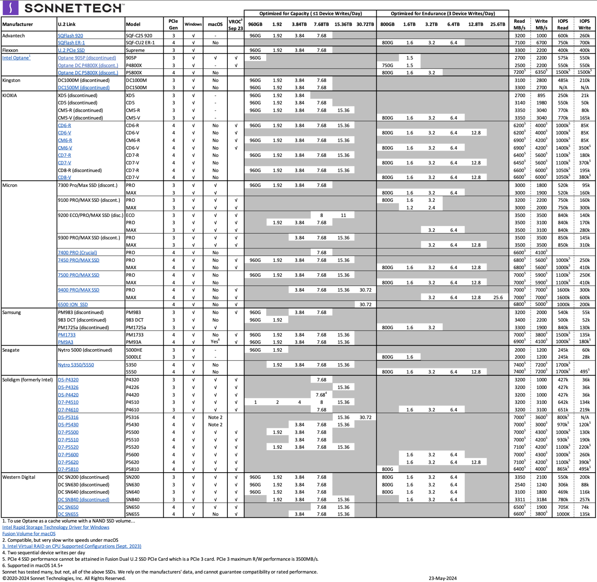

May 22 update of the Sonnet chart. I think they may be reading this thread as they noted the slow write speed on the Solidigm D5-P5316. Although they also noted it for the P5430.
If they are reading, I wish they might consider expanding their chart to include 61TB drives and in particular, these two drives: SOLIDIGM D5-P5336 Series (30.72TB, 2.5”) SBFPF2BV307T001, and SOLIDIGM D5-P5336 Series (61.44TB, 2.5”) SBFPF2BV614T001.
It means that Samsung PM983 can be identified in MacOS but it is unstable(some drives are even worse and they cannot be detected at all like Micron 9400pro). Overall it shows PM983 is not usable on MacOS unless Apple changes its U2 SSD driver in future update. If you have any detailed question, I can help you ask them directly.
