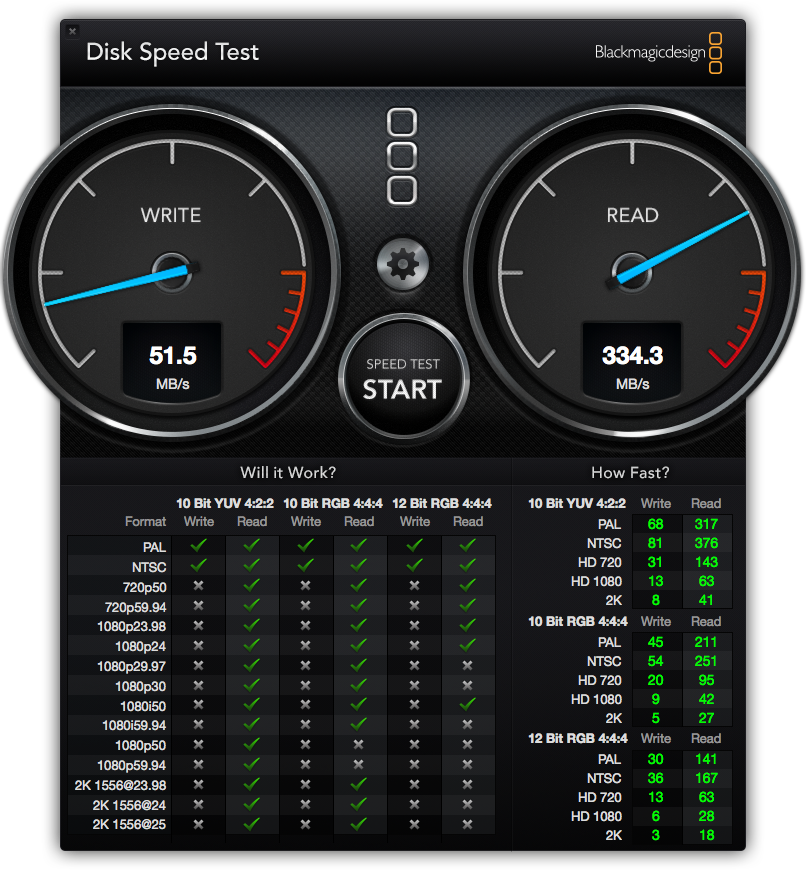

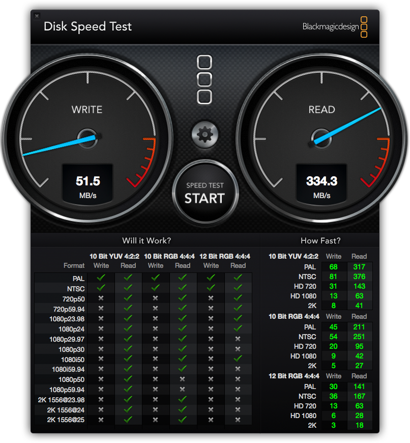

DIY FD blackmagic slow write speed?
Hi, I created succesfuly DIY FD using internal 1TB HDD and external LaCie TB 120GB Rugged SSD (I know external storage is not officialy supported). Using OS 10.9, FD created on same version.
Everything is fine and running (recovery hd and bootcamp partitions stayed untouched, complete recovery of TM backup 450GB).
System is lot faster - booting with 5 desktops and lot apps under 30 s, Adobe LR, PS around 5s.
I have only one problem with results of Blackmagic benchmark - write is inbetween 50-100 MB/s and read inbetween 200-380 MB/s (see the screenshot). Quite a bit span in results, sometimes faster sometimes slower (once I measured write 270 MB/s). What I am concerned about are write speed, because when I copy 2 GB file on FD it shows on SSD 200 MB/s and more using iostat.
Dont know if it is just problem with my benchmark or FD is really slow, what does not seem regarding the practical use experience.

KOSITCH - Any resolution? I'm experiencing same thing. All feels ok, but my Black Magic benches are in exactly same ballpark.
Makes me wonder if I should keep using the DIY fusion (since its working well) or try to separate and go boot drive SSD & Internal HDD for all else.
I had the same setup (DIY FD with Lacie Rugged 120 and internal HD).
I had the same bad results.
The problem comes from the Sandisk U100 SSD that is built into le Lacie enclosure.
It has really very bad perfs in writing when the disk is almost full.
I hyave replaced it into the enclosure by a 840EVO 256Go and now I have very good performance.

Rbart, funny thing is I have the Samsung 840 Pro 256gb from the start. I'm wondering if my issue is that it is connected USB 3 and even though it is still new, maybe lack of TRIM is killing it. I previously had speeds of 250 write / 500 read, so it definitely slowed down. Maybe Black Magic just can't bench the DIY Fusions very well.
