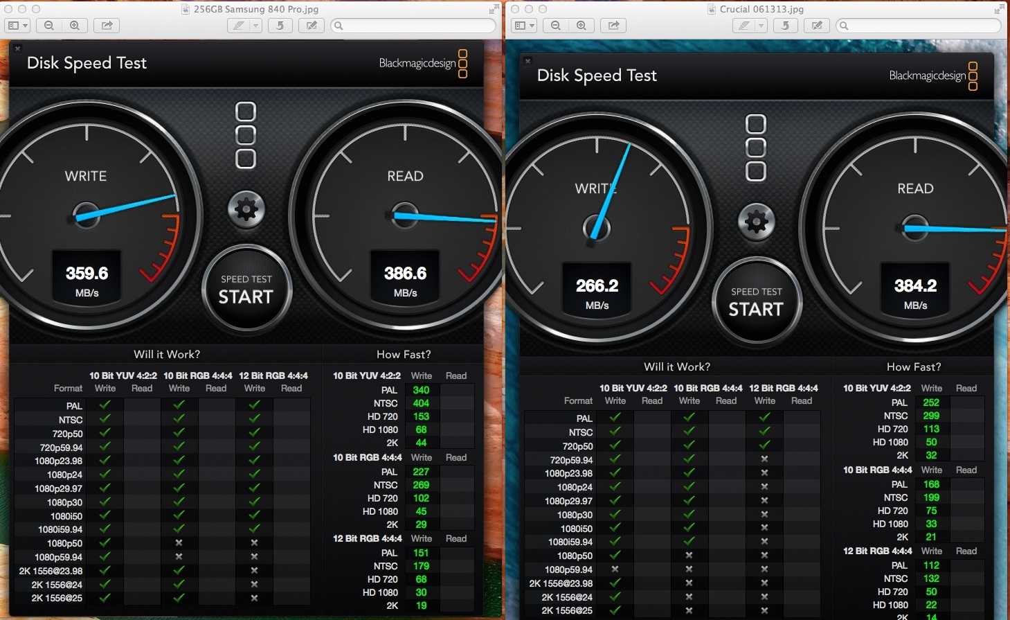

Crucial vs Samsung
Both 256GB installed as Thunderbolt connected external primary drive. Everything else identical. Groth's TRIM enabled on both drives. Crucial M4 on right; Samsung 840 Pro on left.
Note that READ speeds almost identical, but WRITE speeds considerably faster on the Samsung.
