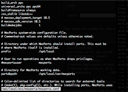

3. Assuming you have BBEdit installed,
Code:
bbedit /opt/local/etc/macports/macports.conf
That opens the config file, add the following lines, save the file:
Code:
build_arch ppc
universal_archs ppc ppc64
buildfromsource always
cxx_stdlib libstdc++
# macosx_deployment_target 10.5
# macosx_sdk_version 10.5
buildmakejobs           /NUMBER OF CPU CORES/
Last two lines are commented on purpose, you don't need them active normally, but they may happen to be useful occasionally (of course, then you uncomment them temporarily).

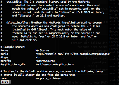

4. Then open this file:
Code:
bbedit /opt/local/etc/macports/archive_sites.conf
Uncomment the last line, so that you have:
Code:
name                    macports_archives

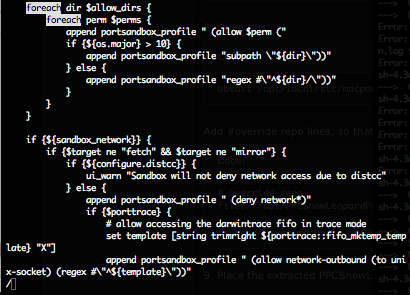

5. Open sandbox config:
Code:
bbedit /opt/local/libexec/macports/lib/port1.0/portsandbox.tcl
Replace one line (in fact, just a number), save the file:

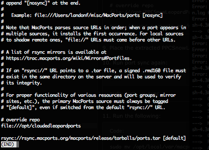

8. Open this:
Code:
bbedit /opt/local/etc/macports/sources.conf
Add #override repo lines, so that in the bottom you have:
Code:
# override repo
file:///opt/PPCSnowLeopardPorts
rsync://rsync.macports.org/macports/release/tarballs/ports.tar [default]

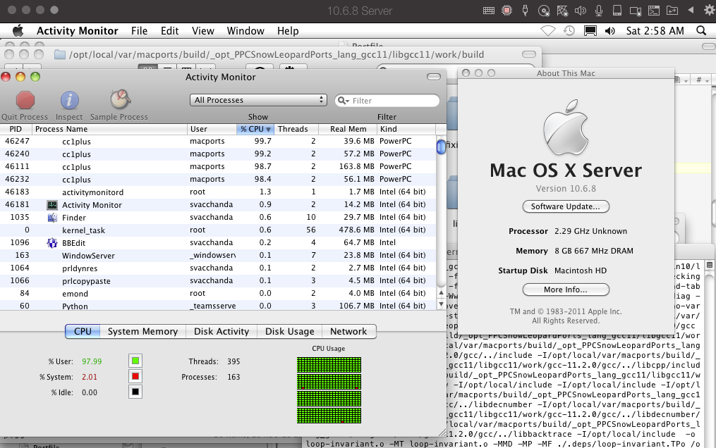

Oh wow, this is all in a VM? What is your VM setup?
I have 10.6.8 Server installed in Parallels Desktop. I did that because iOS 15 update broke Hotspot, and I cannot get internet connection on 10.6.8 installed normally. In turn, Parallels does not allow 10.6.8 client.
Code:
Code:
build_arch ppc
Code:
Code:
Code:

8. Open this:
Code:
Code:
# override repo

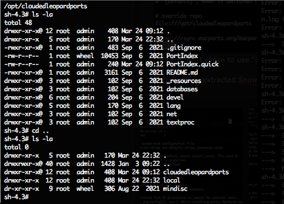

Next, step 8: I modified /opt/local/etc/macports/sources.conf and, step 9, I moved the contents of the PPCSnowLeopardPorts into its new home:
Code:
sh-4.3# vi /opt/local/etc/macports/sources.conf
sh-4.3# mv /Users/nope/Desktop/cloudedleopardports /opt/
With step 10, I ran port -v sync again:
Code:
sh-4.3# cd cloudedleopardports/
sh-4.3# port -v sync
--->  Updating the ports tree
Synchronizing local ports tree from file:///opt/cloudedleopardports
Creating port index in /opt/cloudedleopardports

It looks like sandbox setting was missed:
Code:
sandbox_init: Could not set default launchd policy, err=1100
This file: bbedit /opt/local/libexec/macports/lib/port1.0/portsandbox.tcl

Add lines to “macports.conf”
(on my first try, I left the last part of the paste as “buildmakejobs /NUMBER OF CPU CORES/” without inserting number of cores)
Step 4. Uncomment last line in “archive_sites.conf”
Step 5. Change “9” to ”10” on “portsandbox.tcl”

Step 8. Add override repo line to “sources.conf”
(remember: I chose to use “cloudedleopardports”, but the contents came from the “PPCSnowLeopardPorts-main.zip” attached in the wikipost)
Step 9. Place extracted “SnowLeopardPorts-main.zip” into “/opt”

I am compiling a huge port now, mpich-gcc11, so Quad is at 100% per core for a couple of hours. Should be done soon, I then bootstrap another Macports using Kencu’s overlay repo and document every step. After that hopefully works, I encourage to move to my version of overlay repo, but stay on gcc7 at the beginning.
It works beautifully on 10A190 in fact (I cannot say the same about 10.6.8 Rosetta, sadly: it works, but it is substantially more painful and got many silly errors – but fixable – even on basic ports.)

Modify macports.conf
Code:
build_arch ppc
buildmakejobs 4
Modify archive_site.conf
Code:
Modify portsandbox.tcl
Code:
    foreach dir $allow_dirs {
        foreach perm $perms {
            append portsandbox_profile " (allow $perm ("
            if {${os.major} > 10} {
                append portsandbox_profile "subpath \"${dir}\"))"
            } else {
                append portsandbox_profile "regex #\"^${dir}/\"))"

Code:
file:///opt/PPCSnowLeopardPorts-Legacy
Sync again
