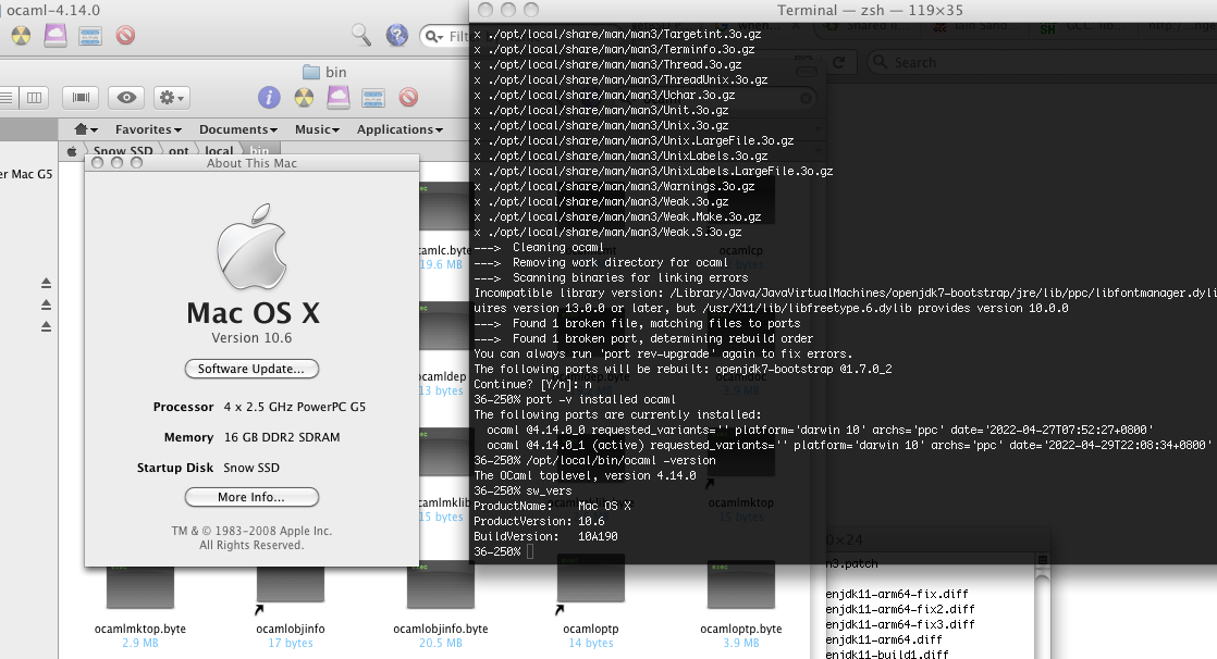

This is still WIP stage, but it looks like I almost fixed ocaml for PPC: https://github.com/macports/macports-ports/pull/14691
If anyone can test it, please, that would be very helpful in fact.
P. S. Currently only world target is confirmed to build, world.opt fails. Some ocaml tools are therefore missing.
UPD. It is not yet clear if PPC assembler part is fixable, so ocamlopt does not yet build, but bytecode compiler appears to be fully functional. Just build the world target.
Reactions: sasho648

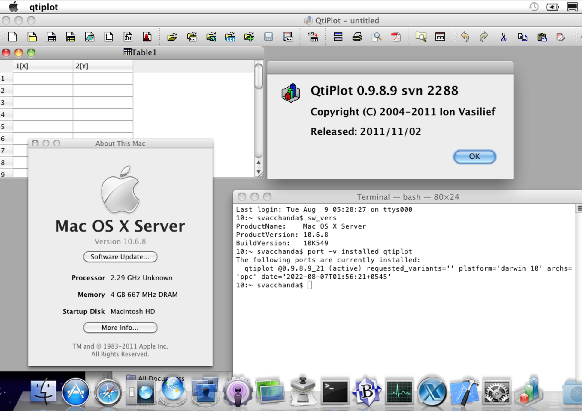

I have found a solution for building gobject-introspection @1.72.0 on 10.6.8 Rosetta.
In /opt/local/share/meson/cross modify ppc-darwin to (make sure to update Meson to 0.62.1 in Macports):
Code:
[host_machine]
system = 'darwin'
cpu_family = 'ppc'
cpu = 'ppc'
endian = 'big'
[binaries]
pkgconfig = '/opt/local/bin/pkg-config'
cmake = '/opt/local/bin/cmake'
ar = '/opt/local/bin/ar'
strip = '/opt/local/bin/strip'
[built-in options]
c_link_args = ['-arch', 'ppc']
Open portfile of gobject-introspection and add cross-file arg to:
Code:
configure.args      -Ddoctool=enabled \
                    -Dpython=${configure.python} \
                    --cross-file=ppc-darwin
Modify the setting below to:
Code:
build.env-append    CC=/Developer/usr/bin/powerpc-apple-darwin10-gcc-4.2.1
Now sudo port -v upgrade gobject-introspection or sudo port -v install gobject-introspection.
P. S. On 10A190 you do not need this tweaks.
PowerPC fixes for OCaml are now in Macports.
Ocamlfind and Ocamlbuild tools modified accordingly, so they will also build on PowerPC.
Reactions: sasho648

Some updates of my recent fixes for Macports:
qt4-mac, fixed for Rosetta (and likely 10.6 PPC): https://github.com/macports/macports-ports/commit/d2ee104eb1b87c18238508b6b220d0700a29bb84
qtiplot, been failing across the board for ages, fixed for PPC and Intel: https://github.com/macports/macports-ports/commit/5699ea0b3d9e610e8f8b913b75123141f5cdbf75
rsync, latest version fixed for Rosetta: https://github.com/macports/macports-ports/commit/5a1fbec36fba3b9c35eb265f5eed08bed0ed433f
Akumuli, been forever broken, fixed for Intel and provisionally for PPC: https://github.com/macports/macports-ports/commit/3da501d9ddf1b6cb3a5bc1de6558ffe4f0d0e519
