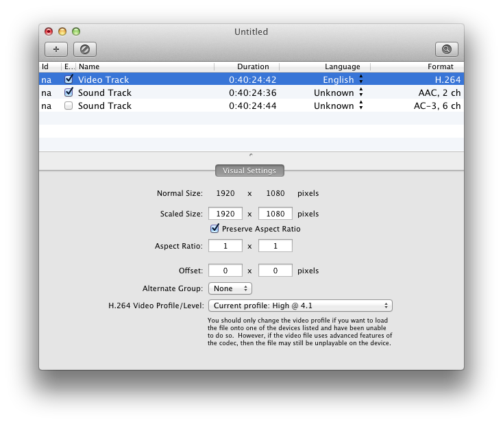

This is what it looks like before I click save:

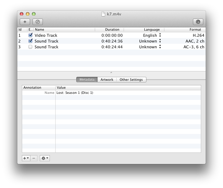

I have a 184MB m4V file as an output with 2 audio tracks and no video.
Here is what Subler looks like after the remux:
It's weird that the video file shows zeros for the time...
Remuxing the MKV by itself provides a file with video and stereo audio. I don't know whats going on.
That is very strange you are getting all zero's for the video after you remux. Is the file over 4GB. On the save window are you checking 64 bit offset if the file size is over 4GB?
