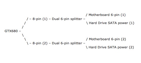

Splitting each 8-pin evenly over a 6-pin and SATA would even out the load (though the split isn't equal after my own testing):
I've tried to draw a diagram above to show how to split it, using the 2 6pins on the motherboard and 2 empty HD Sata ports. Even then I'd monitor the power draw like a hawk for a while to see how the card is drawing the power (Hardware Monitor or iStat Menus).

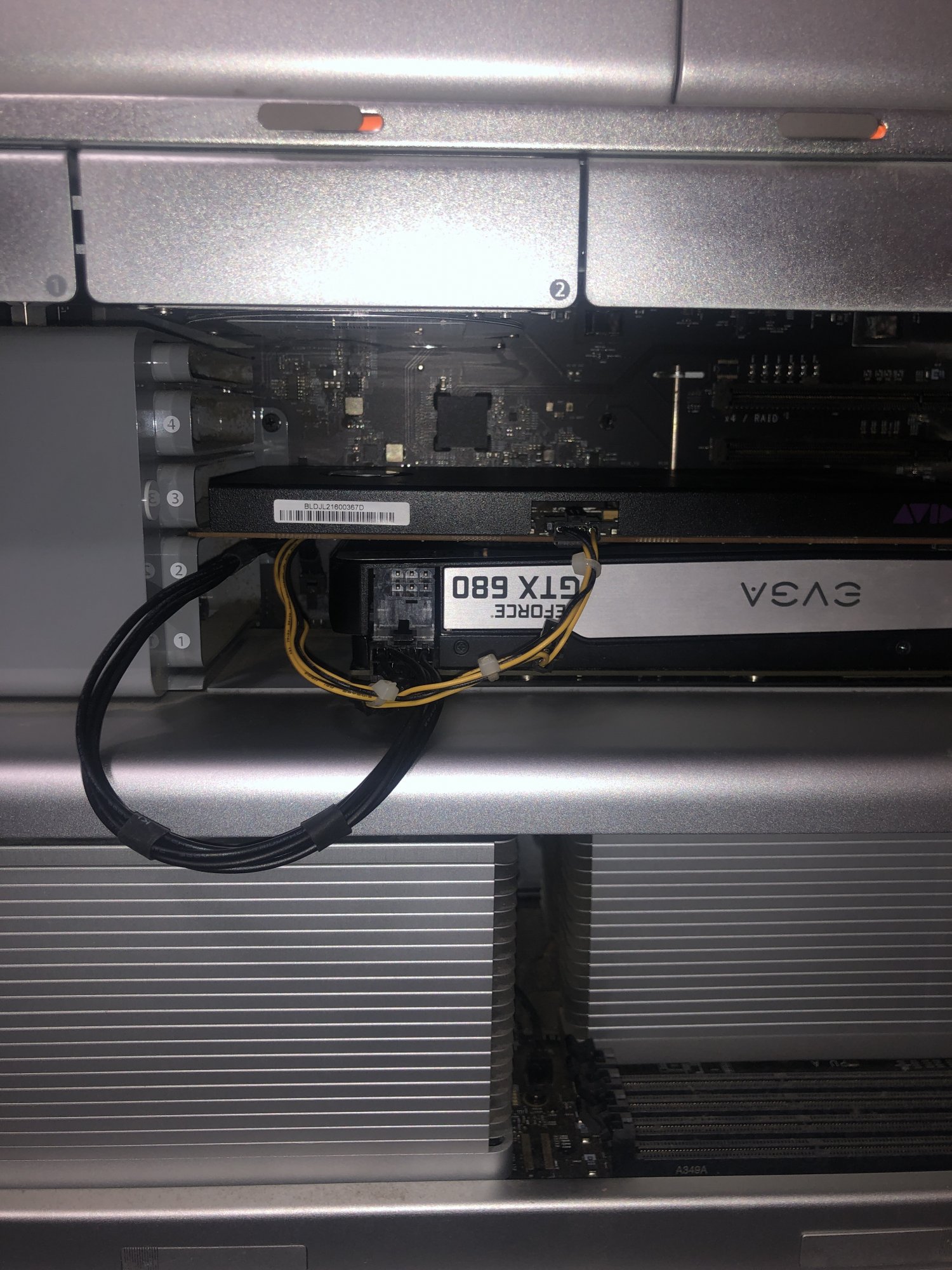

Is the power draw from an EVGA GeForce 680 4gb confirmed. I have the 6+8 pin female. I have the 8pin plugged into the Mac 6pin... but I have an HDX card plugged into the other 6 pin, which leaves the gtx 6pin Open. If the TDP is 175, shouldn’t that be enough to plug the other 6pin to sata? There is no graphic design work goin on with this computer what so ever.
Plug the hdx to 2x sata and let the 680 where it belongs. You will never know what metal draws in the system.

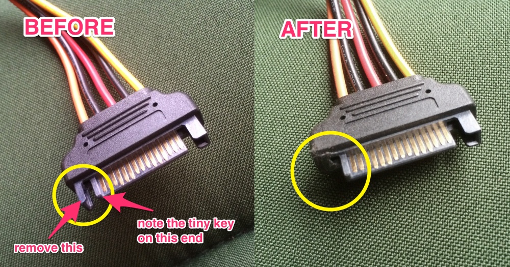

Yes, I realized that as well. Now the next confusion is the only sata to 6 pin cable around is 15pin sata. How do I plug that into a 22pin sata of the Mac Pro ?

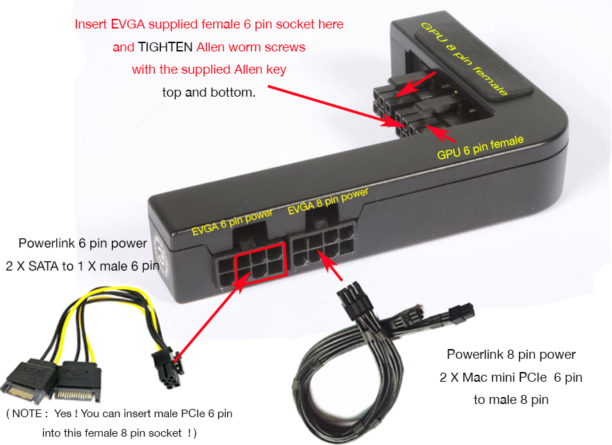

To answer the OP's question . .
YES, a 6 pin male socket CAN be inserted into a GPU's 8 pin female socket and will work . . .BUT . . MUST be inserted into the RIGHT SIDE of the female socket . . it even delivers an AUDIBLE CLICK when being inserted which leads one to think that 8 pin female GPU sockets were designed with this connectivity in mind.
Indeed, years ago, I tried this with an ASUS GPU in a 2,1 cMP . . . worked !
The above says nothing about how much power is delivered.
This is how I currently power my MSI Armor RX 580 8gb with an EVGA PowerLink - I use X-Plane 11 a lot at extreme settings so I wanted to ensure that the MSI GPU is supplied with enough power, might be overkill but no shutdowns.
Note the LEFT EVGa PowerLink 'power IN' 8 pin socket.
As Macschrauber says you have to 'snip off ' one of the SATA locking lugs. Have a look at how the SATA cable plugs into the socket, you'll 'get it'. I put a little white sticker on the cable to show which is " UP " for when I have to re-connect a SATA cable.
Also, whenever I have my cMP's side cover removed, I always check - with a gentle 'finger push' to ensure that these cables are firmly connected.
