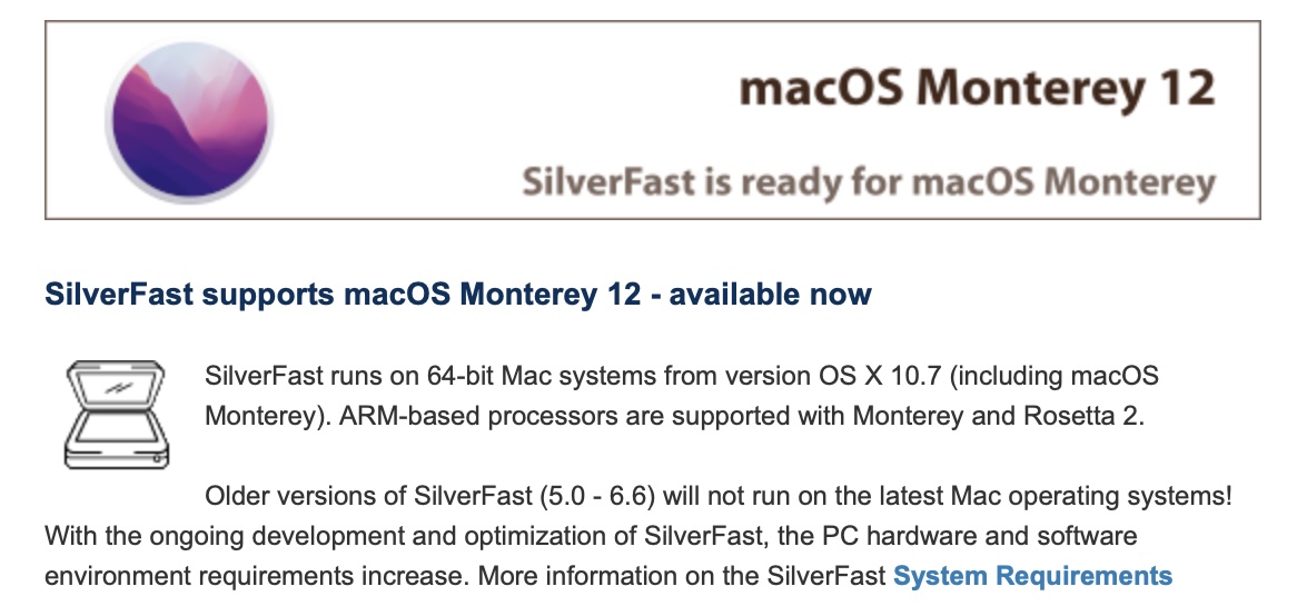

Oh, I have found out the answer is yes, I could use NLP with a Plustek....although I did see a review on B&H that someone could not get the Plustek to work with his M1 machine, so now I have to research that next. But here is an excellent article on a workflow with a Plustek and NLP. If you aren't interested in NLP, he also has a well written article on his site about using Silverfast; but he prefers NLP now and it basically halved his work time.
ETA: It seems like Silverfast works in Rosetta.

silverfast 9 runs with no issues on the m1 architecture.
the plustek 8300AI have been very compatible with the silverfast/quickscan and vuescan softwares on M1 as well.
it's possible the B&H user got a bad one in the box or i know that the folks who make the powerslide and powerfilm scanners recommend not using a usbA to usbC adapter.
i’m using it on a mac studio with USB-A ports.
i haven’t tried NLP, but i’ve seen at least one youtube video where they used vuescan, scanned the negative as a positive and fed that into Lightroom and the NLP plugin.
vuescan runs full apple silicon native
