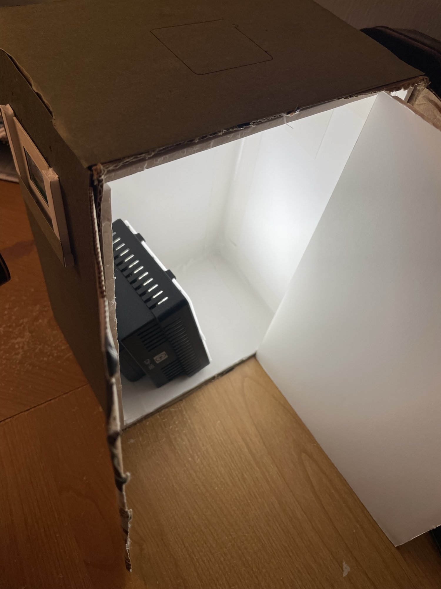

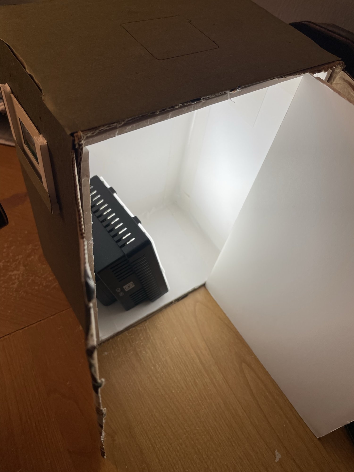

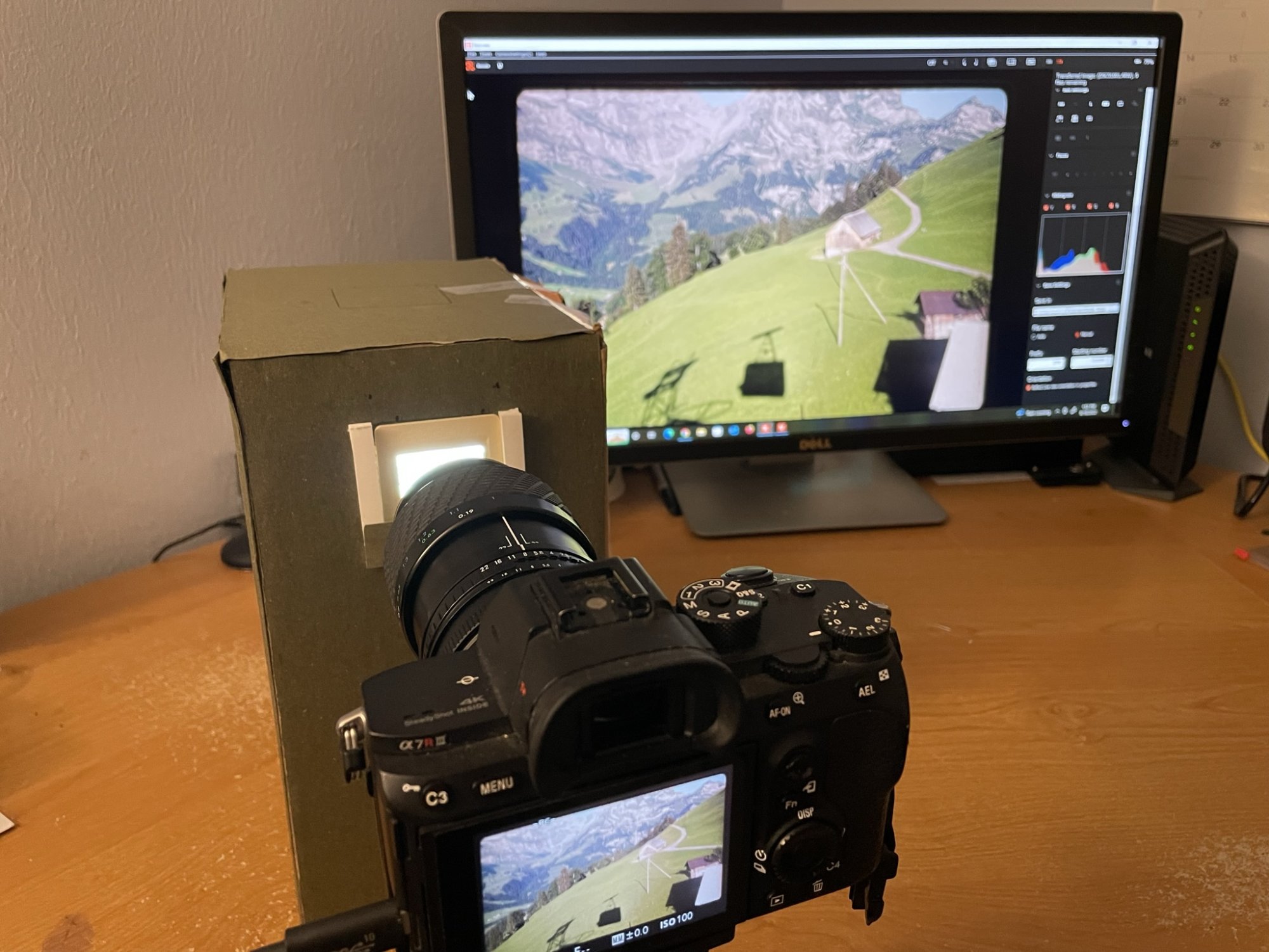

Looked back through page 6 and didn’t see it so must have been another thread. Will re-post the photo. Also, the free software Epson supplies for Mac is Silverfast.
On the light box, total cost was $0.00 It was a Amazon box pulled out the recycle bin. Interior white foam poster board had on hand For color balance. Video LED used, bounce off lower box interior foreven light and avoid direct LED hot spots. Slide holde from 3 foam poster boards to slide slide I’m. For film pull through woul experiment with one or two film layers (or similar depth cardboard) used as upper an lower guides. On the left an right edges foam overlay to fish the film under to pull along the guides.

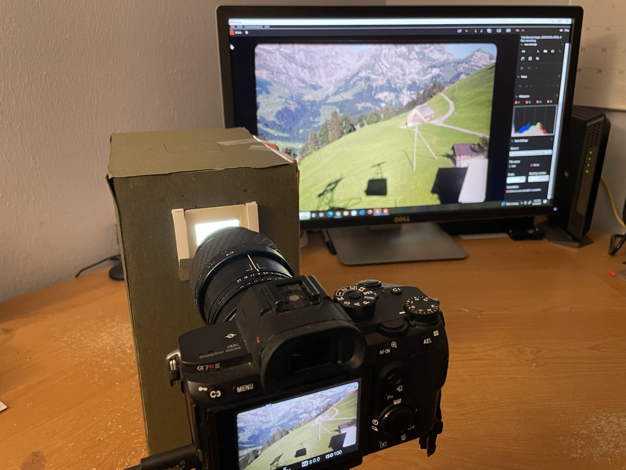

Linking camera to large monitor for fine focus and firing camera, avoiding shake.View attachment 2091759View attachment 2091760
But that is 35mm right? I'm good with 35mm, but it's the medium format part that is tricking my brain right now. 🙂 But I think I will try the Lomo mask (which I think I can pick up today at my local store) and try that first.
The two rolls that I've done I've just done in a 97% dark basement bathroom to roll the spools and then take everything to the kitchen sink to process.

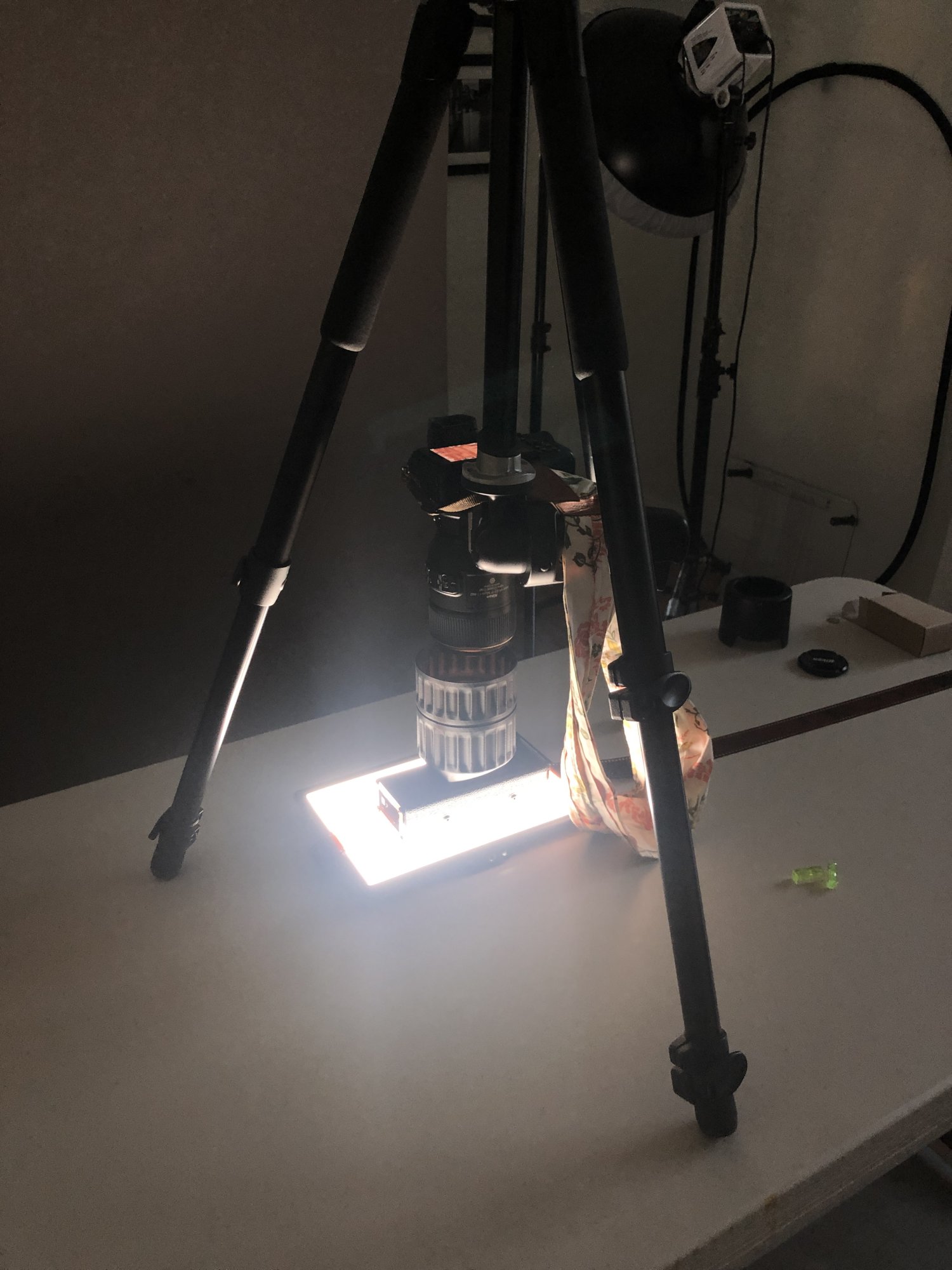

I have an old Manfrotto tripod that I can pull the center arm out and reverse, so I use that as a c-stand. Someday I might upgrade to a real c-stand where I can mark different heights (I scan both 35mm and medium format, so my height changes based on what roll I'm doing).
Here's a photo of my basic setup. I have a couple of extra things shown here that I've added in over the past year but they aren't absolutely necessary (like the scanning hood, which I only have for 35mm). And I bought some bubble levels to make sure my camera is square to the scanning setup.

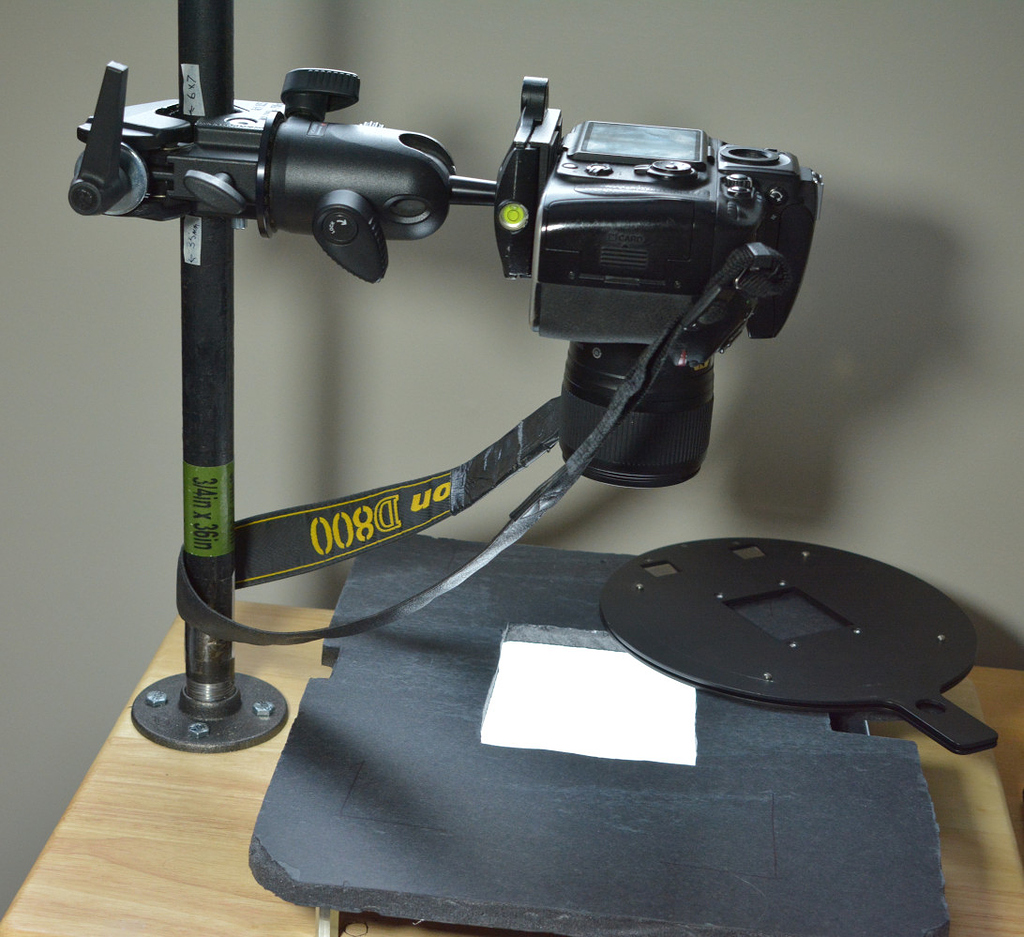

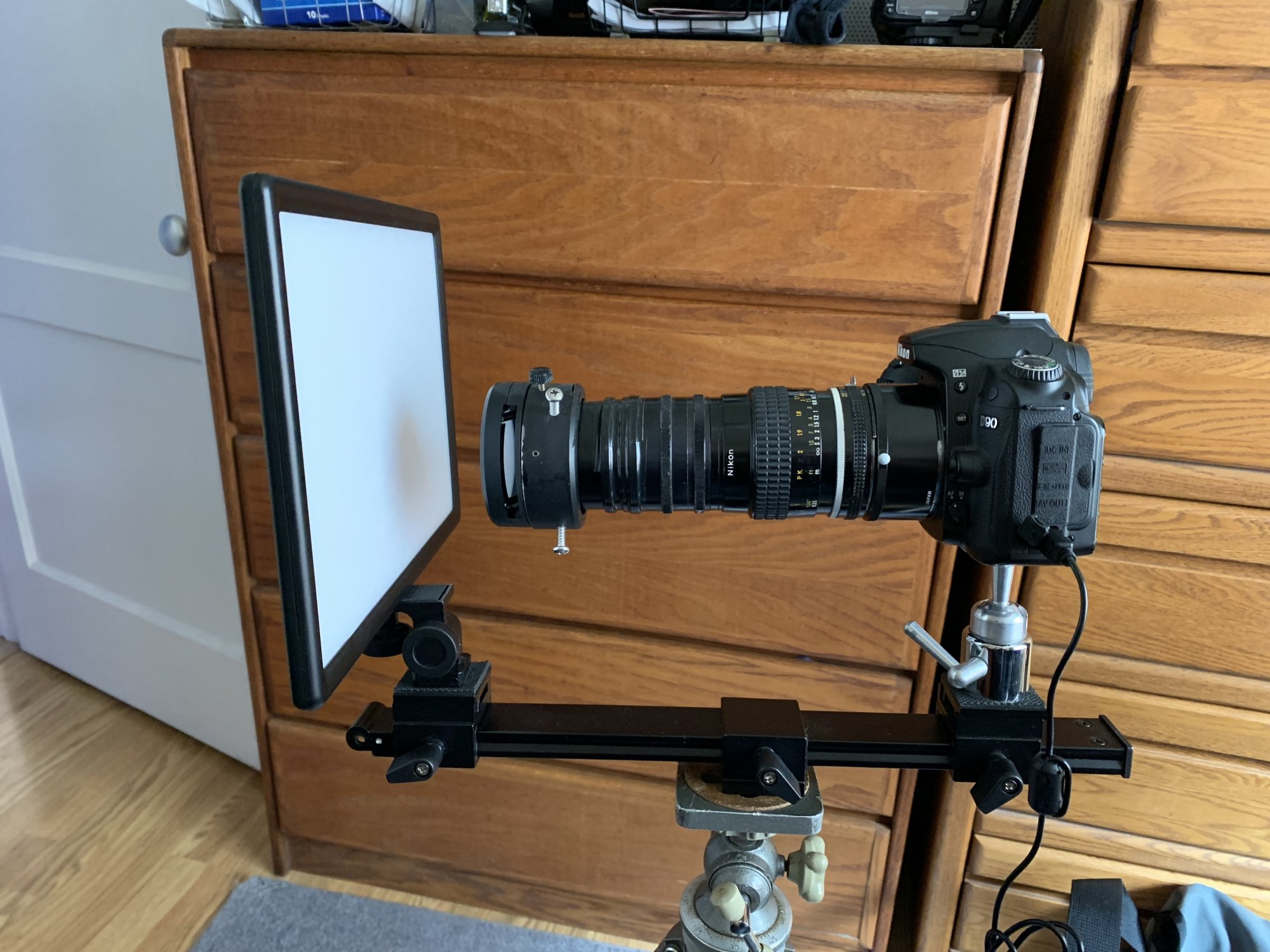

I thought I would share my camera scanning setup. I found all of these parts on eBay. What I like about it is once it is setup the film and sensor plane stay in alignment. As far as software goes I just use photoshop for my conversions. I have actions set up so the negative conversion is pretty quick. I also have a few desktop scanners I also got from eBay. Usually I need to buy two or three to get one working one. I also keep an old snow leopard Mac running to use the native scanning software. I not a big fan of digital ice, in my view it degrades the image too much for my taste, also I have a lot of old Kodachrome's & Black and white negs and ICE does not work well with those films. Being an old lab rat (photo lab worker) The cleanup does not take me very long.
