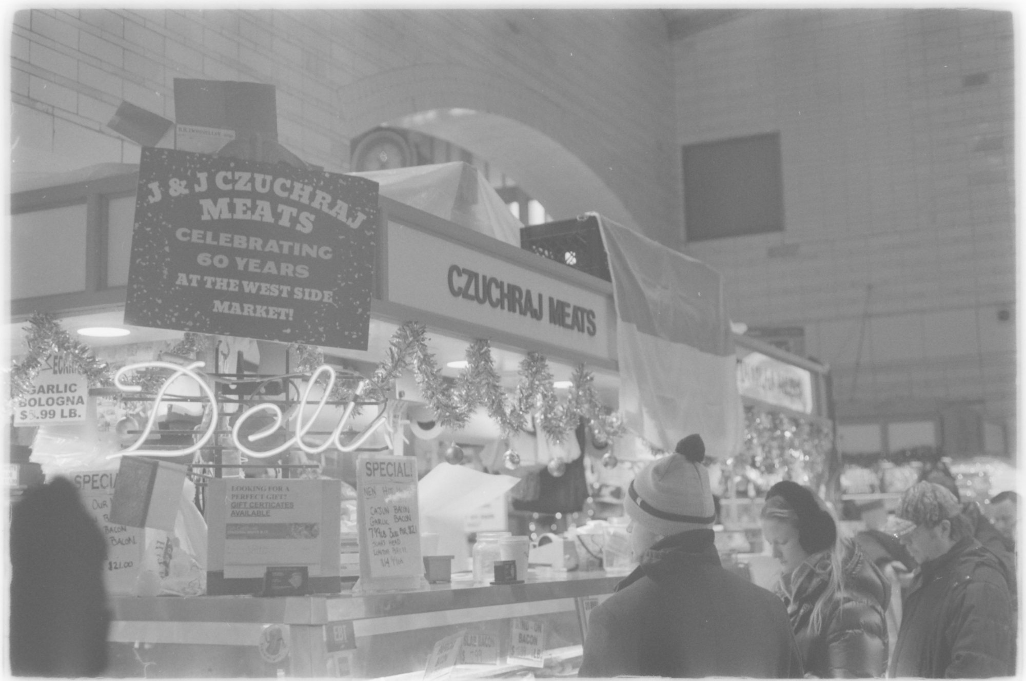

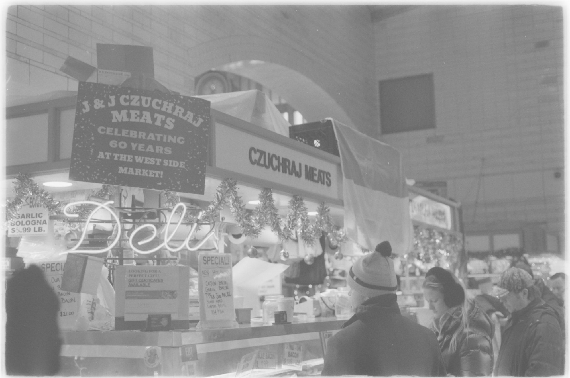

An example of my first shot at developing, this is the Kentmere 400, 6mins @68F using theHC110. 'Scanned' in RAW on the EOS RP in a film holder and presented here with no processing apart from inverting and exporting as a JPEG for the web...the low-contrast looks great in some shots, but some others look much better when I crank up the contrast after scanning.
Getting the focus right when 'scanning' the negatives using the FD 50mm 3.5 Macro is very challenging. I feel like I can't quite see when I'm right on.
I like the way things came out, but I am now trying to think about how to control the contrast of my shots better. Metering? Film stock? Development times/technique and developer choice?

Often low contrast in the negative isn't necessarily a bad thing as global contrast can be increased in post(or printed at a higher grade in the darkroom).
With that said, shooting at higher ASA and developing longer(pushing) can give more contrast. Developer selection plays a part too, as there are some known high contrast developers. Rodinal is one of those. If you want to get brave, Dektol is super high contrast(and also so active that it give stupidly short times on film).
Last thing-filters can increase contrast but need some thought about selection for a specific scene. Yellow, orange, and red are the standard B&W filter kit, but blue and green also have their place. If buying them, I recommend getting good second-hand filters. A while back I looked at bunches of filters in a spectrophotometer. Good ones-Hoya, B+W, Nikon, and even some "second tier" brands like Tiffen will transmit light down to the stated wavelength then cut off completely, which is what you want. The cheap no-name filters I tested had "notches" that gave the desired color to your eye, but would basically be useless on film since they weren't true cut-off filters.
To me, that looks like it's flat due to processing, not the original exposure.
How do you agitate when you're in the developer? Flat negs and what looks like overdeveloped streaks (along the top of the frame) come from insufficient agitation, that could be at least part of your issue.
As for precise focus on the negs when making a digital "scan" with your EOS RP, you should go into live view, and then you can magnify that. This link should help.
And make sure you're not using the lens wide open at 3.5, that will help!

yes i zoom into the grain on live view and definitely don’t be afraid to add contrast in post. how did you convert negative to positive?
For agitating, I've just been inverting the tank repeatedly. Maybe I should be shaking/swirling with it a bit more oomph?
When shooting the negatives on the RP with the macro lens I've been set up at F8, ISO 200. If had something like the text on the edges of the negative to focus on I could get it dialed in fine, but my film holder obscures those. I will try the live view, thanks for the link.
I am using a very low-tech conversion process - Irfanview batch process/rename tool to open the RAW image, convert to greyscale, invert, and save as TIFF all in one go.
I gave up on Adobe after CS6 to avoid paying monthly subscription fees, but I have an owned copy of CS6 on my old Mac Pro, I could use that as an alternative.

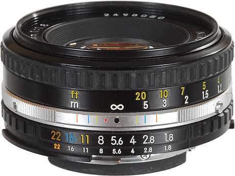

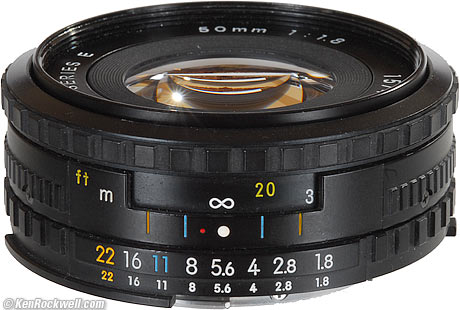

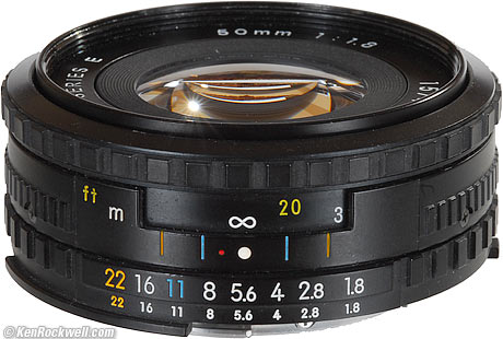

Zone focusing question: I've been shooting more lately with the Nikon FM / Series E 50mm f/1.8, and if any of you own that lens I had a question about the focusing distance scales on the lens.
With my contemporary Canon lenses the focusing scales on the lens barrel are shown as a bracket specific to a given aperture. It's easy to read the near and far distance limits. But the E-Series Nikon lens has several colored brackets. Some of the colors seem to match with aperture settings (orange, blue, and yellow), but starting with f/8 and wider the apertures are printed in white, and there is no white bracket. If I am shooting at, say, f/8, which of these brackets should I be reading to measure my appropriate focus range?
Probably a dumb question, but I haven't yet been able to find a copy of a user manual for this lens to explain reading the scale.

If I understand the question the colored bands on a Nikon lens are for setting your Hyperfocal distance. For example the blue band is for f16, if you set the infinity mark at the left blue band everything between the blue bands will be in focus according to the distance scale. Scroll down to read about it in this link https://digital-photography-school.com/what-the-numbers-on-your-lens-mean/ The explain it better that I can.
Ah, yes, that's exactly how I understand it as far as it goes for f/22, f/16, and f/11. The part I'm slightly confused about is, if I set the aperture to one of the white-colored settings (f/8 through f/1.8), which hash mark should I set the infinity mark at? Blue? Orange? Yellow? Something else?
I'm sure there's a 'method to the madness' for this particular lens's scale, but I am not sure what it is.

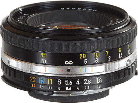

Also, I note that the first version of this same lens (I have the second version illustrated in my previous post) has a slightly different hyperfocal distance scale:
I believe for the white colored apertures the scale is not valid. I do remember learning in school how to figure it out manually. But that was over 40 years ago and the info fell out of my brain. But learning the formula will be your best bet. I believe the scale is tied to the focal length & film size (sensor size) not a particular lens.
I see...in which case I should be able to just use the same scale as it appears on my Canon FD equivalent lens (the 50mm f/1.4)...I also looked up the formula and see there are tables online. Thanks!
I am mostly trying this to improve my skill at taking 'snapshots' outside, without standing there like a dope futzing with focus.
