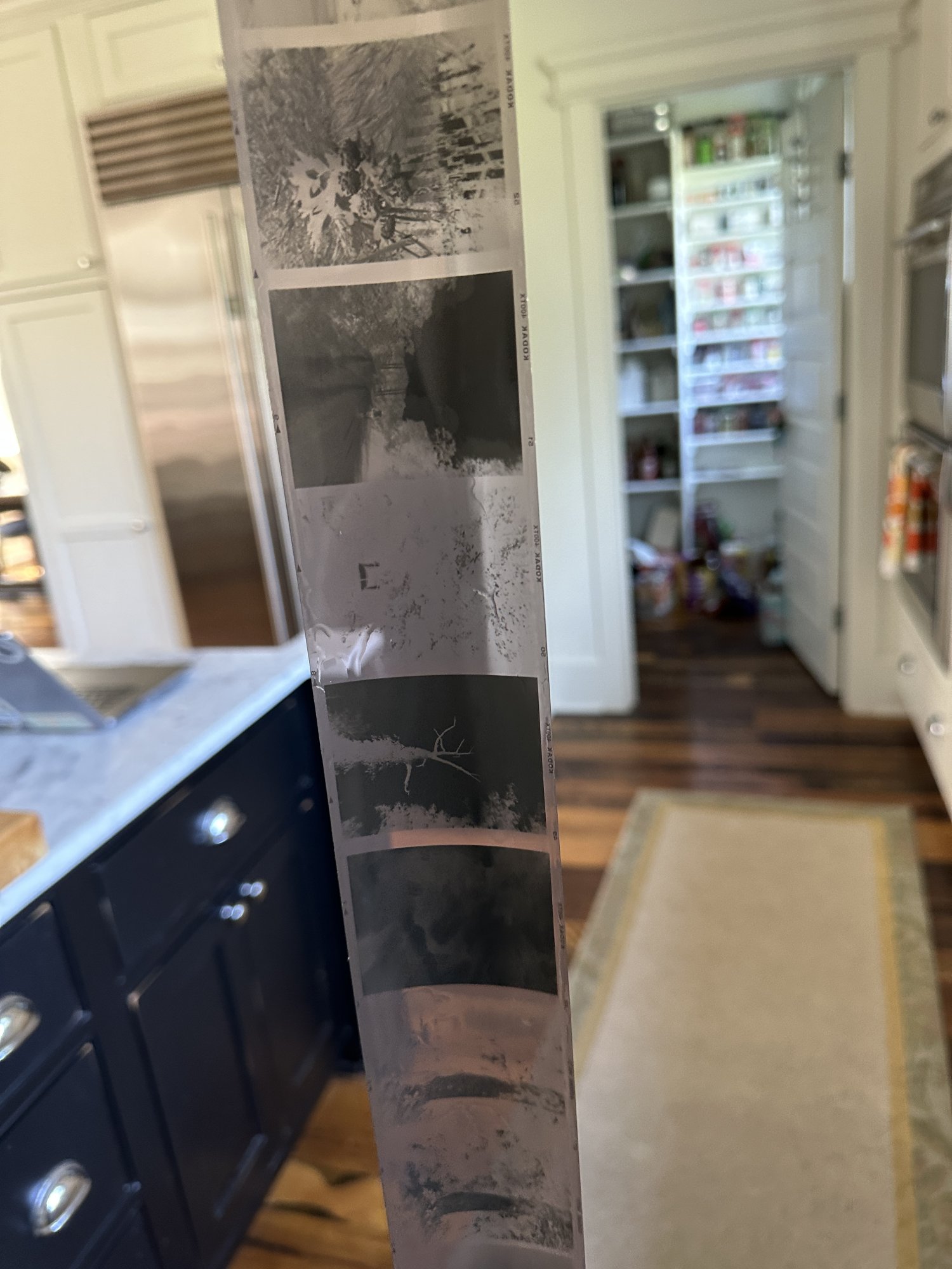

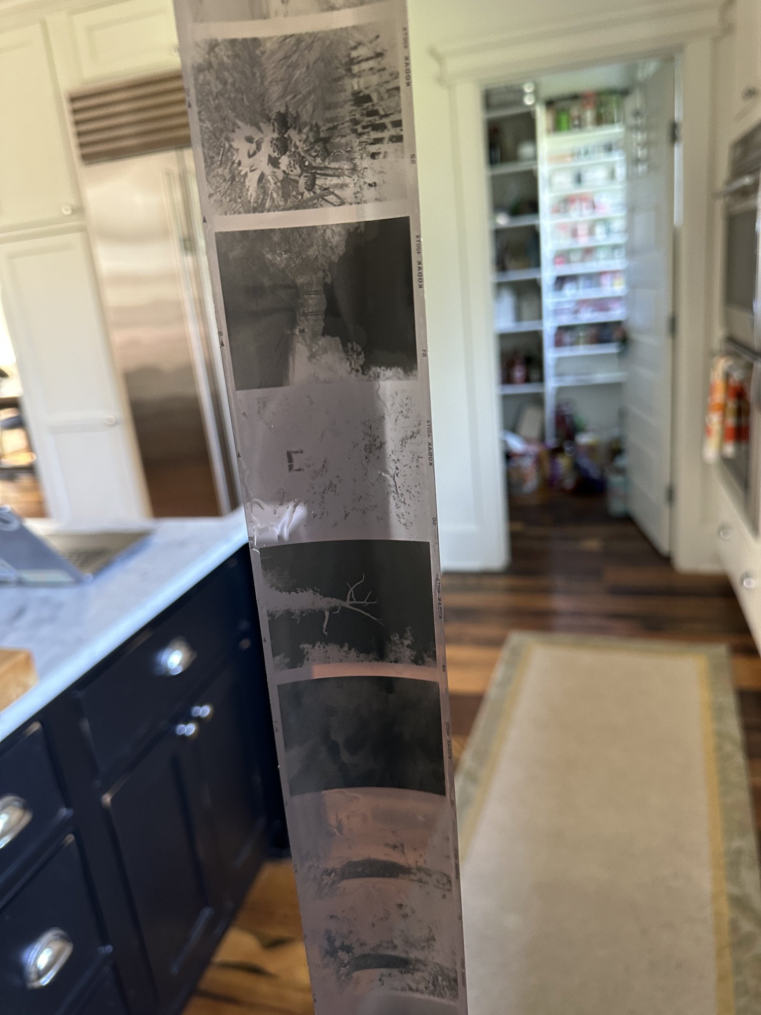

To me, that looks like it's flat due to processing, not the original exposure.
How do you agitate when you're in the developer? Flat negs and what looks like overdeveloped streaks (along the top of the frame) come from insufficient agitation, that could be at least part of your issue.
Just to follow up on this - I have developed several rolls of HP5+ and Kentmere Pan 400 since this post, and got better results with less agitation, following a process more similar to the one you linked to. I'm not sure what I did before to get the streaks, but it hasn't happened since like that.
Of the films I have been using (TX-400, HP5+, Kentmere Pan 400), the Pan 400 seems to produce a 'flatter' negative than the other two. So I think I need to bump my time in the developer over the recommended 6 minutes to try and rectify that.

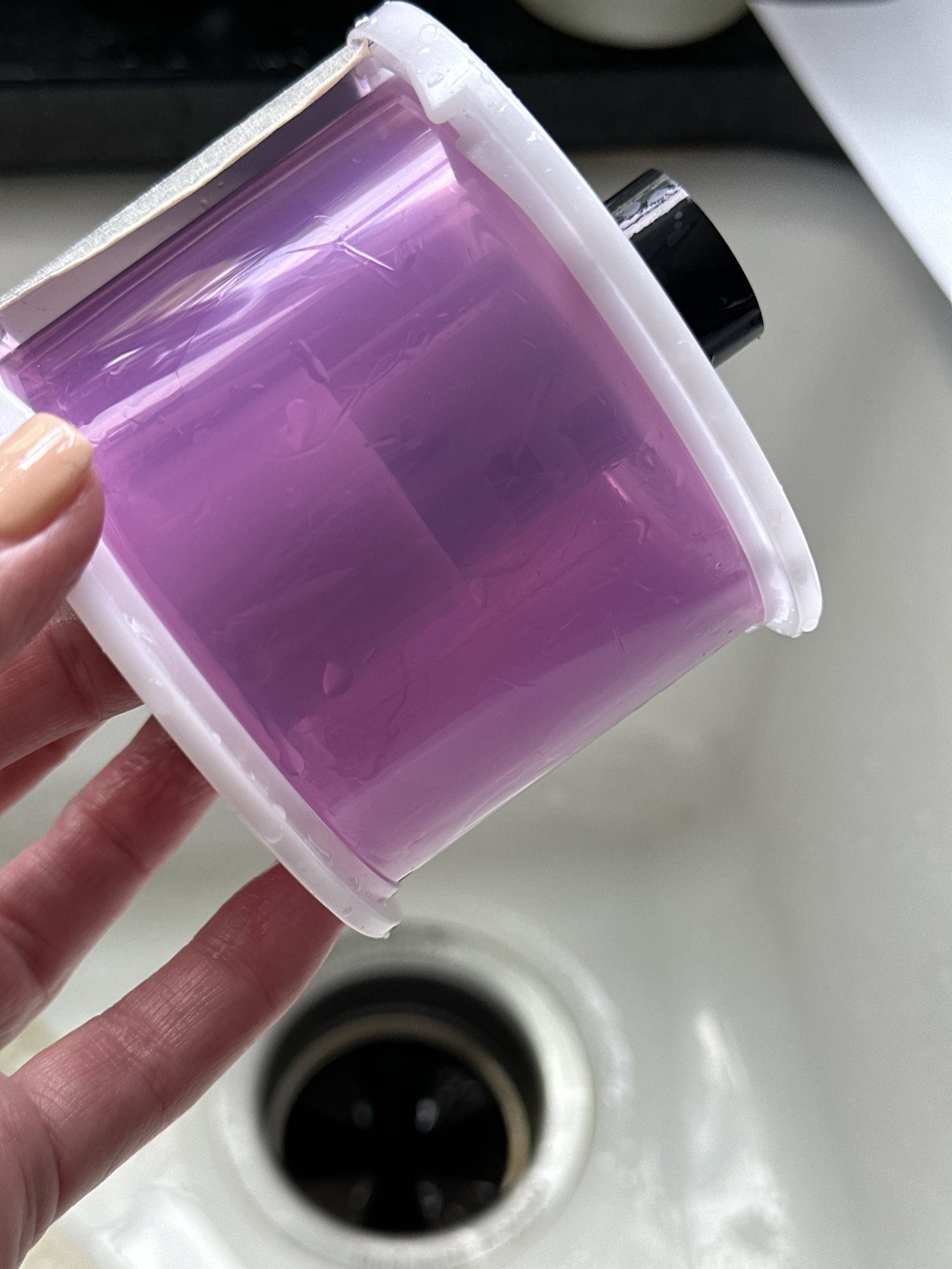

oops.. guess i need some new developer. and also apparently a new batch of fixer.
Has anyone here tried developing in caffenol? I ordered new developer, but I misread the delivery and it won't be here until Friday, which seems like an eternity away. Was thinking of just getting the ingredients for caffenol from the grocery store today and trying that. I figure I don't have much to lose but wondered if any of you have real life experience with it.
I’ve made it before and tried it.
Maybe it’s the chemist coming out in me, but I disliked some of the imprecision in it(especially given the variability of things like different brands and that much is measured volumetrically).
I had a bunch of back channel communication and note sharing with someone on Pnet a few years ago. He theorized that the active reducing agent was actually caffeic acid, and I did some quick experiments that told me he was correct and actually couldn’t find that caffeine made any meaningful difference. I started working on a formula of mostly sodium carbonate and caffeic acid, but never got it to where I was totally happy. It probably could work, but life happened and I haven’t revisited it.
Short answer though is that I personally wouldn’t bother with the standard instant coffee formula but if you want to experiment it’s worth a shot.
