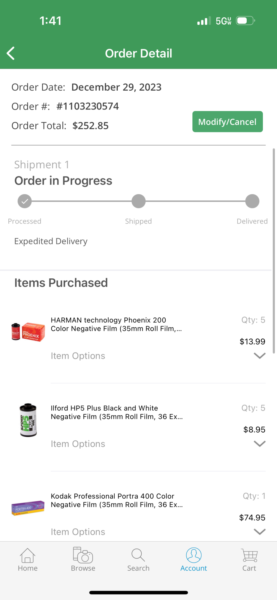

I know my local store had some when I was in last week. B&H is showing in stock also, but thanks also for that information. I don't want to miss out on this first run!
I just ordered two rolls from B&H. 🤣
I don’t know if this is a film I will want to shoot regularly (if it remains available), but I want to encourage Ilford to get into the color game and naturally I’m curious what this will look like shot in my cameras.
Reactions: mollyc
Yeah, this is me. I won't use it for "good" photos. If I can get a roll tomorrow, I'll probably hang on to it and use it in the spring when it isn't drab, but I'm not expecting much from it. But I agree that we should support Ilford for more work on this and other color films.
