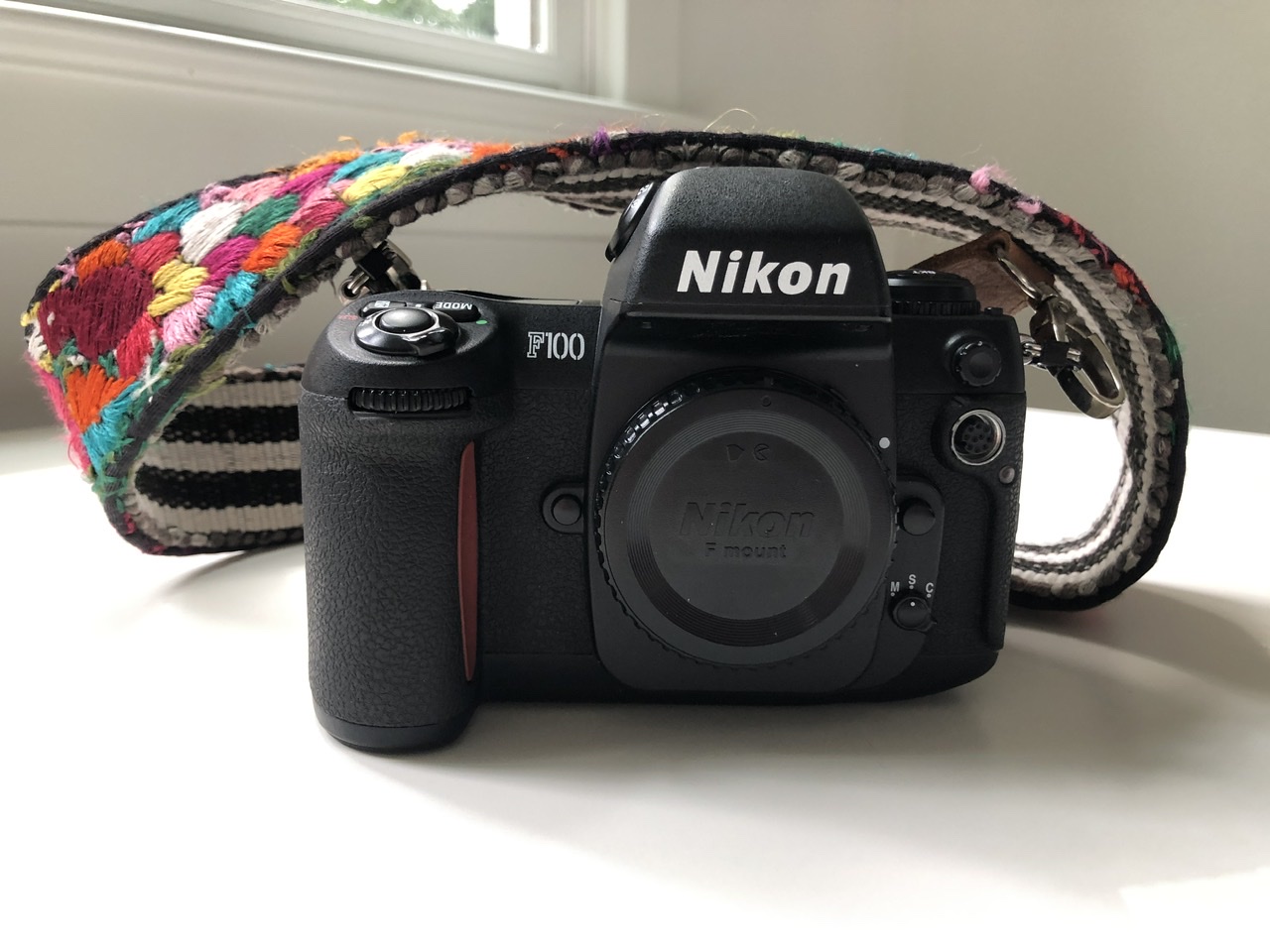

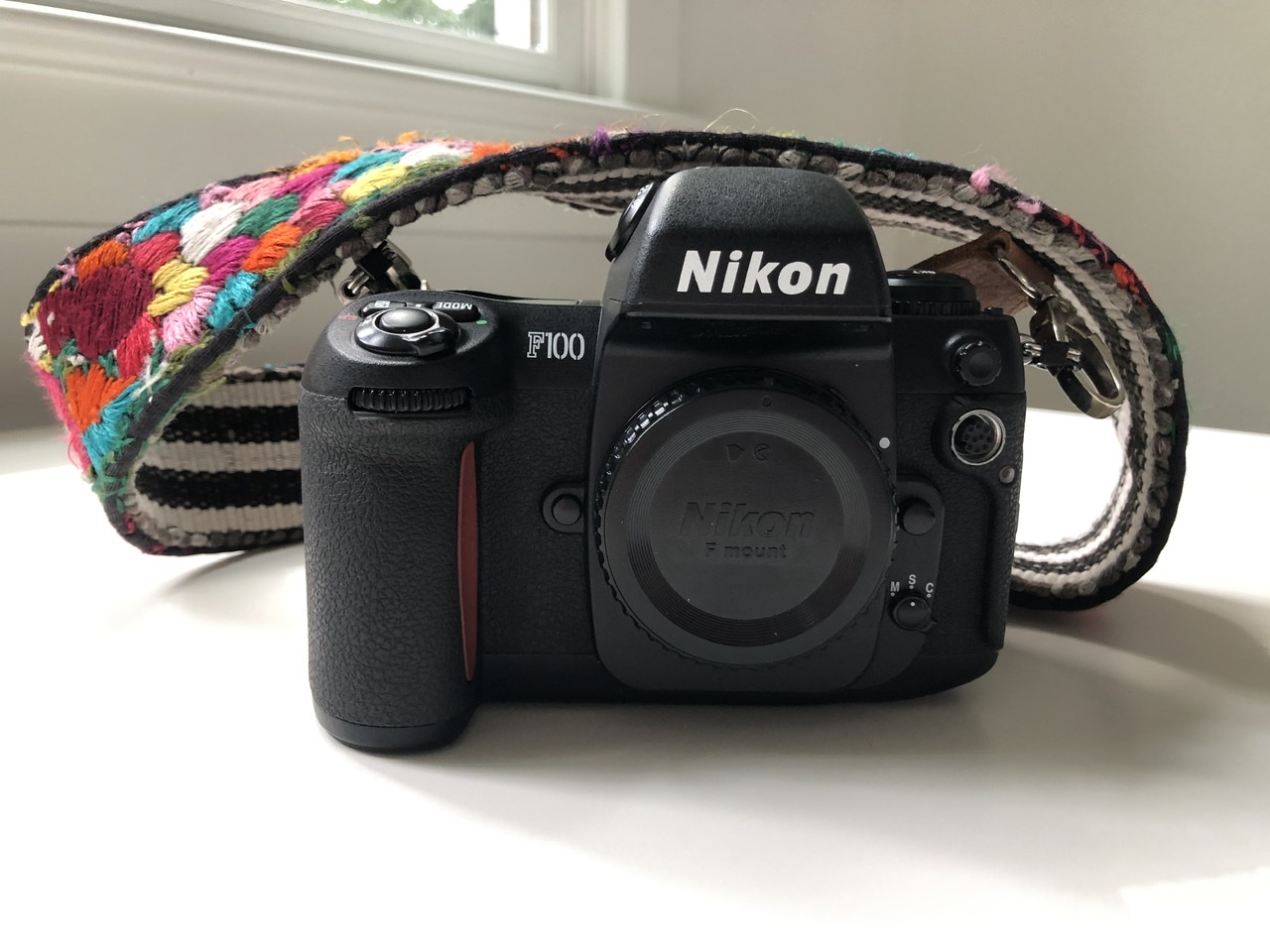

I bought my F100 today!
Excellent! Excited to see results!

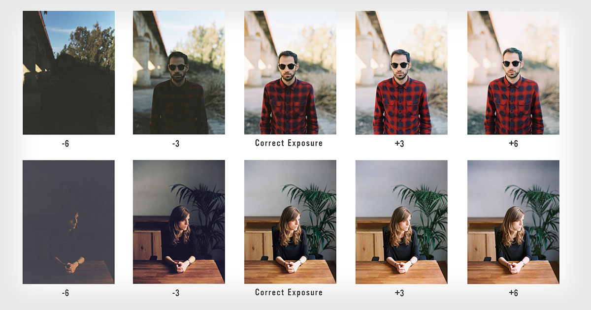

Good call on the +1. When I shot C-41 film, this was a regular habit of mine for richer colors.
In general, C-41 film loves overexposure. If you ever shoot Ektar 100, I do recommend it at box speed, but other emulsions can tend to give richer color when overexposed. Portra films have latitude as wide as a barn door, and I've seen comparisons over a range of +2 to -2 stops from box speed that show little difference in the final scan or print.
Here are some nice comparisons on how over- and under exposing certain films can affect the results.
Reactions: mollyc
