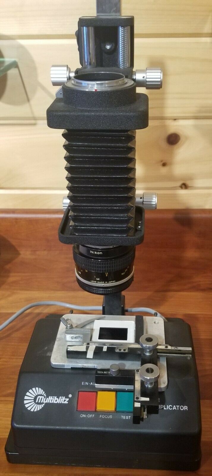

Lab scanning - cost will vary based on the quality you want, basic jpegs or a higher dpi (if you plan on having large prints made)
Attached is a digitizing service I will have some slides processed at

I did like an earlier suggestion of creating a good light box and carrier set-up, and using a good digital camera macro set-up as opposed to scanning. Since Molly already has the camera gear this approach could prove quite feasible, whether shooting slides or negs.
Anyways my original sentiment stands. Have fun with it!

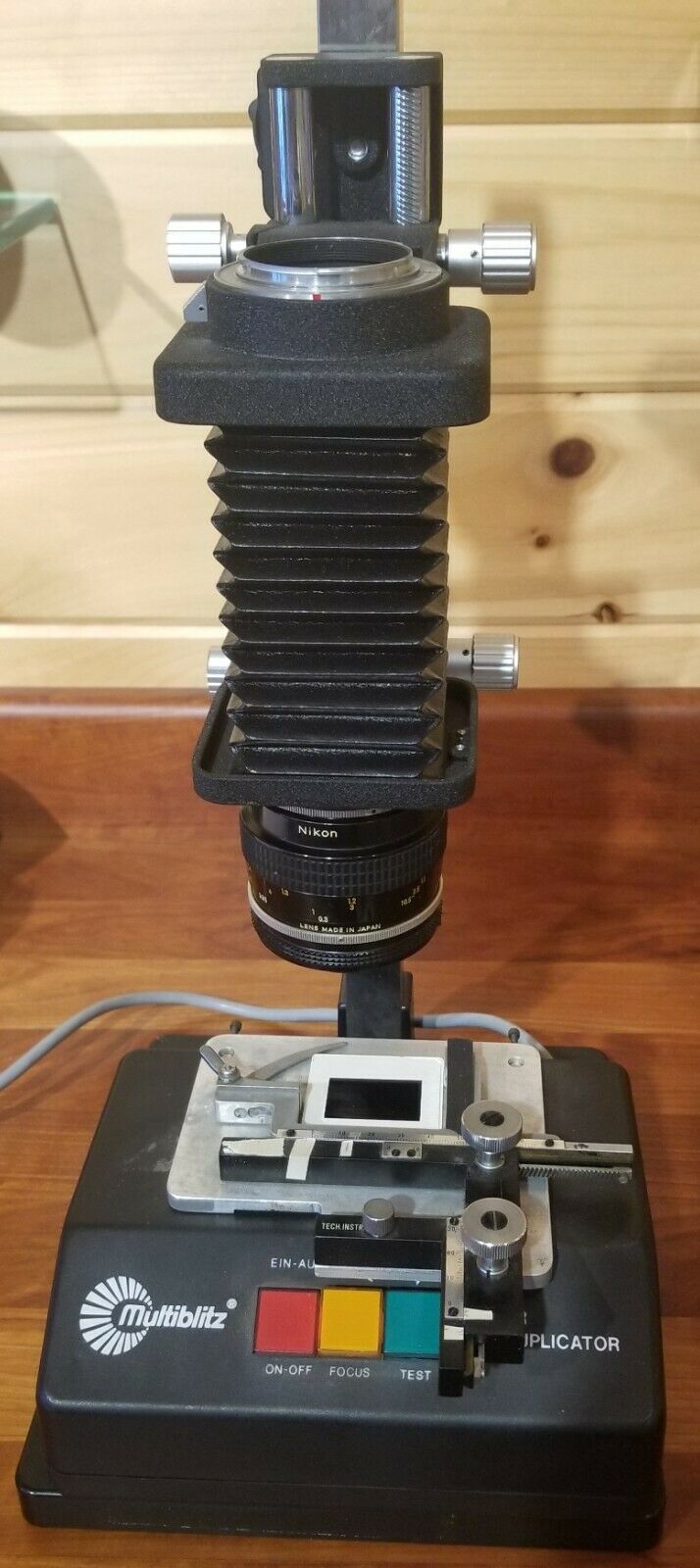

Something like this can be found on ebay. Worked well back in the day.

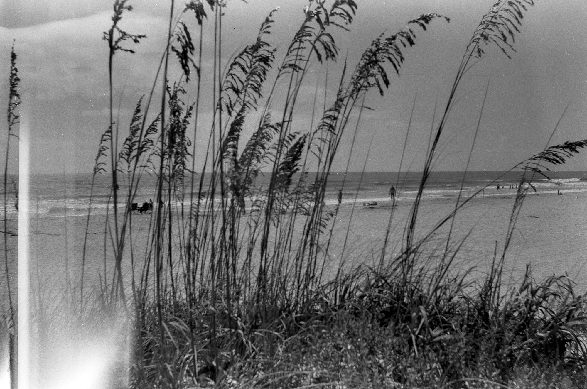

Earlier posting (#52) on this thread got me to thinking about running a roll through a vintage camera "just for fun." Was looking at chemicals for developing, since I have the tanks and other equipment, but when they said $5 to develop B&W - negatives only, no scan - but I can do that, I quit looking at chemicals. This currently is only a 1 roll experiment so shelf life of $20-$30 of chemicals would become an issue for multiple future rolls, making the $5 a no-brainer.
First the good news, held film, still in foil, against the take-up reel, and the edges match so the camera takes 120 film and won't require an adapter for 116 film that hasn't been manufactured for decades (century???). Then I noticed that had wooden reel that haven't been used for decades (WWII when metal was scarce?). Do I really want to turn that in with the film to be developed rolled around it? The camera store indicated they do the development in house, so could ask for it back, but probably better just to get a metal roll to begin with.

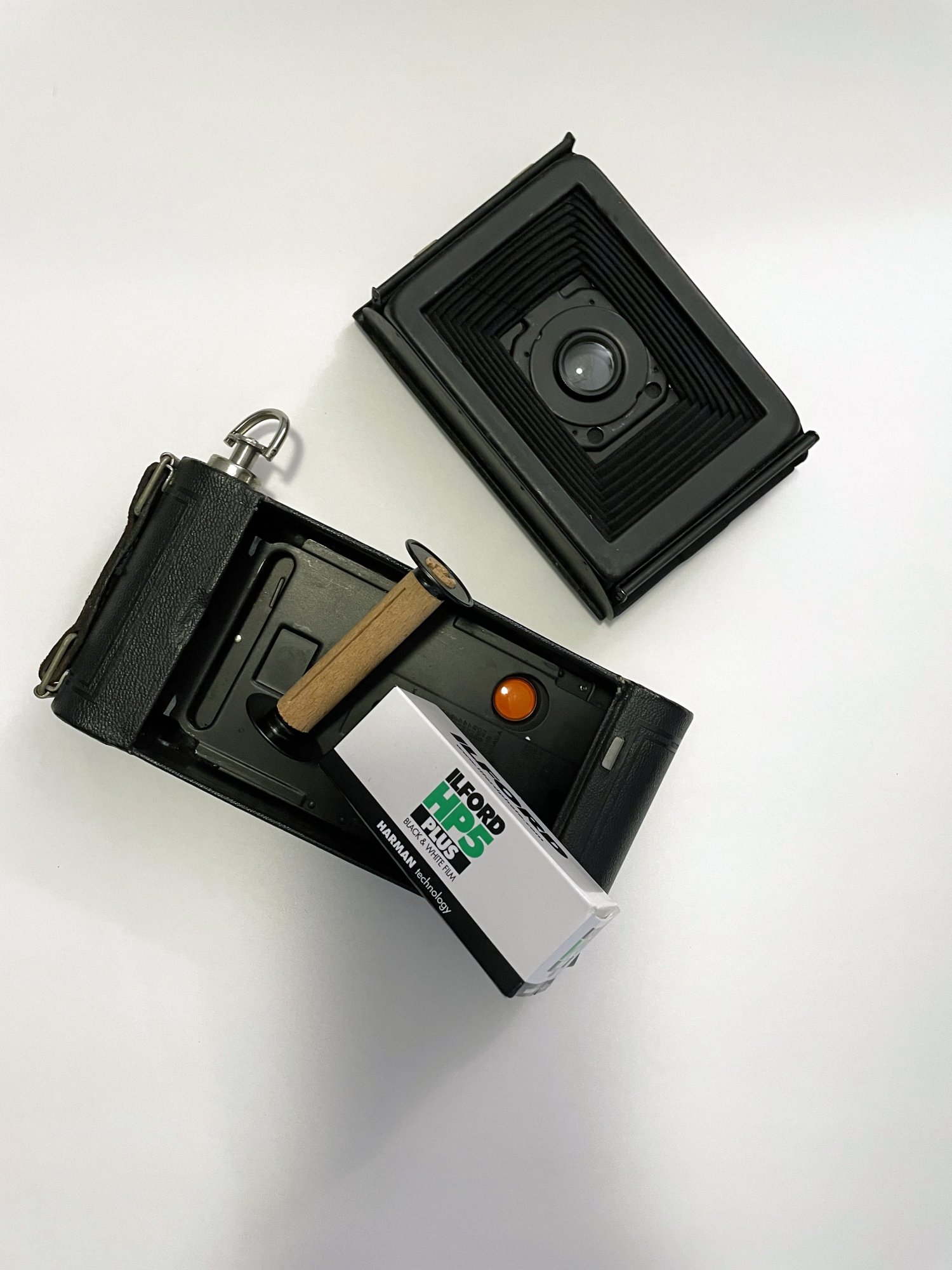

I’m have trouble finding someone to fix my grandfather’s camera. I don’t know how to make bellows nor install them properly. ☹️
You may want to contact (from his website) Jurgen Kreckel who does antique camera repair and own certo6.com. He is located in Pennsylvania. Internet search shows him to be highly respected among antique camera forums as he did repairs. Interactions indicate that he can be a little eccentric as antique camera are his baby. Cost? No camera repair is cheap, but probably in the low $100's. As states on website, describe problem as you perceive it in email, and he will return a quote. Good luck.
Reactions: mollyc
yes, I did look at him already. Unfortunately he has some very poor reviews on Reddit (I think the Antique Camera channel, I forget exactly) of people who have used him, so I got a little turned off. Like taking months and months to get their camera back and then things not fixed properly.
I did find some place in England that I think could fabricate the bellows for me but then I'm left with the how to get them attached part.
OK...ran that roll of film through. Counted size correctly with 8 exposures rather than the typical 12 "square 6x6mm" on 120. Bellows didn't have a light leak, but inadvertent back opening caused exposure issue. The back release slides too easily and next time will put tape over latch when film is loaded. Only 6 exposures as really underexposed on 2 interior shots...which were the ones I wanted, of course. They were of my 91 y/o mother and 4 mo old great grandson - and the irony of a camera older than her. Used my Sony for meter reading as with all of the others, but mis-set something, and unfortunately didn't think to use the Sony or the iPhone to take a back-up picture.
OK...ran that roll of film through. Counted size correctly with 8 exposures rather than the typical 12 "square 6x6mm" on 120. Bellows didn't have a light leak, but inadvertent back opening caused exposure issue. The back release slides too easily and next time will put tape over latch when film is loaded. Only 6 exposures as really underexposed on 2 interior shots...which were the ones I wanted, of course. They were of my 91 y/o mother and 4 mo old great grandson - and the irony of a camera older than her. Used my Sony for meter reading as with all of the others, but mis-set something, and unfortunately didn't think to use the Sony or the iPhone to take a back-up picture.View attachment 1807181View attachment 1807182View attachment 1807183View attachment 1807184View attachment 1807185View attachment 1807186

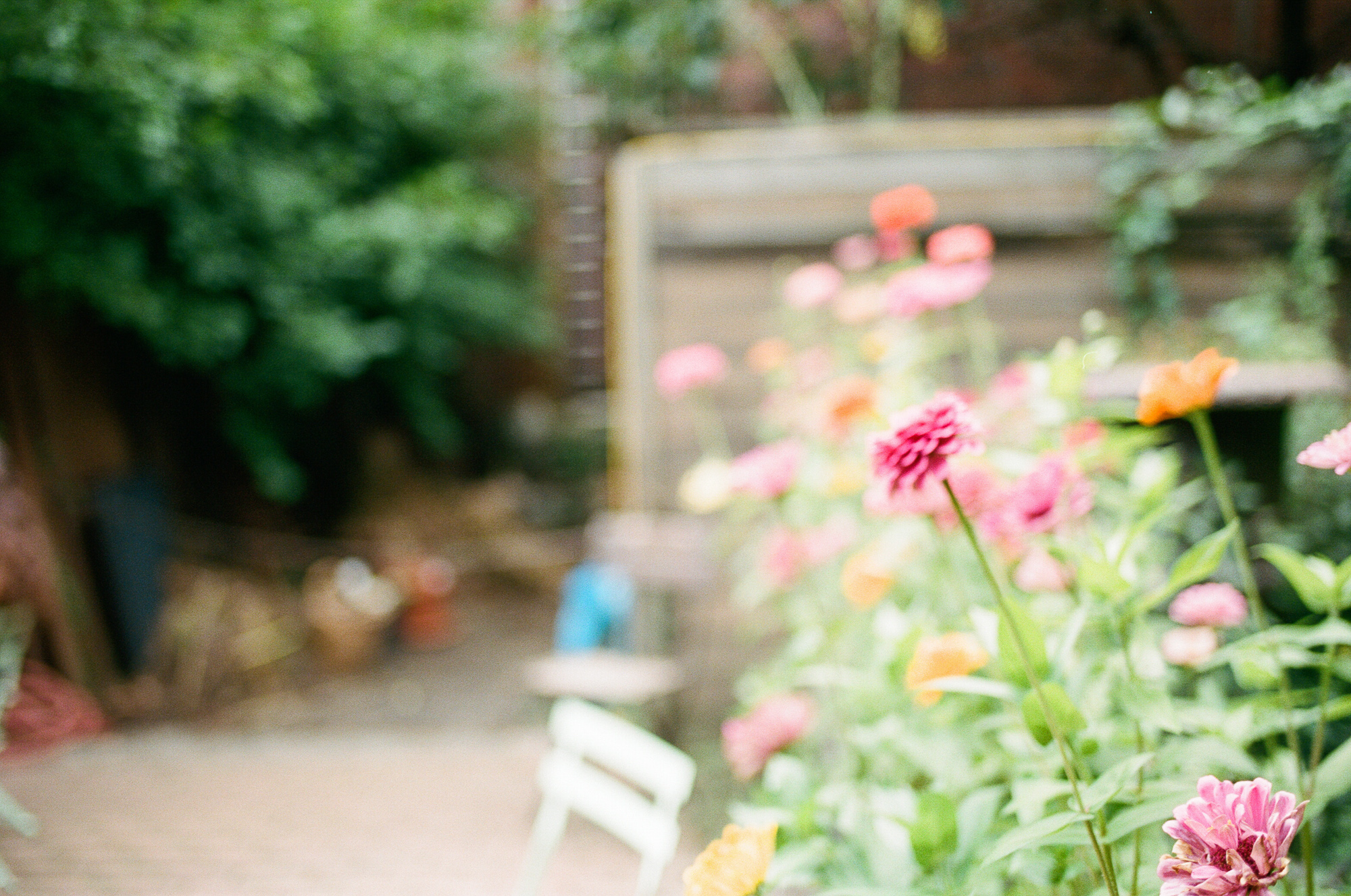

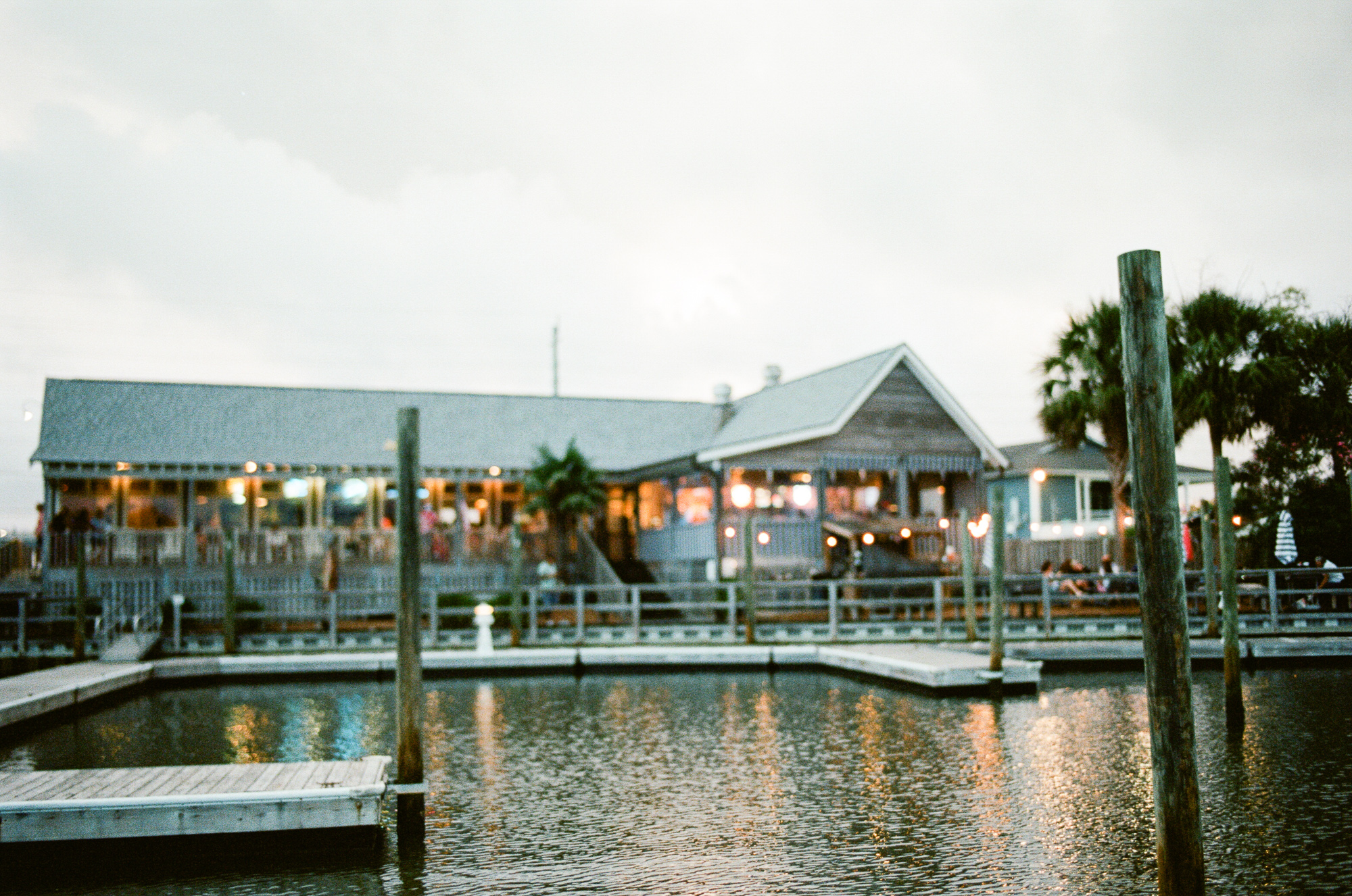

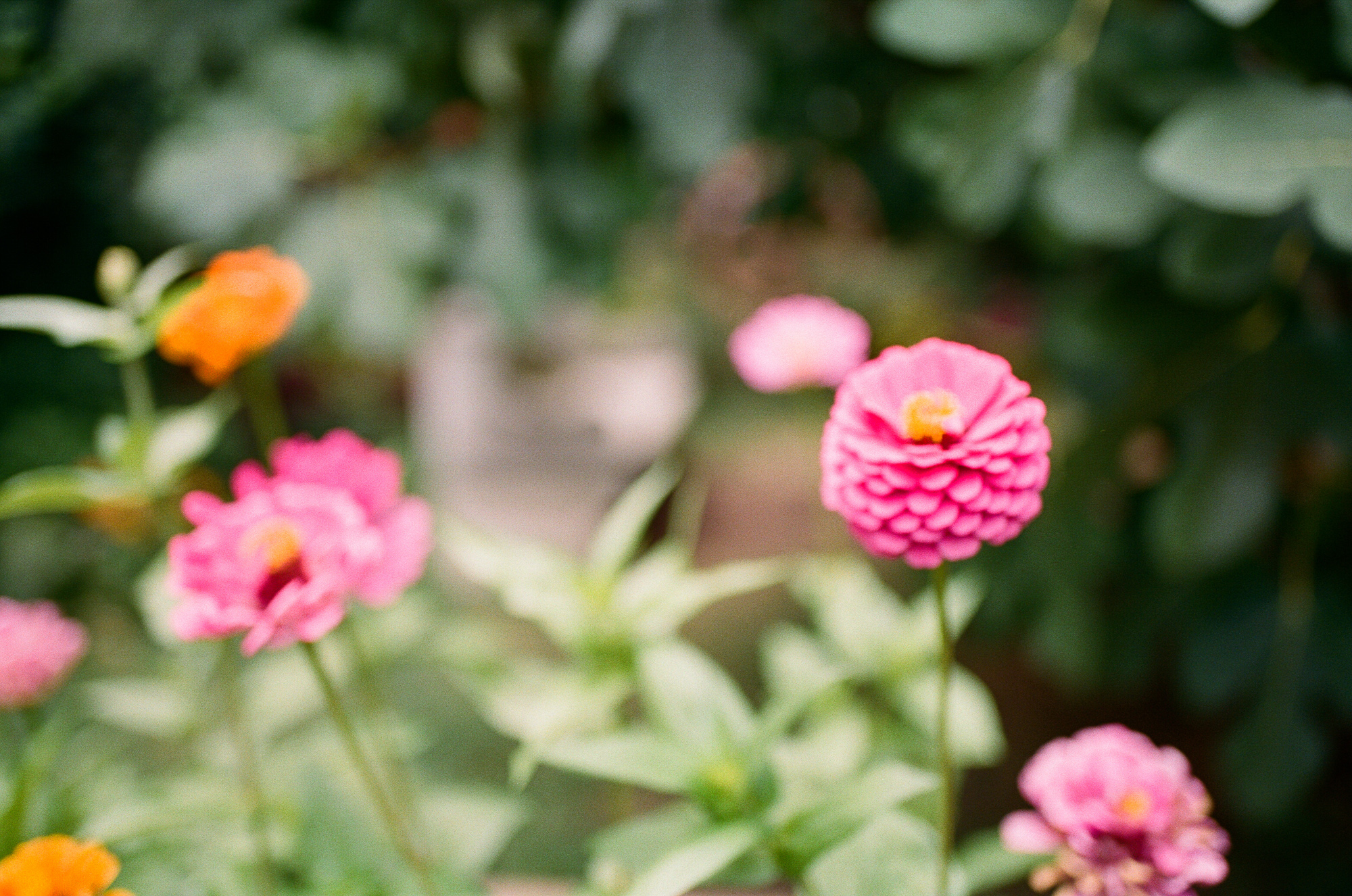

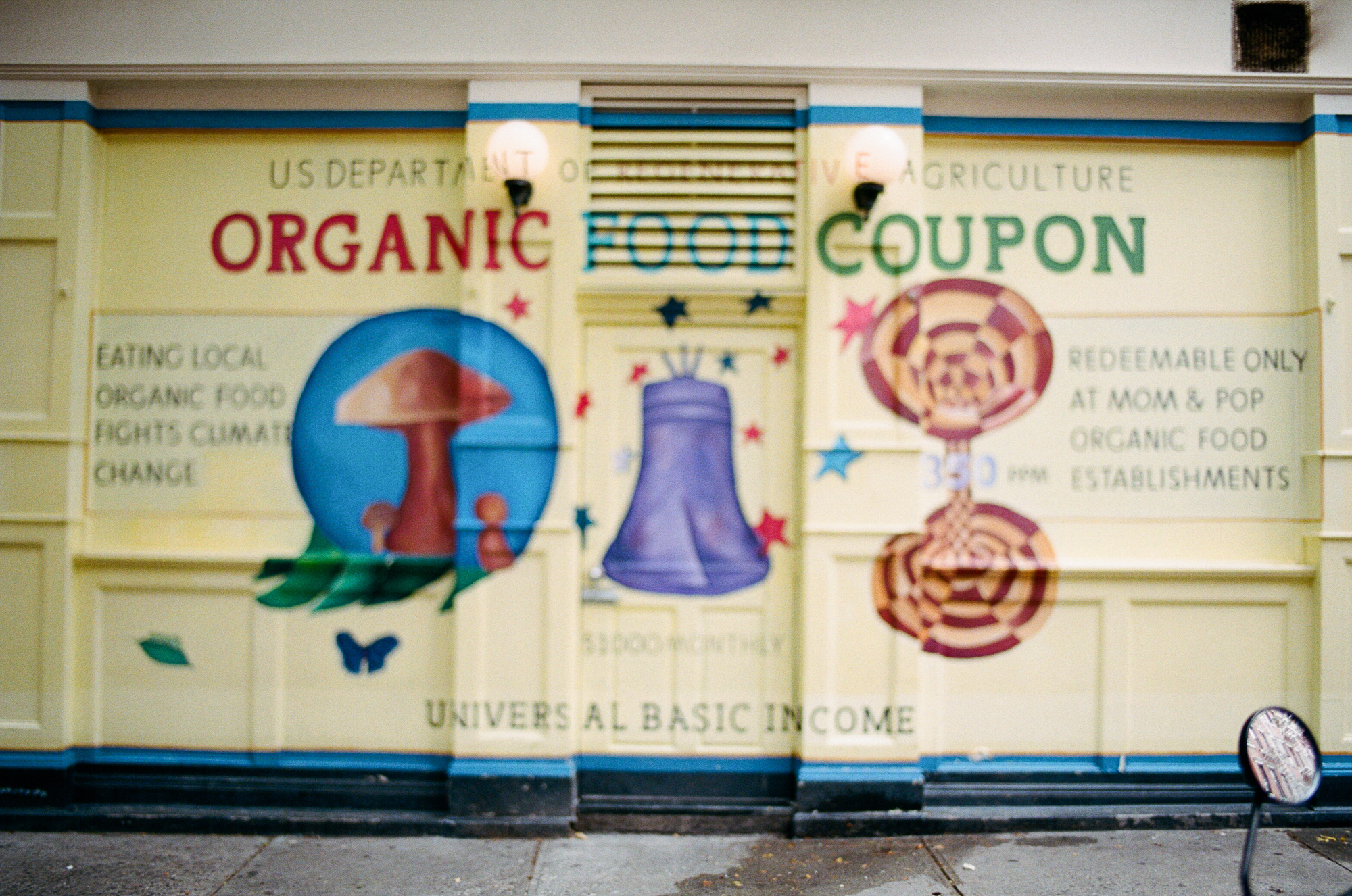

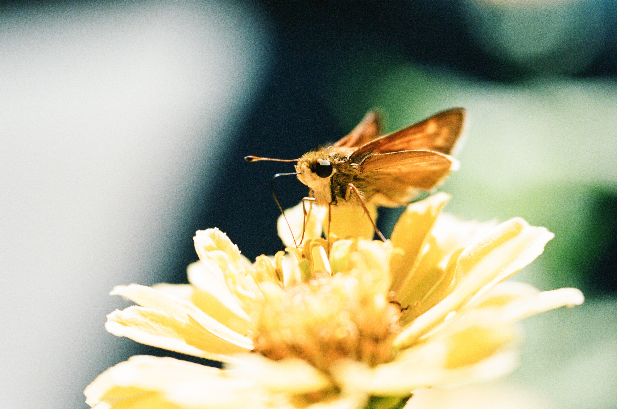

Finally, after a long summer, I got three rolls of film scans back! Such a long wait! So now the real questions begin.
As a refresher, I bought a used Nikon F100. It is in very good condition physically, and I doubt it was used much. For about 90% of my images I used my 35mm 1.8G lens. An awful lot of the images I took with this lens are front focused. Can a film body and lens be mis-calibrated like a digital camera? I'm willing to chalk a few images up to being OOF just due to being unfamiliar with the camera, or perhaps just forgetting to move the focus point and not paying attention. But not this many.....
A couple of images I used my Velvet 56 in manual focus and despite my old eyes looking through a tiny viewfinder, those images are bang on sharp. A couple of images I think I used my 105mm macro lens and those are also sharp, so it would seem to be a lens issue. My 35mm lens was always one of my sharpest lenses on my D700/D800 so it's suprising I would have issue with it on a film camera.
Here are some that are just outrageously soft/out of focus. These are with the 35mm.
This one you can see the very bottom flower is in focus, so obviously that lens somehow front focused.
This should have been a super easy one, but the back wall is OOF and that tiny rear view mirror is in focus (really well!); not the story I was going for.
This one was quite low light and pushing the ability of the camera (I took photos on my digital camera at the same time at ISO 1600), but again, the dock at the bottom is in focus.

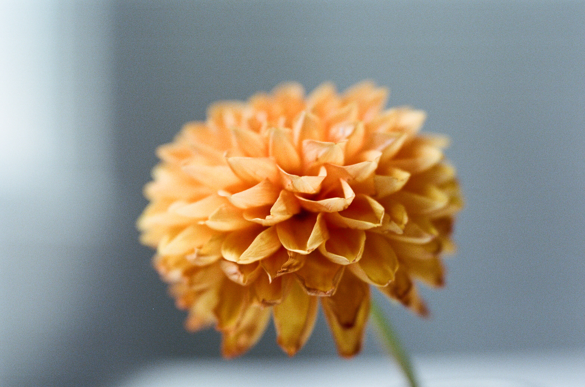

But then I have images like these:
35mm; focus is where I put it.
35mm; focus on the roses where I intended.
Velvet 56 I think, in perfect focus.
100mm macro lens. overexposed (that's a learning curve for me) but suitably sharp.
Any suggestions??
it’s extra disappointing because i shot film exclusively when we went to nyc and most of them are front focused. i had better luck with my beach photos, especially ones shot at a distance.
The front focused ones are bizarre.
I've never seen a film body that far off unless something crazy was going on like the mirror not being in position and the distance from the back of the mirror to the CCD(the focusing CCD at the bottom of the mirror box) being way off.
Also, given that the F100 has focus points nowhere close to the in-focus areas on the "missed" focus it's hard to believe that it's pocking that up.
What are your focus settings? Continuous or single shot? Focus priority or release priority? Tracking? Back button? I'm wondering if it's something wonky there.
Also, this would stump me even more, but can I assume the OOF ones looked in-focus after you let the camera AF?
Last thing, when you use an MF lens, or MF one of your 35mm lenses, does the electronic rangefinder show in focus when the image "looks" sharp?
