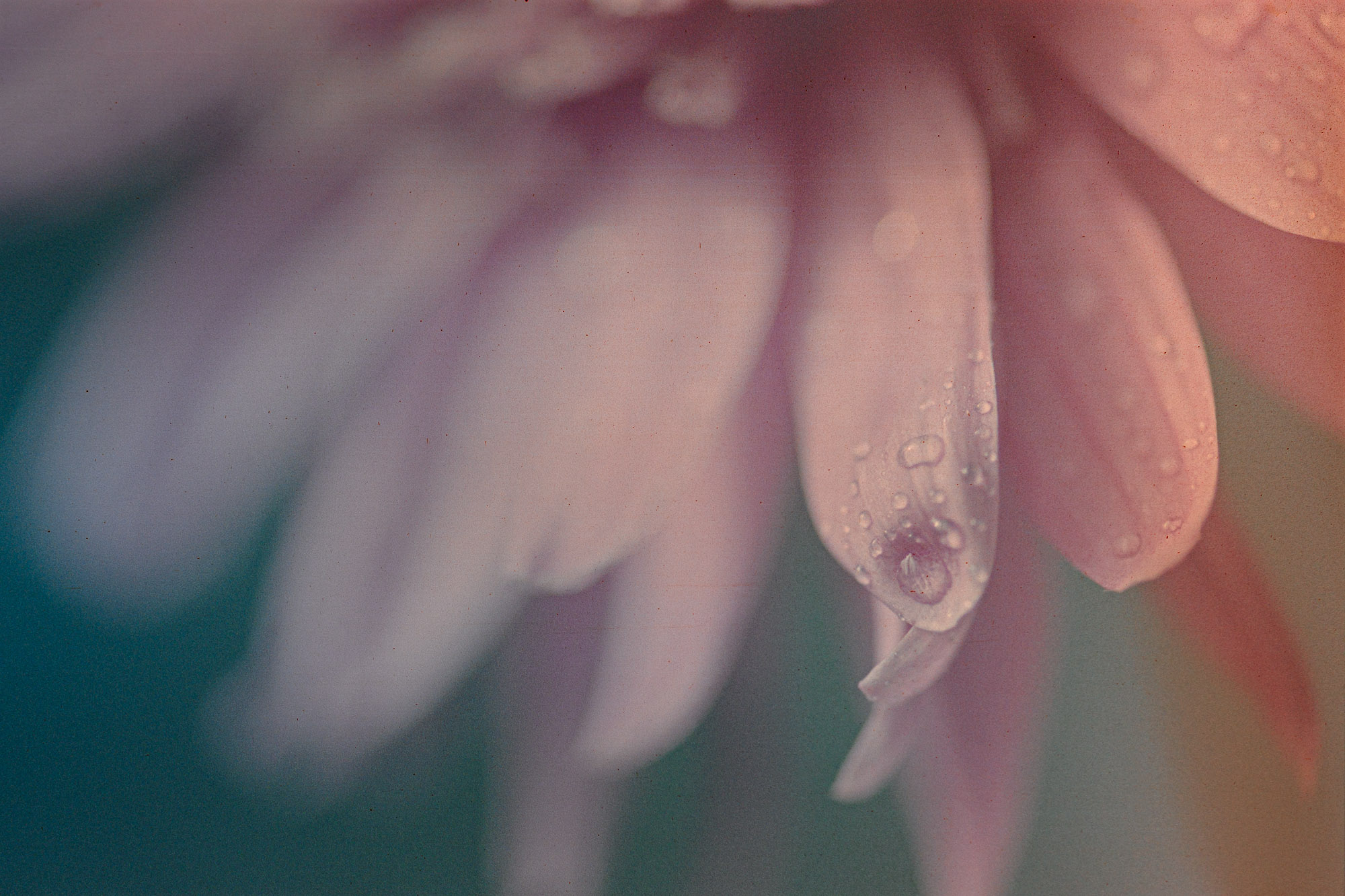

So I had a roll of Portra 400 and a roll of Fuji Superia Xtra 400 developed. I am working on camera scanning them myself. I know there is going to be a lot of trial and error to start and that I shouldn't get frustrated right off the bat (easier said than done).
I have film holders from Negative Supply Lab; they work really well and I have no issues with those. I am finding though that I have no idea how to set the camera exposure for the negatives, and the camera exposure plays a huge deal in the final image. I scanned the Portra 400 twice because there was a lot of lint/dust on the first scan, so I decided it would be easier to rescan (re-shoot) the roll and use a rocket blower before each frame than to manually clone out the dust. But I did the scans at two different times, and my second go round I had a brighter exposure and so have a lot more detail in the shadows. This of course is a good thing but I don't know how bright to make the camera exposure. Is there a way to tell? My brain can't convert the colors from negative to positive (although I did realize that since I am using the Snapbridge app on my phone for the shutter that I can put my entire phone screen in negative mode through accessibility and then I am viewing the negative as a positive on my phone).
I also bought Negative Lab Pro for LR to help with the negative to positive conversion and try to automate it. Does anyone here use it? I quickly discovered that I really can't use the same settings for different film brands (which is somewhat obvious) but I am having a hard time getting what I would say are "portra" colors. I'm sure I just need to experiment more but wondered if anyone was familiar with this.
My POTD today is from the Portra 400 and it just seems overly cool to me, even after trying to tweak colors and even color grade some, but it's also entirely possible that I'm not experienced enough to know what good colors are from film. I do love the grain though and the feel of the image.
I do have some Portra 400 from this summer that was lab scanned, and I might try camera scanning to to see how close I can get to the lab scan, but in the meantime I have to scan five rolls for my daughter and would love to find some decent auto settings for hers because she isn't nearly as picky as I am.
I will also say that I camera scanned them with the sprocket borders. I am wondering if I should crop those out before trying to convert n-->p.

I am not surprised that by trying to scan color negatives with a camera that your colors aren't coming out as expected. A lot of variables are coming into play which affect light and color balance. I wonder if working with color slides would be easier and more effective?
My film was lab developed, not home developed (Dominion Camera). I don't have slides to test and Dominion doesn't develop slides.
After some more research, I actually suspect my light pad is the issue and that I need a better one. I can probably make due with this one on a temporary basis but I think I need something more advanced.

Your POTD doesn't look terrible to me considering that Portra really isn't a super high saturation film. Don't forget too that the white balance is "baked in" to film and most is daylight balanced. If that photo is in the shade(it looks like it) it will be cool. Throw an 81A/81B/81C on your camera or, with negative film, just fix it in post. "Back in the day" you could actually get films with different color balances, although usually only slide film(typically tungsten balanced for use under studio hot lights, and then Kodak at least made a "warm" version of the E100 slide film called E100GX that was about like using an 81A filter all the time where E100G, the regular film, was a bit cool).
As for exposure-are you using your Z6? If so, I THINK the sensor is ISO-less so I'd just shoot in RAW, base ISO, reasonable shutter speed/aperture(keep it to 5.6 or f/8 to account for film flatness, but don't go too nuts as you don't want to kill it with diffraction). Assuming you're on a stable platform, I'd just, again, use say 1/125 at f/8 and base ISO, then fix in post to taste.
Also, don't forget that your baclight source is a big deal. Incandescent bulbs may be warm but essentially are perfect black body emitters with a full spectrum(gaussian distribution running from at least near IR and potentially flirting with UV if it's a halogen, and peaking right around the known color temp of the lamp). This is NOT necessarily a valid assumption for fluorescent or LED lamps. Best to either point it out the window or fire a strobe at it.

Yes I'm pretty sure my issue is my light pad. I bought my daughter a cheap one awhile back when she had to online art class (pandemic school). It's perfectly suitable for tracing and other craft type stuff, but I think the WB is really off on it, and probably it isn't bright enough. I was shooting at ISO 100, f/5.6, 1/30. Which is why I ended up using the camera app remote because I didn't think that pressing the shutter button at 1/30 was a very smart idea.
I do have two different strobes that I guess I could try. I just thought the light was supposed to come from behind the negative? I don't have an easy way of affixing the negative holder sideways to shoot straight on. Would be easier to buy a new light pad.
My flower was on a table just near a window, so technically shade, and our windows have UV stuff on them so they probably affect the color temperature a bit too. I will experiment a bit more and see if I can at least make the light pad brighter. I did wonder if that color is actually "correct" and just not what I like, but I did take a photo of my daughter and her friend inside a restaurant and those colors seemed fairly accurate.
Interestingly, the colors from the $35 Fuji camera with Xperia 400 seem better.
I know there are a lot of variables at play here, I just needed a bit of help to figure out what direction to go. I'm pretty sure it's not the software or the camera that's the issue (or even the actual negatives) but my light source.

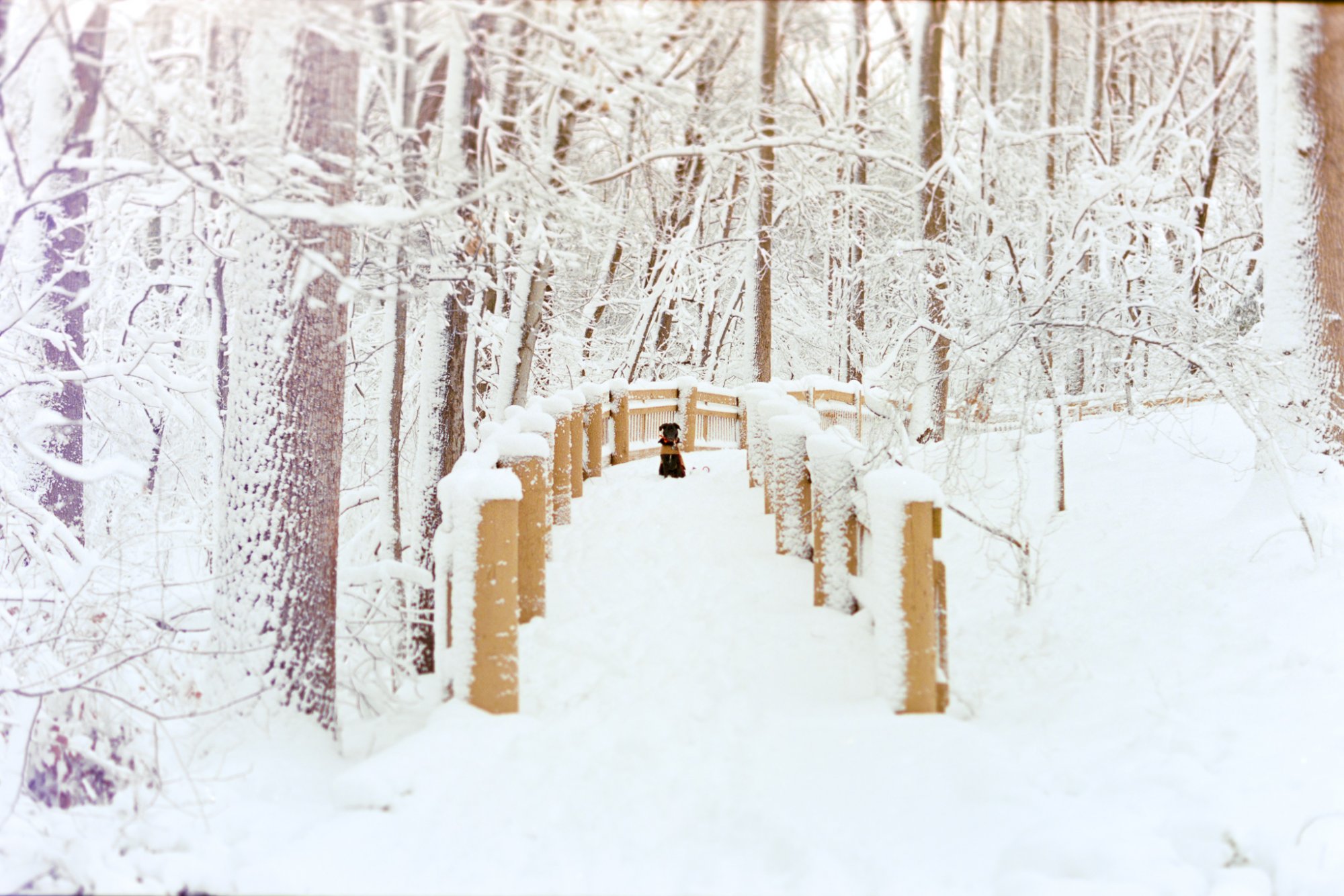

In the meantime, here is Fuji Superia Xtra 400 on the Fujica STX-1. These colors I love. I think it's just because it's outdoors.

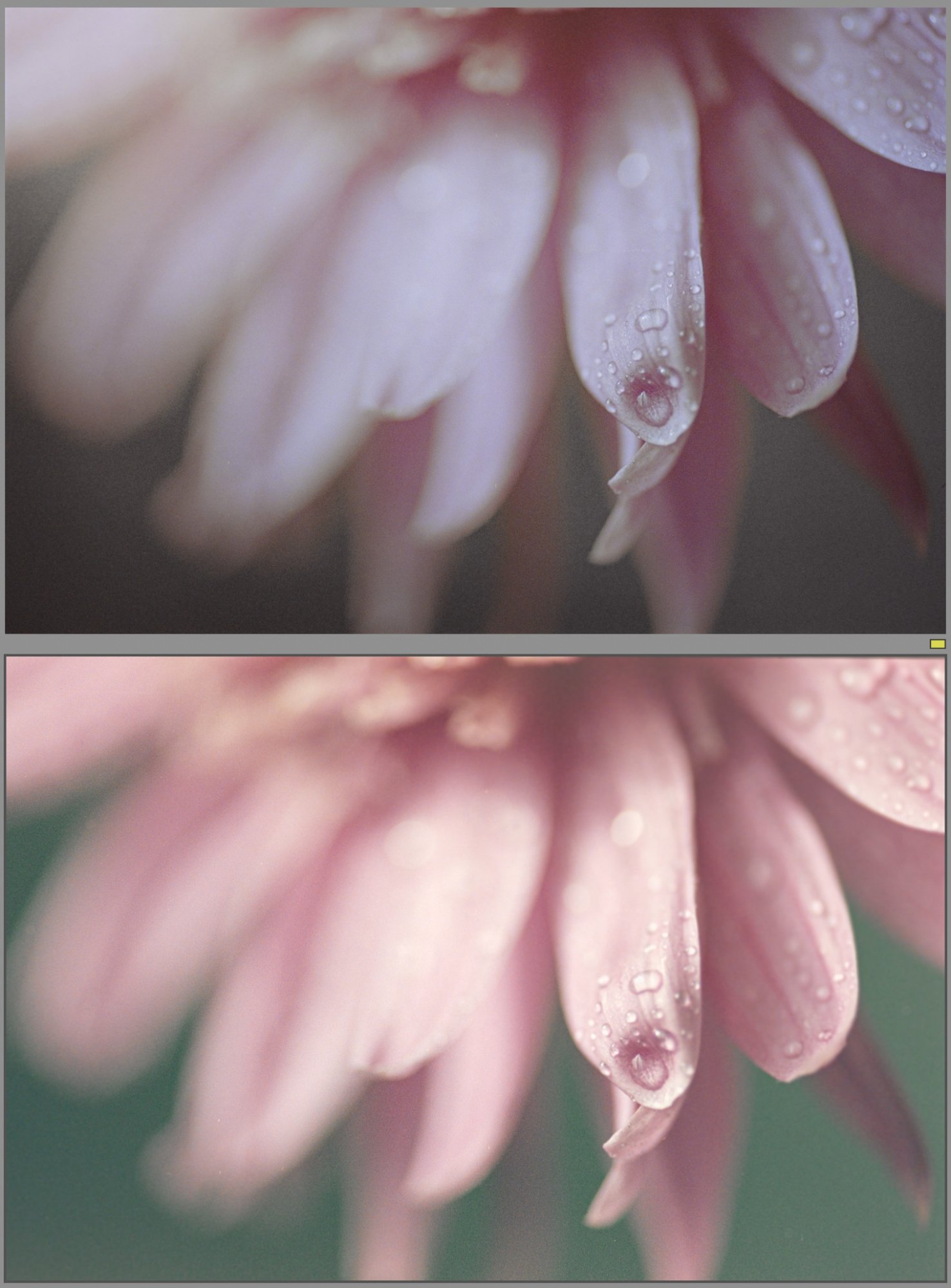

I'm getting closer. The top image is the POTD image and the bottom one is shooting into the strobe and different NLP settings. I'm not crazy about the green shadows, but the flower color is a lot better.

Yes, yesterday I learned about the CRI scale for lighting, and the one that dimme recommended 95+ which is pretty good for the price.
