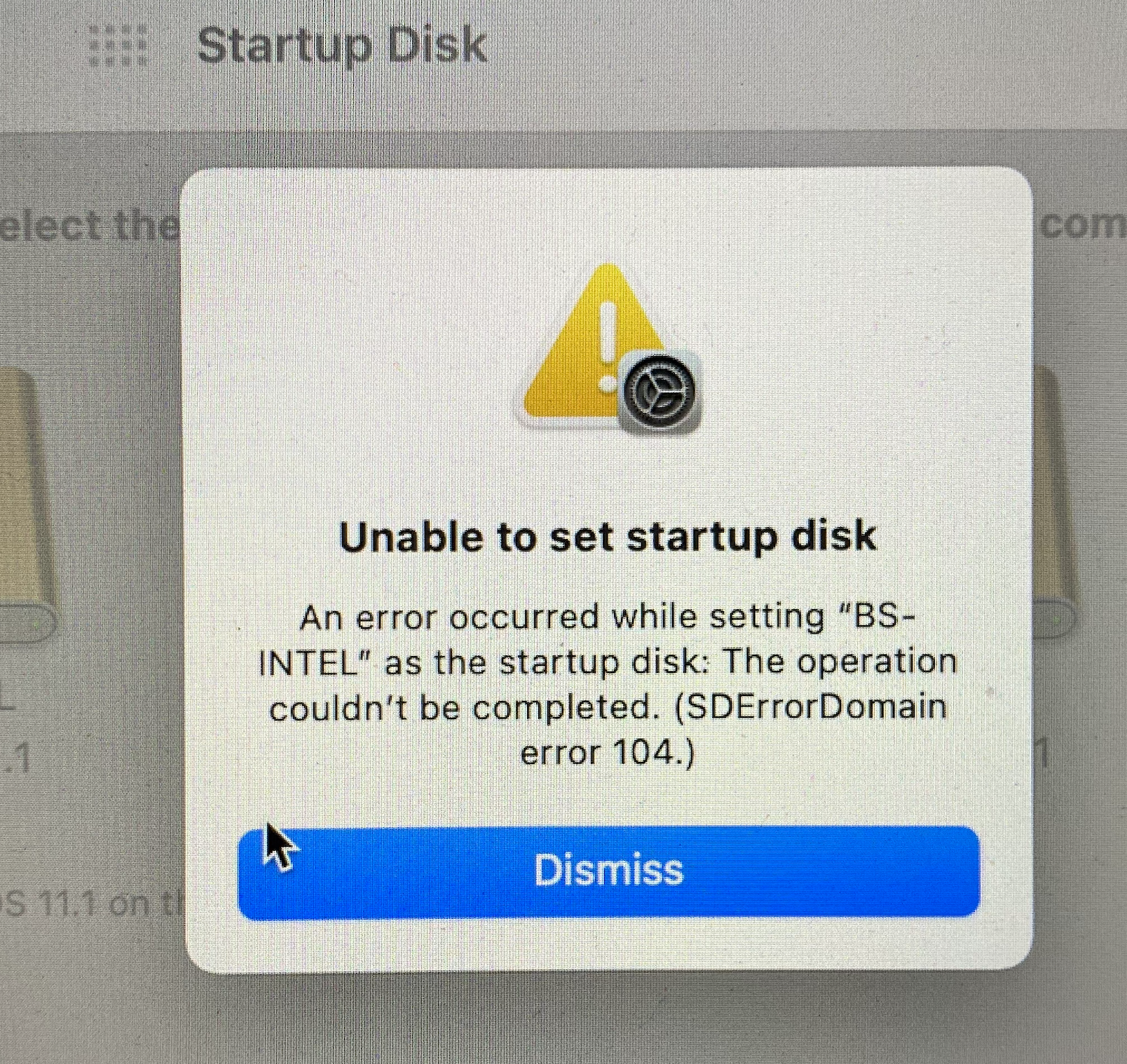

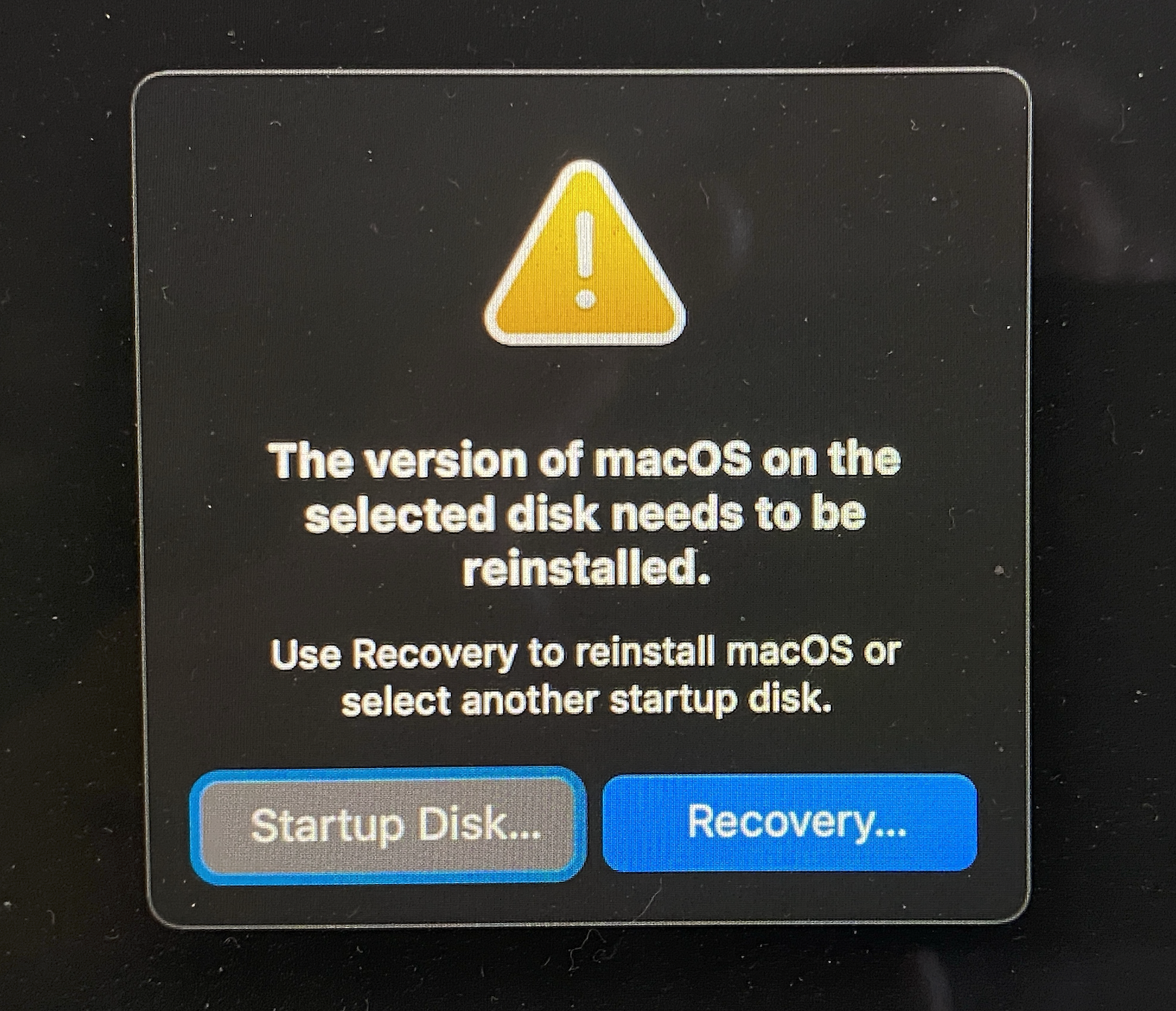

No, a Big Sur installation created on an Intel Mac will not boot an M1 Mac.
I just did a fresh install of 11.1 release from Recovery, onto a new volume on an external Samsung T5, all done on my Intel iMac.
This volume will not boot my M1 MacBook Air, either from Startup Disk pref pane or Options Boot.
From Startup Disk I get this:

From Options Boot I get this:

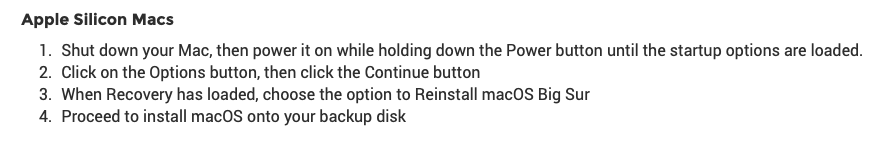

I think this was one of my first mistakes, assuming that they were compatible.
If true, then my new backup should work with the M1.
