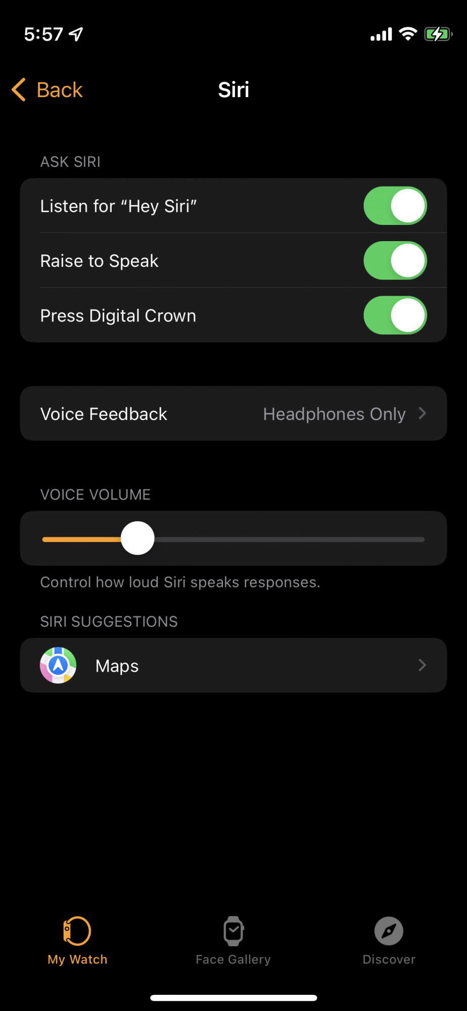

On iPhone > Watch App Siri. Check enabled and volume.

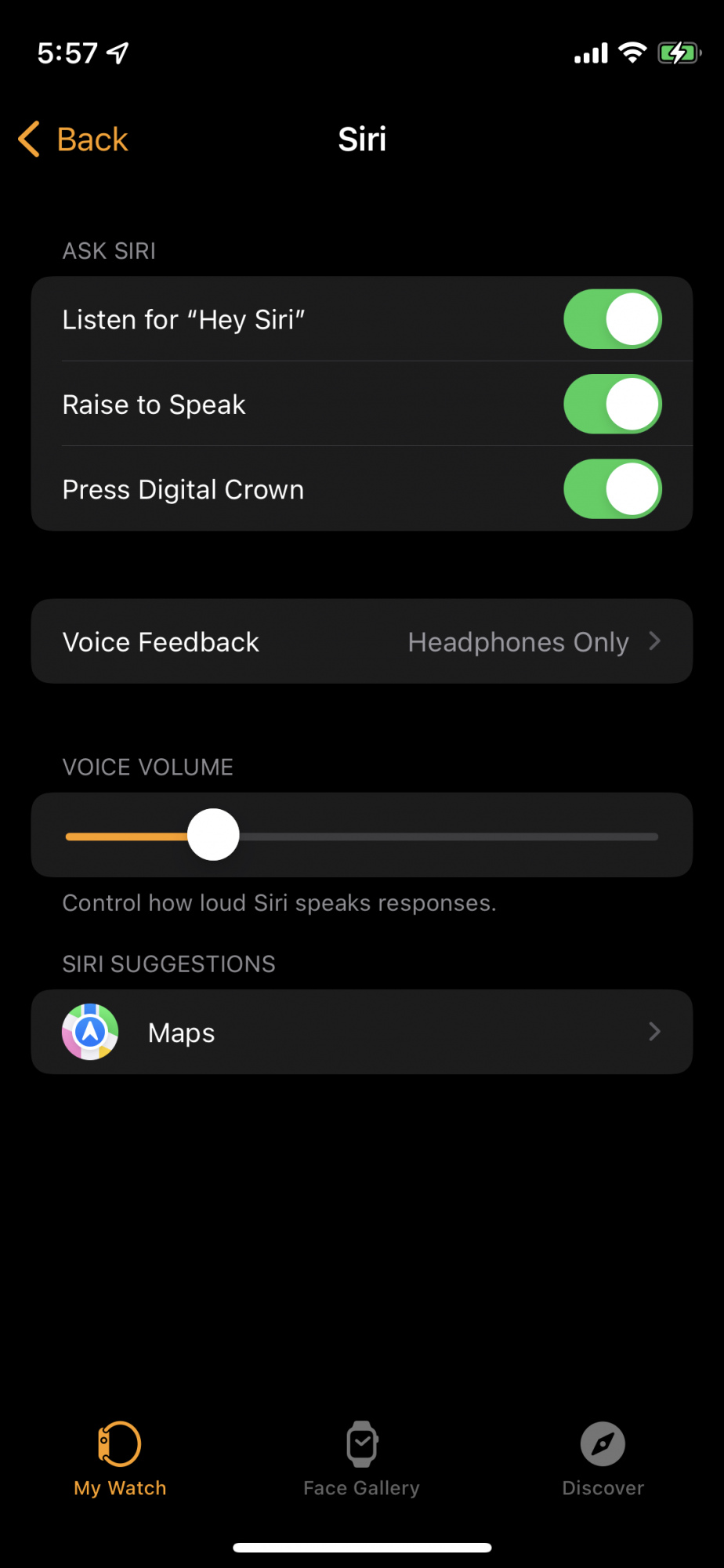

Also is AirPod Pro’s connect to iPhone just before your walks and is iPhone with you?
When I’m at the gym my home arts locked in locker, I switch Apple Music to my AirPod Pro’s, I don’t notice Siri mentions as I’m out of Bluetooth & Wi-Fi range. When I head back to locker & in range any pending notifications I do get. Maybe it’s just Wi-Fi & Bluetooth?
Honestly I think you’ve found a bug n have submitted.
