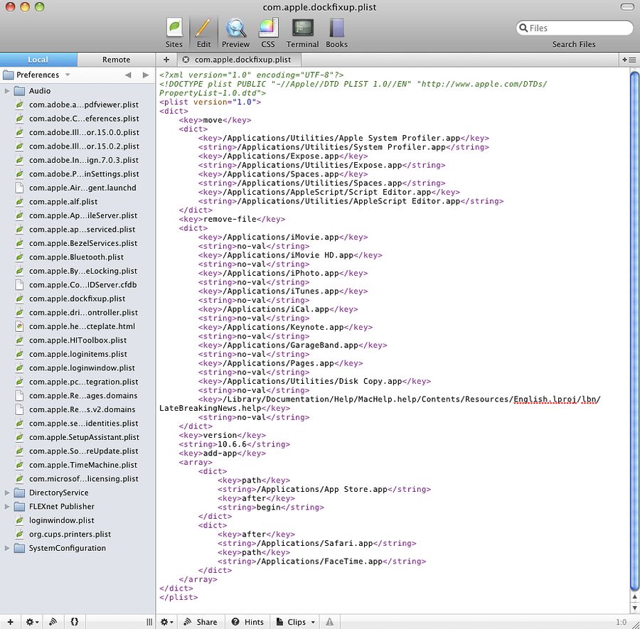

Look for /Library/Preferences/com.apple.dockfixup.plist and rename it. Then, remove the App Store icon from your Dock. It should stay gone this time, even after you reboot.

Content of com.apple.dockfixup.plist:
move = {
"/Applications/Utilities/Apple System Profiler.app" = "/Applications/Utilities/System Profiler.app";
"/Applications/Expose.app" = "/Applications/Utilities/Expose.app";
"/Applications/Spaces.app" = "/Applications/Utilities/Spaces.app";
"/Applications/AppleScript/Script Editor.app" = "/Applications/Utilities/AppleScript Editor.app";
"remove-file" = {
"/Applications/iMovie.app" = "no-val";
"/Applications/iMovie HD.app" = "no-val";
"/Applications/iPhoto.app" = "no-val";
"/Applications/iTunes.app" = "no-val";
"/Applications/iCal.app" = "no-val";
"/Applications/Keynote.app" = "no-val";
"/Applications/GarageBand.app" = "no-val";
"/Applications/Pages.app" = "no-val";
"/Applications/Utilities/Disk Copy.app" = "no-val";
"/Library/Documentation/Help/MacHelp.help/Contents/Resources/English.lproj/lbn/LateBreakingNews.help" = "no-val";
version = "10.6.6";
"add-app" = (
path = "/Applications/App Store.app";
after = begin;

Bought the new 15" Macbook Pro and had the same problem. This time, along with the Mac App Store icon, I had the Facetime icon persist even after removing it from the doc.
I followed JeremyLC's instructions and it took care of the problem. For people interested, Im attaching a screen shot of the offending plist.
You can see towards the bottom of the plist, where the doc is instructed to add the mac app store icon and facetime icon to the doc.
