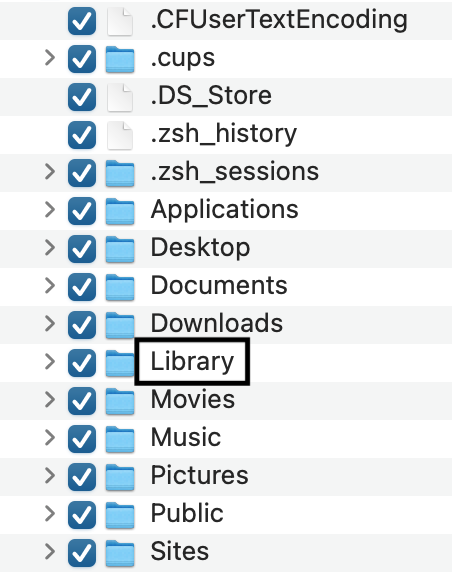

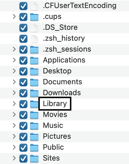

When I restored from a CCC snapshot, inside "task filter", under my account, there is a "Library" folder. There is no such folder on the data volume, CCC backup or on Time Machine backup.
Could someone please help to explain what is this Library folder?
You are just seeing a hidden system files related folder in CCC's volume hierarchy. CCC shows all hidden folders that MacOS hides by default.
  • Click on Finder Icon > select the Go tab in top-menu bar and click on Go to Folder… option in the drop-down menu.
  • In Go to Folder window, type ~/Library, and click on the Go button.
  • This will immediately take you to the Library Folder on your Mac.
  • In addition to the Library Folder located at top-level, macOS creates an additional Library Folder for every User Account on the computer.
  • The User Level Library Folder on Mac contains multiple system files that store settings, preferences and other data for various Apps and Programs on the Mac.
