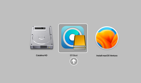

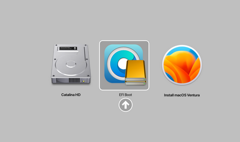

Success after all, boots properly! Realized that the mistake I had been making was to bypass the EFI Boot option at the boot picker and go directly to the bootable destination disk. Instead, after checking that everything needed to boot was where it belonged at the destination, restarted, but first selected the EFI Boot option (what I always do to get to the "ordinary" Ventura startup disk), then selected the bootable volume.
Was this effectively what you meant?
Screenshot from https://dortania.github.io/OpenCore-Legacy-Patcher/BOOT.html

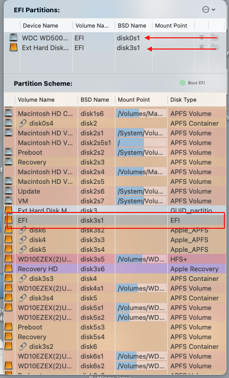

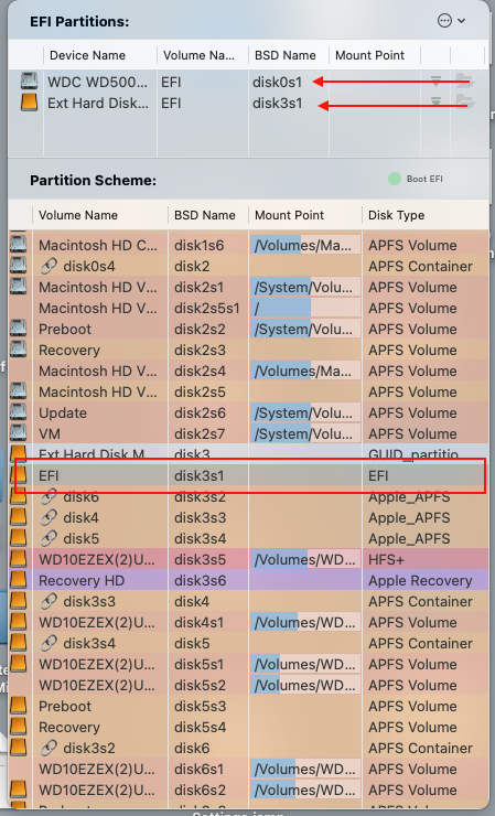

Thanks, and btw, discovered very useful EFI utility, which displays and can mount the EFI partition.EFI Agent EFI Internal:External copy.png
Also second step to eliminate boot picker not really necessary. Simply building to disk on the external to get the EFI to load appears to be sufficient to enable bootability.
