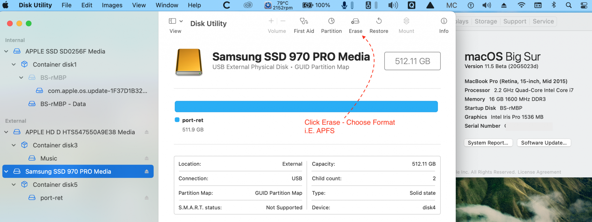

You will probably get many different opinions - I have been for formatting all my drives to APFS (non encrypted) since Mojave - if you have older Mac's that you wish to connect the external to if may be worth considering "MAC OS Extended Journaled"
Here is a screen shot with an external SSD and and External HD both are formatted APFS and work fine with Big Sur and with Mojave macOS
  • Love
Reactions: camelia
My MBP comes with and SSD, but my External is an spinning Hard Disk, If my External were
SSD then the format will be APFS instead of Mac OS extended journaled right?
Just curios
Thanks
Camelia
CCC advised me to apply APFS everywhere. There will be a reason for it.
