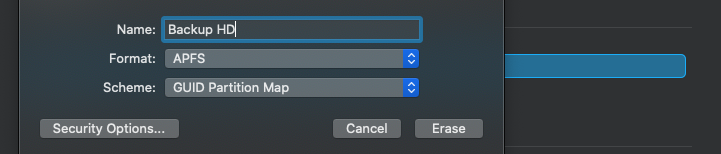

Hello
Formation this way?
This external HDD is exclusive for macOS Catalina, in a near future I will upgrade to macOS Big Sur, will I need to buy another external Drive to Backup macOS Big Sur?
Thanks

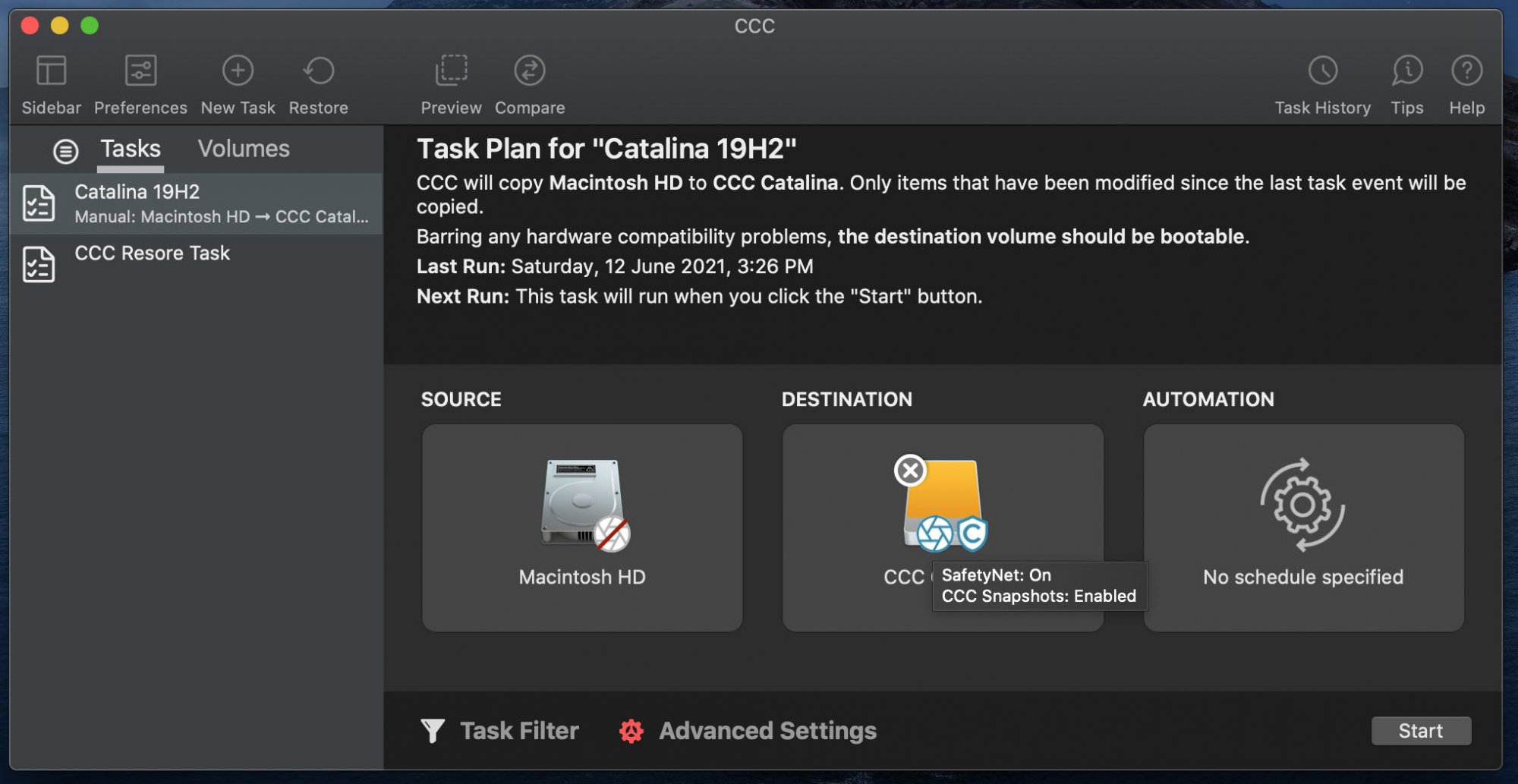

I have Snapshots enabled as well as backup verification.
Hello @Apple_Robert it is me again 🤪🤪🤪
Do you have Snapshots enabled in both Source (Macintosh HD) AND Destination (External Drive)?
Is backup verification under the tab PostFlight?

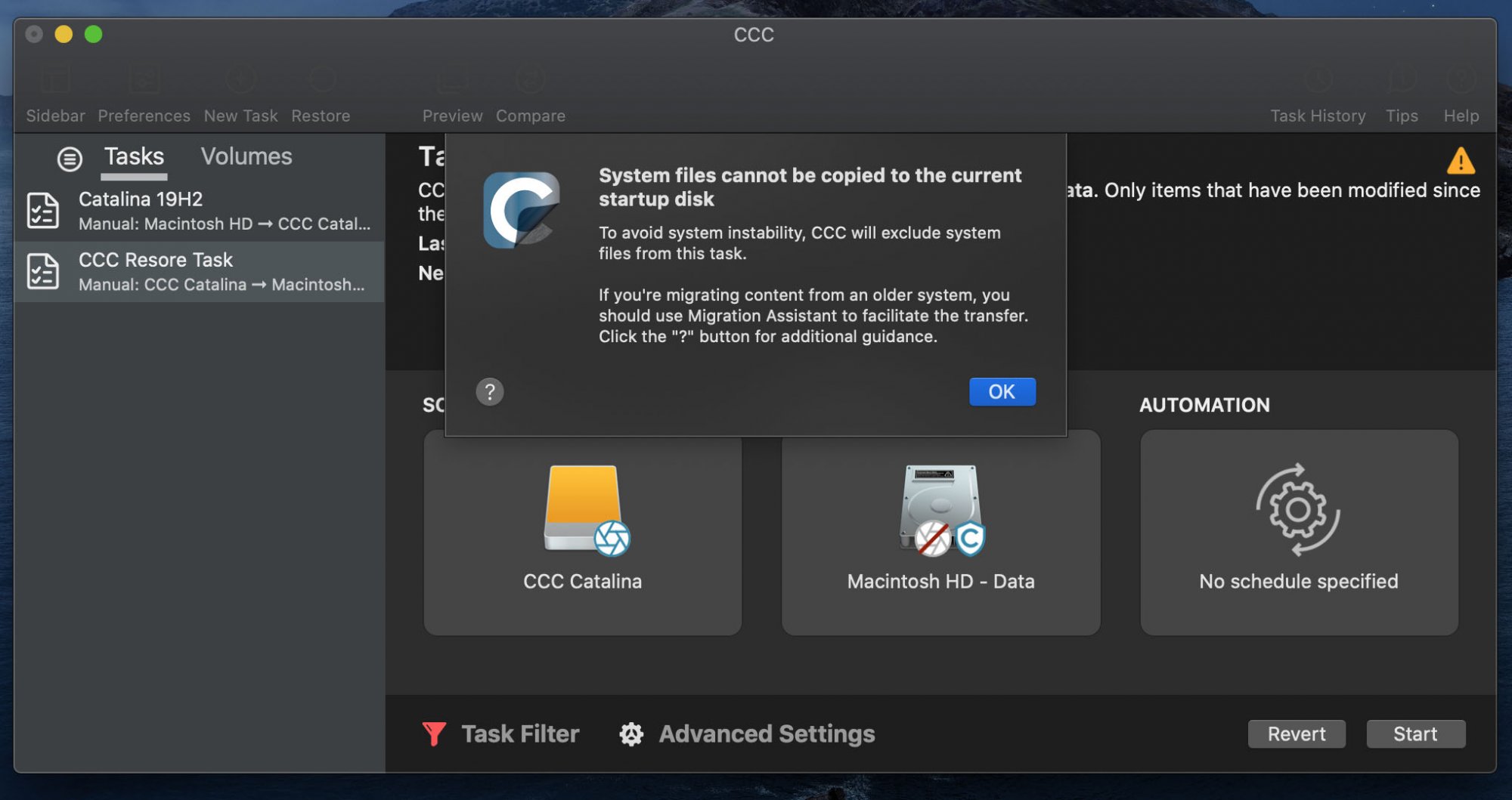

For macOS Catalina
What I want is at some point to return to the clean install I did (19H2), no security updates, no apps
(I do not know if it is a good idea or possible with version 6.x)
I remember before was possible
Maybe choosing in Source the "External media" and in the Destination "Macintosh HD"?
Because "Select Startup Disk on Desktop" is not working :eek:
What are my options?
Thanks

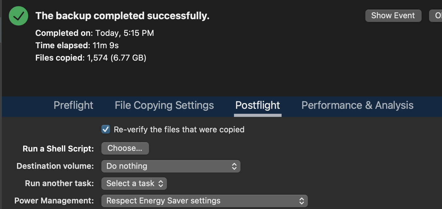

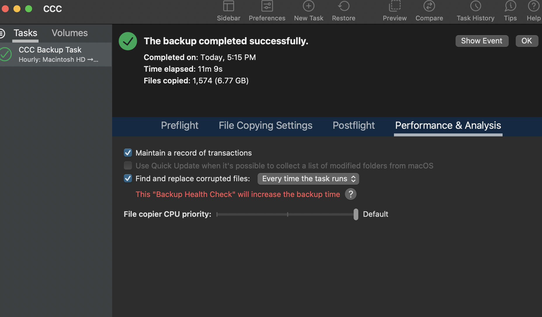

You want the source for the backup to be Macintosh HD and the destination to be your external drive. Make sure you have the drive selected. CCC usually picks the correct drive when you are setting up a new task.
As to verifying the backup each time, you are correct. It is user Postflight. I also use the other open of "finding and replacing corrupt files from a backup. That is another preference. I can't speak to how well it works as I haven't tested it, yet.
The two screen shots are pics of both options enabled.
With snapshots off, CCC will retain as many backups as your external drive allows. With Snapshots on, you would have to make sure to edit the default rentention parameters to something you want if the default doesn't agree with you.

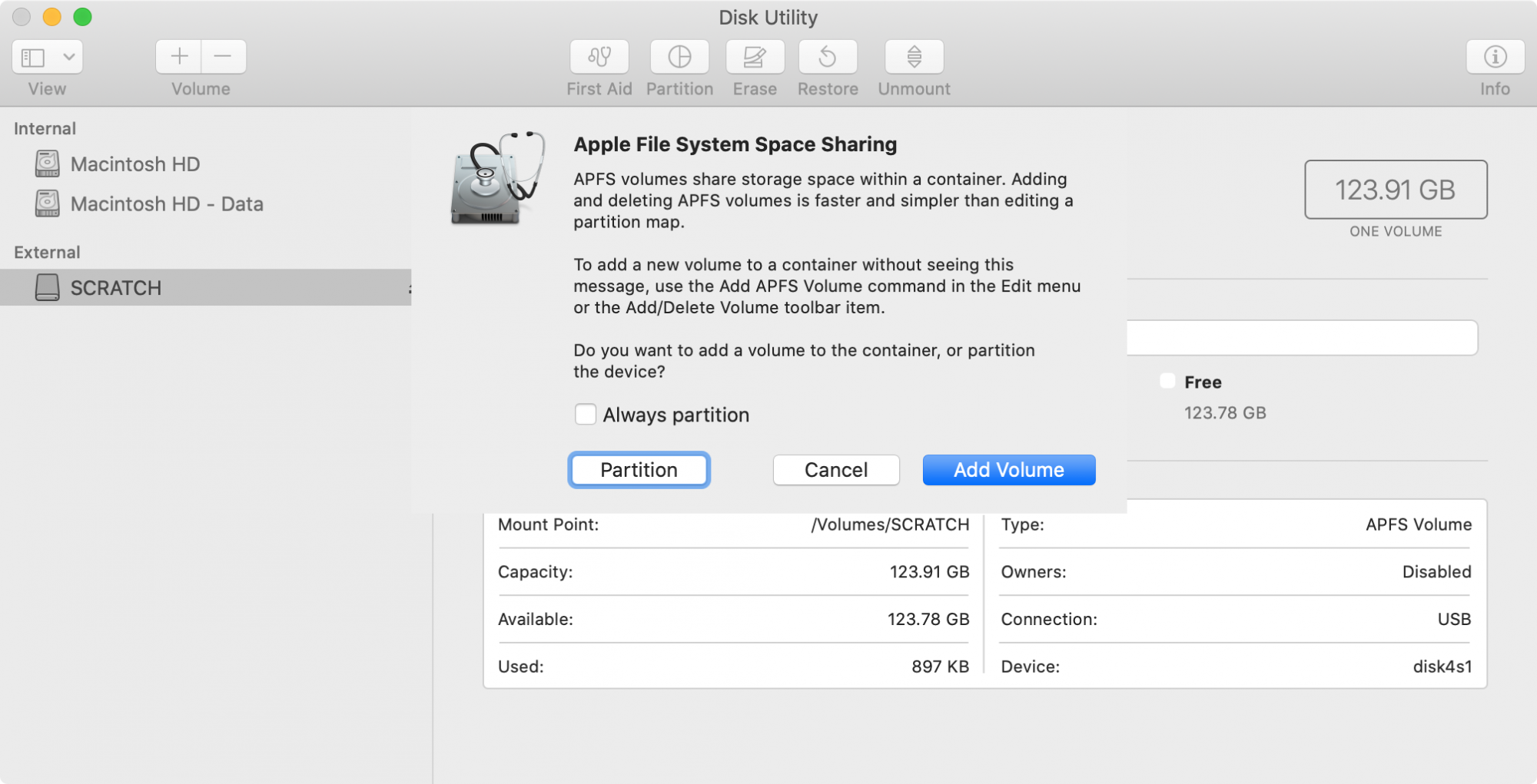

I use APFS on my SSDs and HDDs. Space sharing APFS volumes are just so darned convenient. Two of my drives are 5TB 2.5" bus powered spinners and I have not noticed any problems.
There is one big gotcha with APFS volumes. Many disk repair utilities have problems with APFS volumes, such as Disk Warrior or Techtool Pro. They cannot rebuild a corrupted volume. The more APFS backup disks you have, the greater the risk that you can lose data. Lost a TM disk just this last week due to a hardware failure, but had 3 other TM backups available so I was OK.
