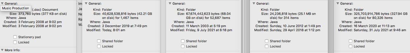

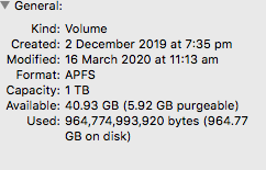

** Now onto my 870 EVO m.2 in my kryo PCIE slot. Because this is my main work drive. That is all my Pro Tools sessions run from this. I had to free up a few hundred gigs from it. Files/folders have bveen deleted but the space does not show as available.
See below the disk in question.
Shows 40 odd Gig available but when I inspect each folder they add up to around 435Gig
Ive repaired the disk with disk utility and turned Trim on.
Any one have any idea what might be causing this?
Your free space should appear after about 3 days.
It will be held up in TM snapshots.
Reactions: kings79
Hopefully this is the issue.
I experienced this when moving data to a different drive.
I have TechTool Pro, which shows the snapshots and sizes, and the default is to delete after 3 days.
If you only moved x amount one day, then more another day, then only a portion of the space would appear after 3 days.
Reactions: kings79

Think your right man. Some has come back today.

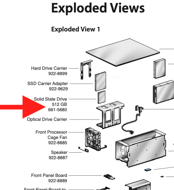

Ahn? Apple never supported SATA SSDs?
Don't tell that for all 2010 to 2012 (maybe even later since some iMacs had SATA drives much later and Apple offered SATA SSDs as a BTO) Macs that were sold with SATA SSDs - from the 2010 Mac Pro to 2012 MBPs.
