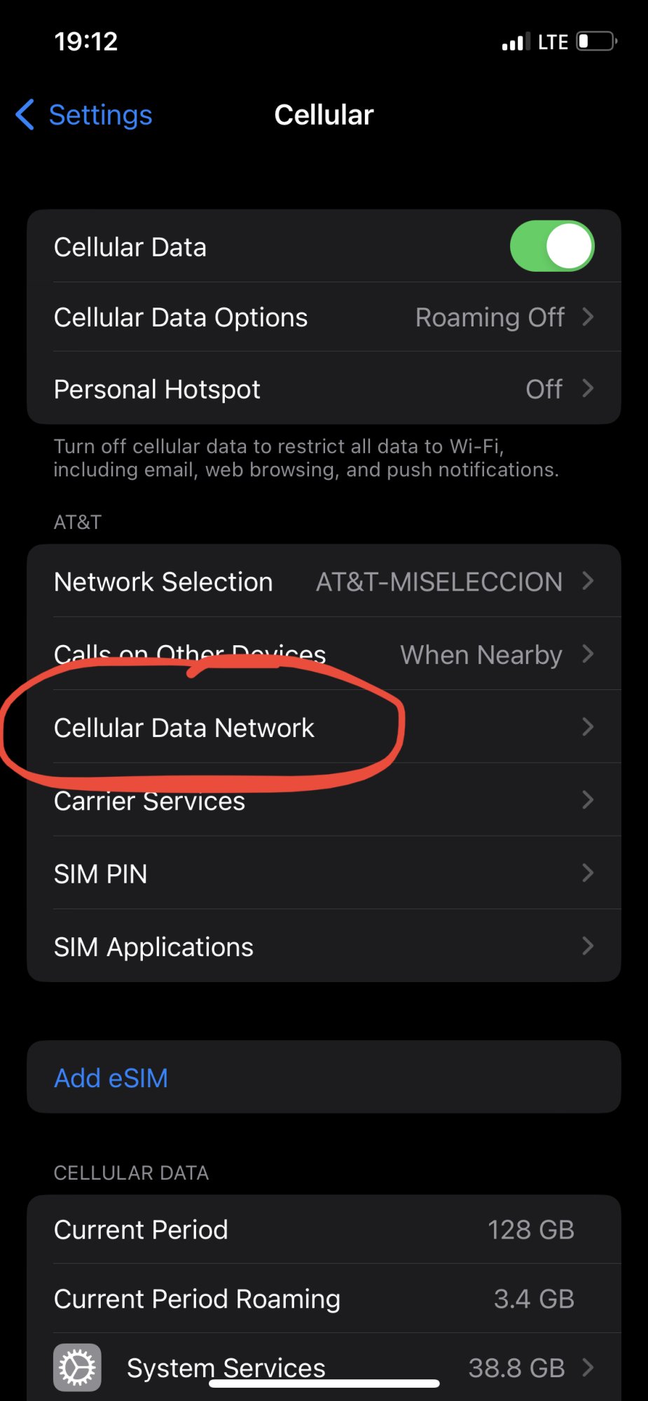

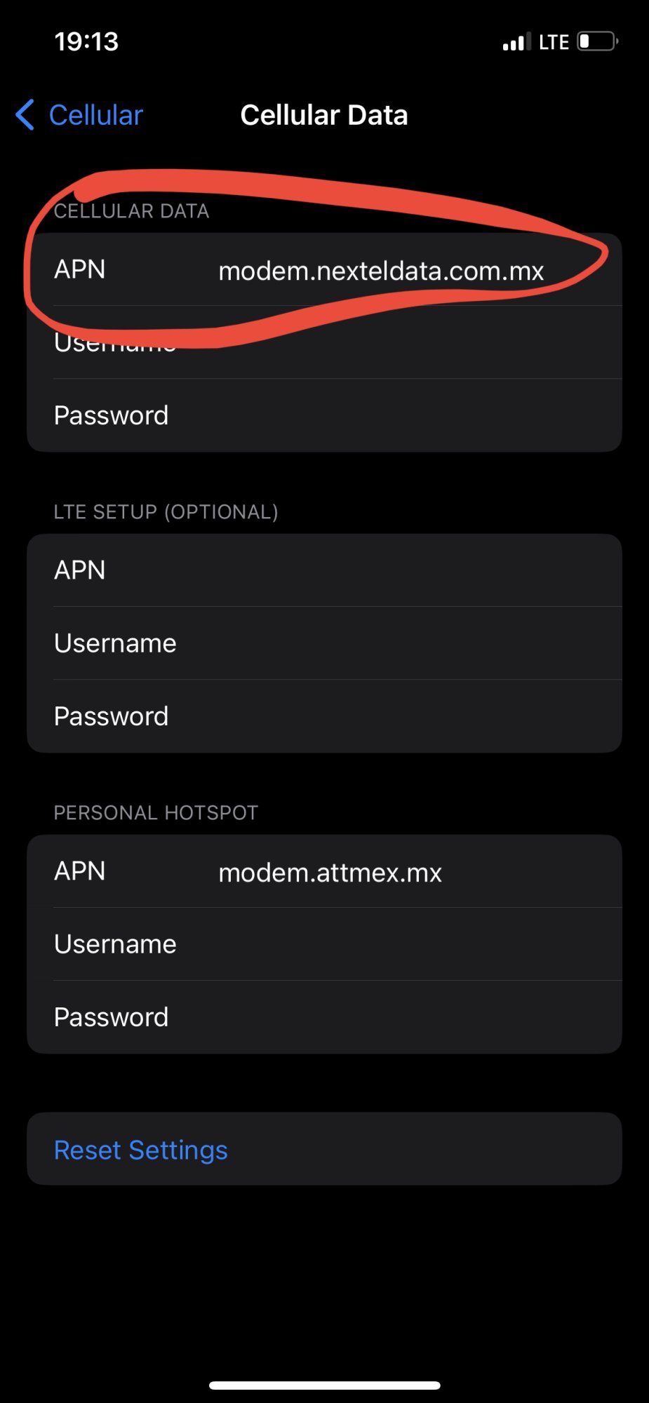

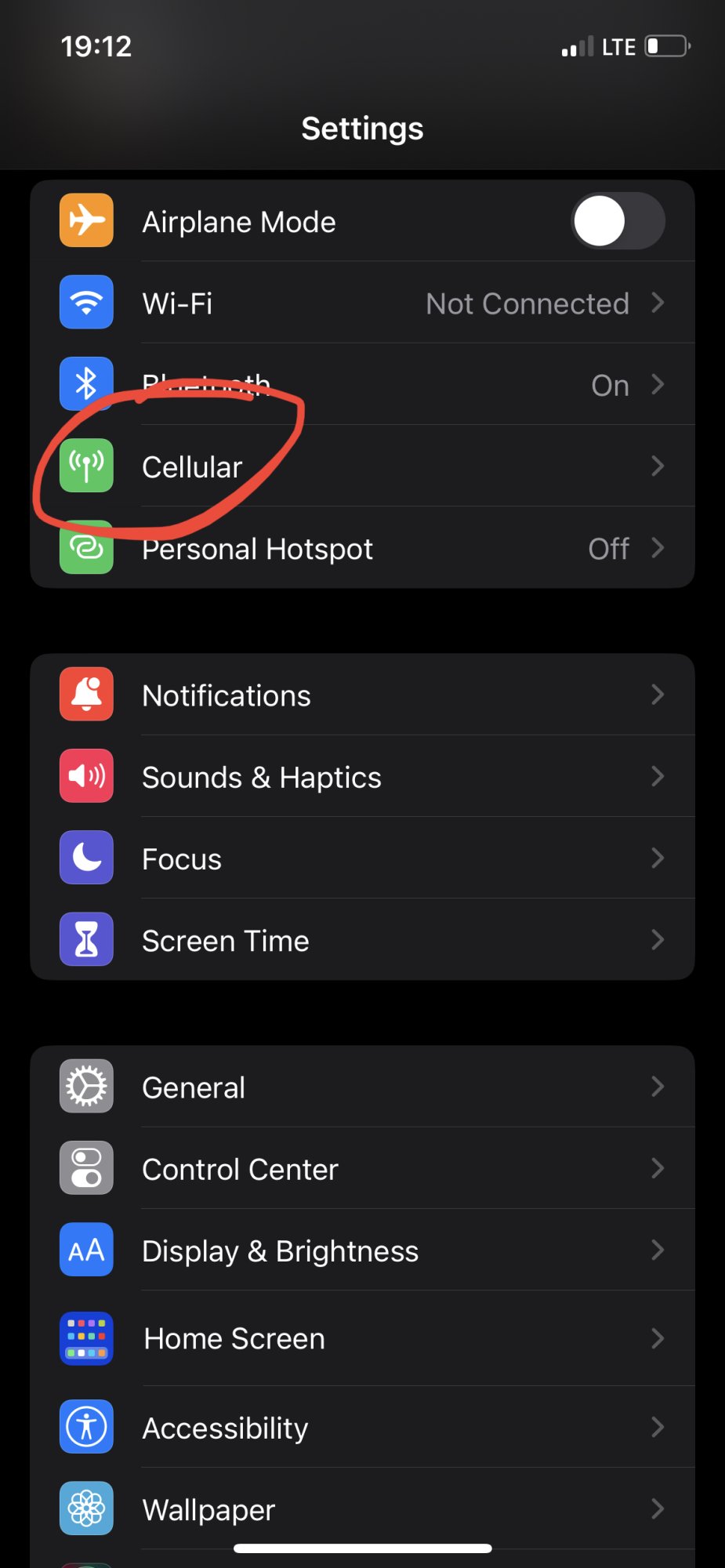

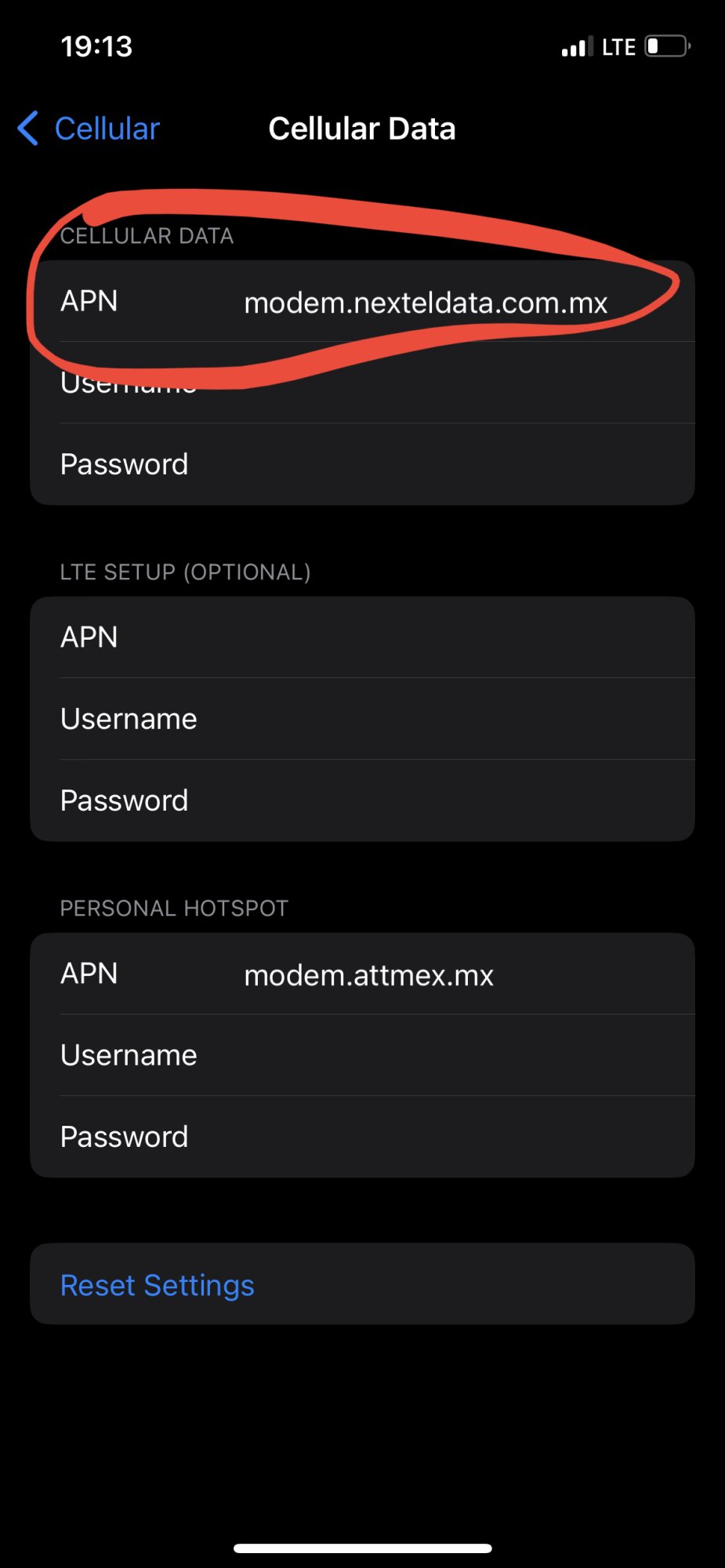

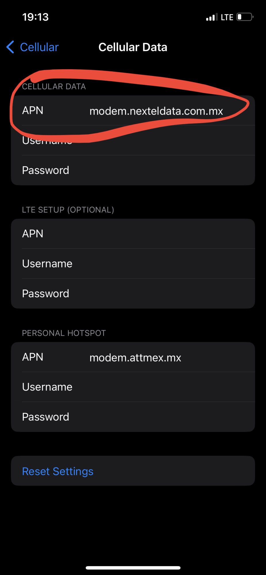

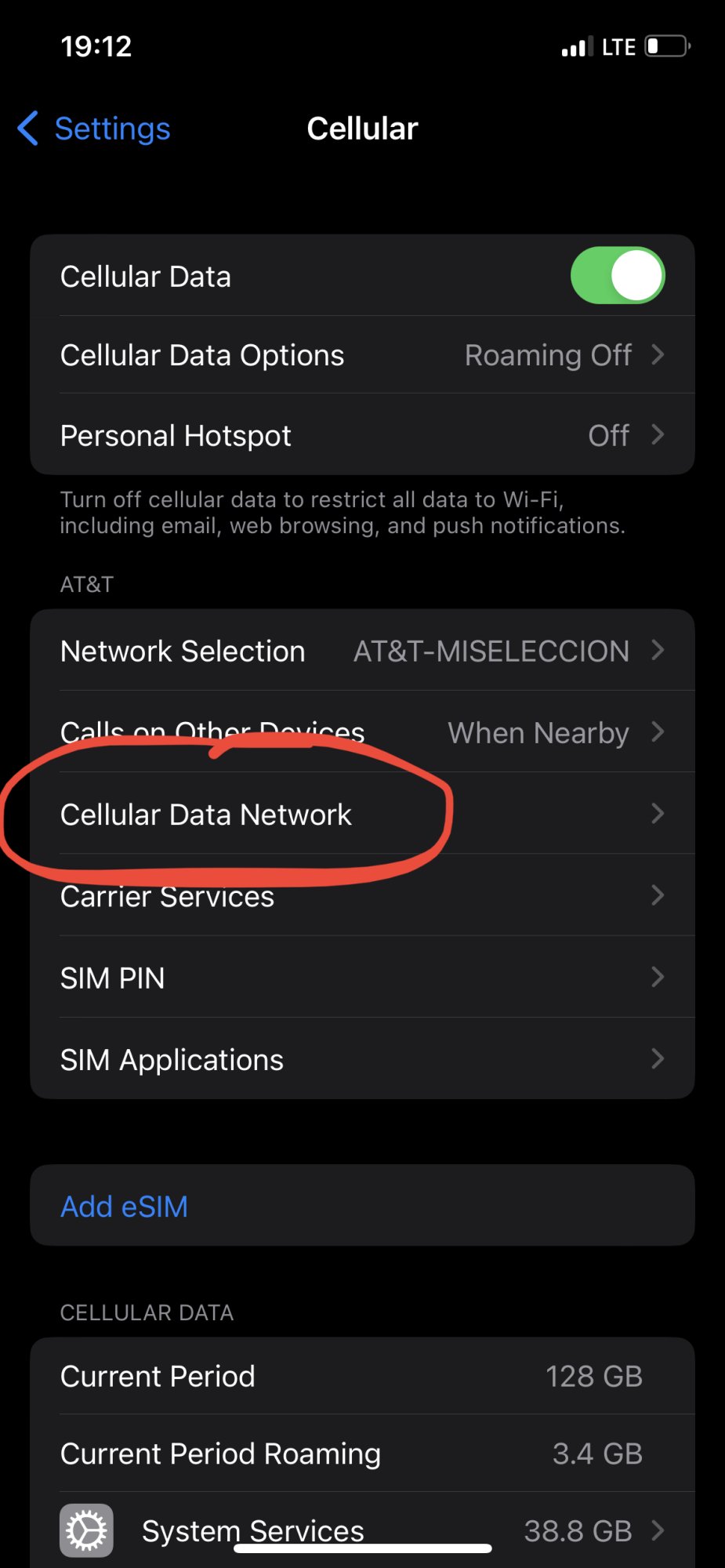

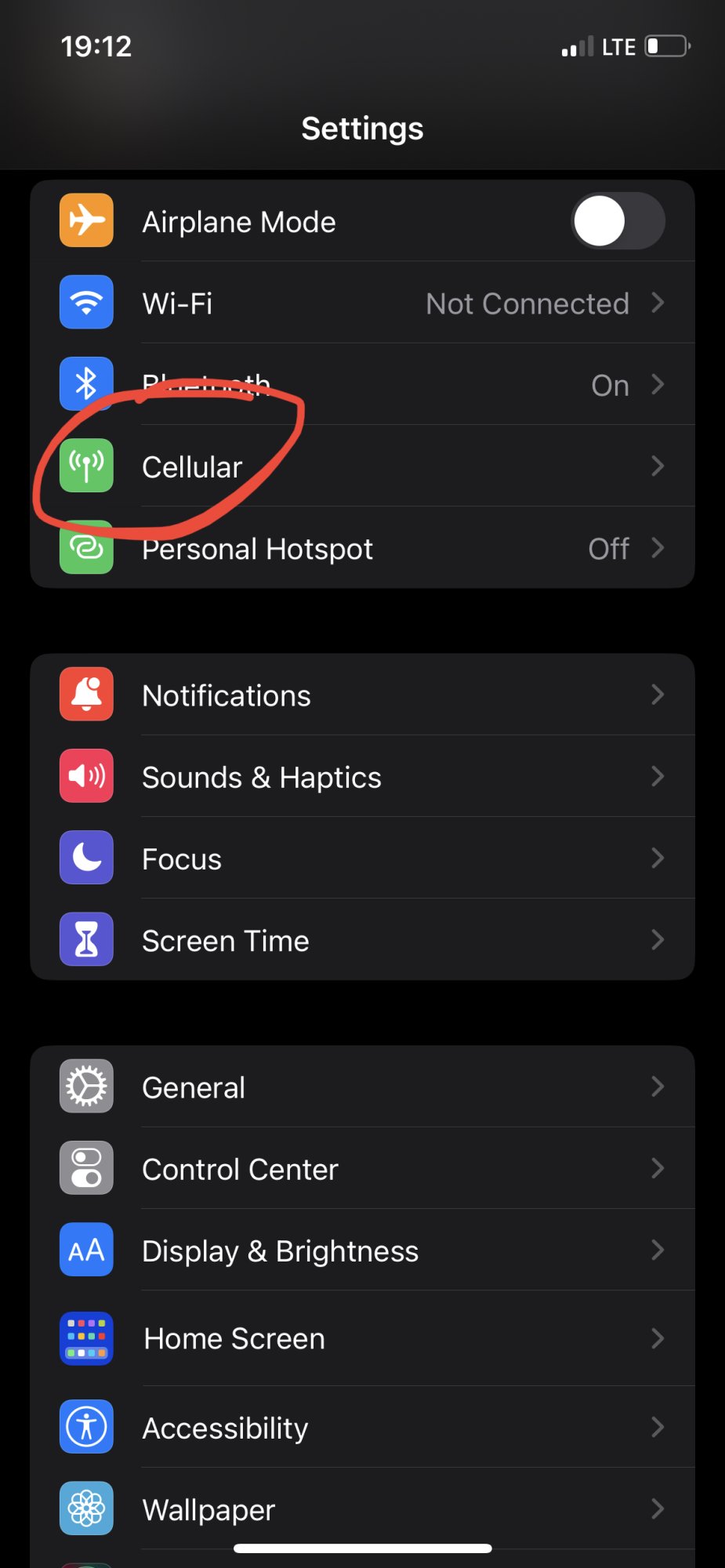

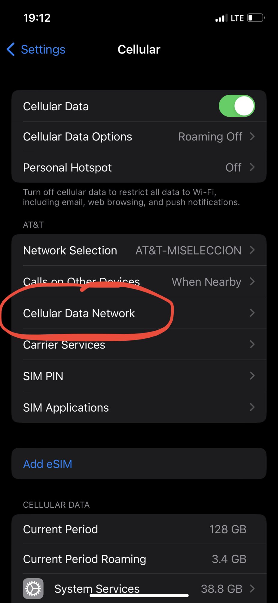

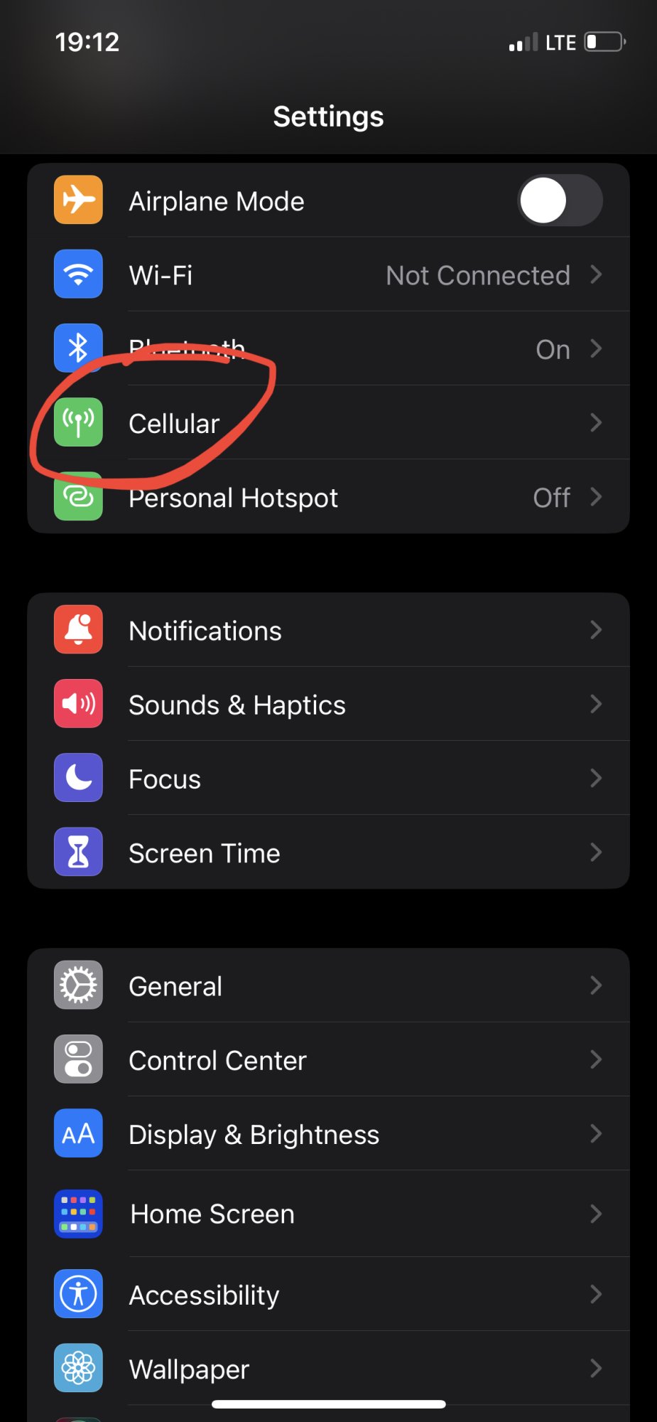

Can you explain to me how you did it? I have the same problem with AT&T MX
Of course, of course 🙂
LOL
There you go the screen shots.
If your APN is web.5g.attmex.mx you just have to remove the 5g and leave it in web.attmex.mx
In the photos I used another APN that was modem.nexteldata.com.mx that still worked for me.
I hope it works for you 🙂

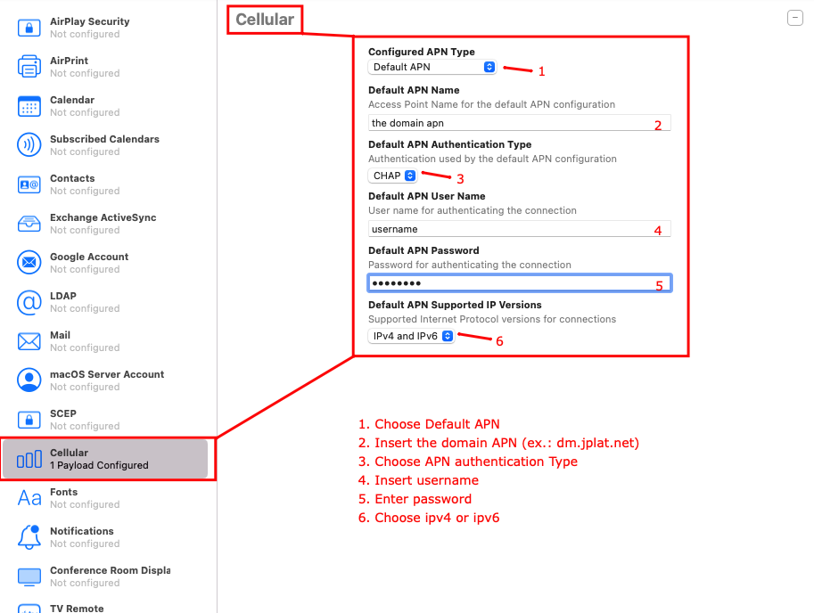

If you still facing problem and you have mac, you can make your own profile and install it.
You have to know the APN settings.
Then go to Mac App Store and download the: Apple Configurator
Opent it and follow the image instructions:
After completion of the setup, go to FILE menu and save it with desired name.
Then transfer to your iPhone and install it.
If the process fail, you can do it again.
Cya
