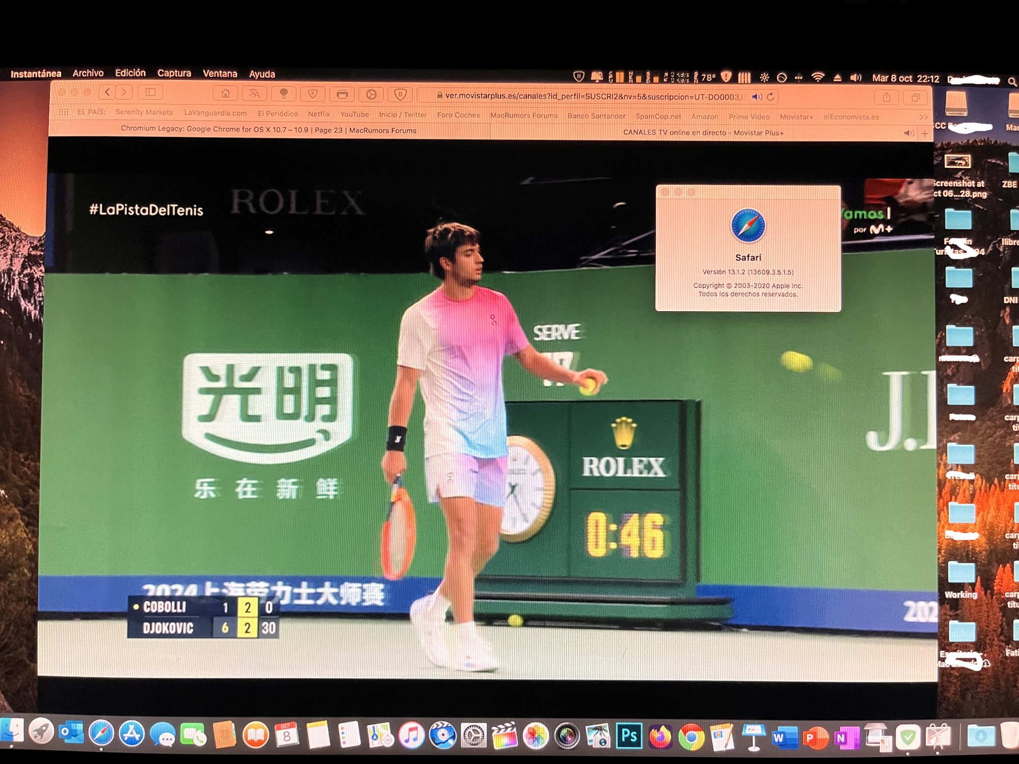

Look, I'm watching now the Shanghai tournament with Safari 13.1.2. And I've tested on the platforms, Max, Prime, etc, and it works without problems. Hight Sierra not virtualized. Installed on Imac 8.1 ssd. I'm putting a picture because the system doesn't support captures, that's one of the DRM security measures. Your problem is that you use virtualized Safari 13 on a lower system and it disables the DRM.
But how is it I can use Chrome 116 (horribly slow!) and Firefox 115 ESR in the same VM and Widevine DRM is NOT disabled ... (for now I can watch DRM content, at least until next March)?.
Safari is not a browser like the others. It is built differently and integrated into the system. And it uses a different encryption/decryption.

What I'm saying is that Safari 13 works fine on High Sierra playing DRM on all sites despite being unsupported for years. Legacy works on some sites and not on others.
