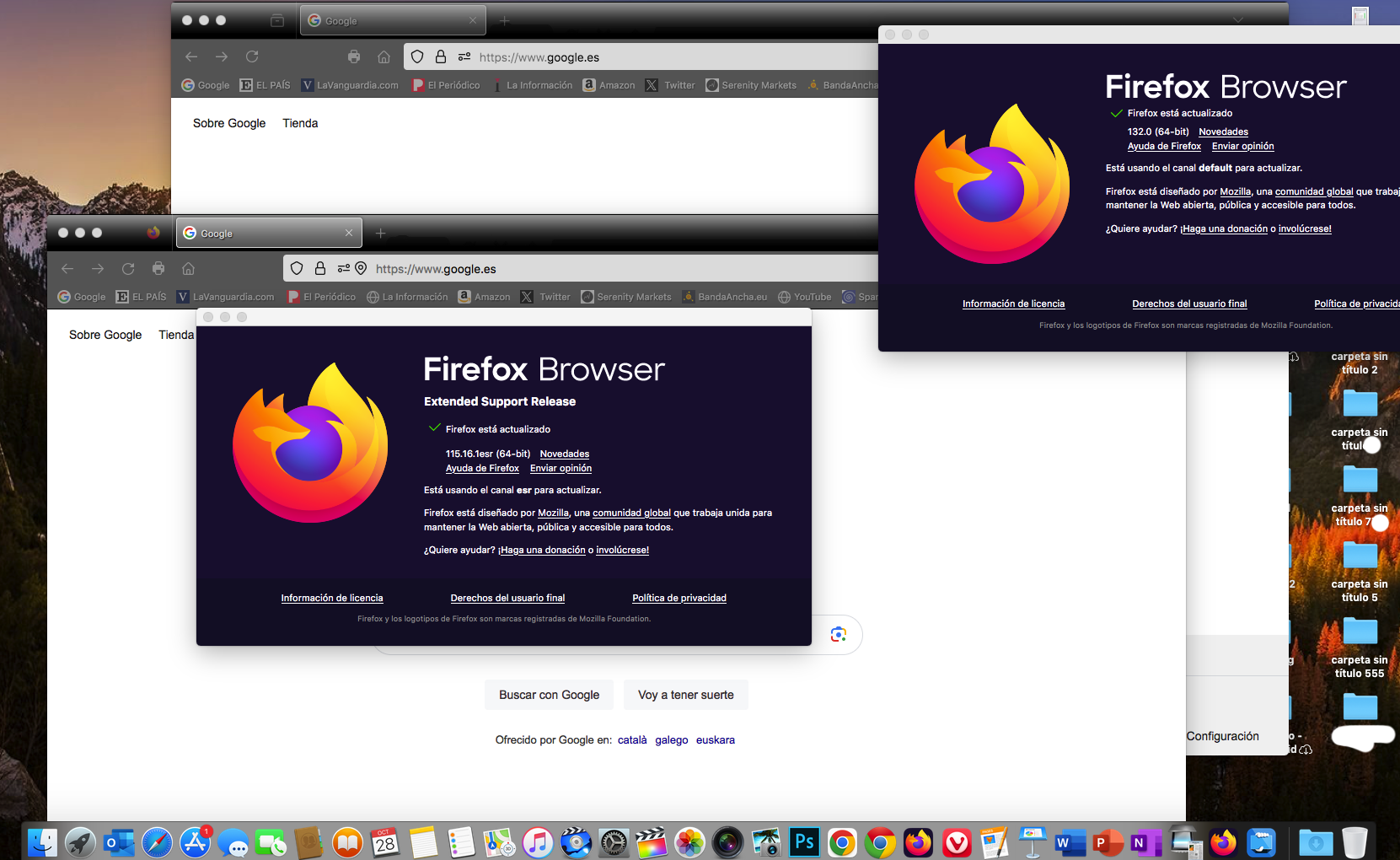

I think I'm going to forget about Chrome and all its derivatives forever There are three types of browser engines: Chromium, Apple web kit and Gecko. The first two = $, and Gecko is a non-profit Mozilla foundation. In High Sierra there is no Apple web kit development, in Mojave there is. Yesterday Kagi launched its 0.99 update for Orion OS minimum Mojave But interesting things are starting to come out for Gecko. The "Firefox Dynasty" guys in their last update four days ago have solved the startup problems in High Sierra and Mojave but they still have startup problems in Capitan, Yosemite and Mavericks. In a separate installation I test Firefox 132 in High Sierra, which Mozilla has updated and will no longer need Github. Until March 2025, I will work with the official 115.16esr and from March when Mozilla support ceases, I will replace the 115 with Firefox Dynasty's 132 and work a few more years with support. Yesterday I tested DRM with TV from my fiber optic provider (Arsenal-Liverpool, Betis-At Madrid, etc.), without problems.
Sorry, I'm confused. You're saying Firefox 132 now works in High Sierra, and we don't need Dynasty? .
Yes. It is updated by default Mozilla channel. Separated from 115.17 it allows me to test. Today the DRM of Max has gone away, but not that of Prime or TV provider. I have uninstalled the Chrome family and I will continue with this solution for my machine. Good luck.

I have absolutely no idea how you achieved that. Mozilla were quite firm : the only option I had for download was FF 115 ESR which I already have. There was no way to download 132, so Dynasty will be my future option after March 2025, if the Widevine thing is fixed.
