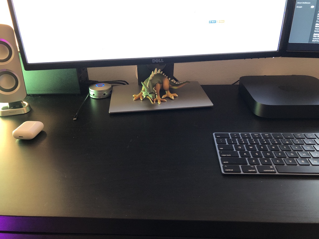

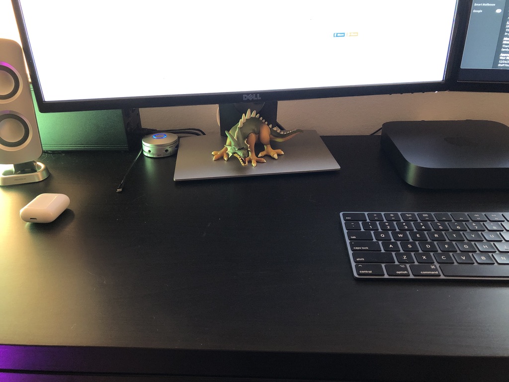

No issues with mine. I have the i5/8GB/256GB model. Have had my iPhone 8+ charging damn close to my Mini with no problems. Also have a AKiTiO NT2 dual storage box within 18 inches from the computer with no interference.
UNADJUSTEDNONRAW_thumb_5a1.jpg The lightning cable in the photo is where I usually charge my iPhone.

No issues with mine. I have the i5/8GB/256GB model. Have had my iPhone 8+ charging right next to my Mini with no problems. Also have a AKiTiO NT2 dual storage box within 12 inches from the computer with no interference.
View attachment 808532 The lightning cable is where I usually charge my iPhone.
Thanks, good to know.

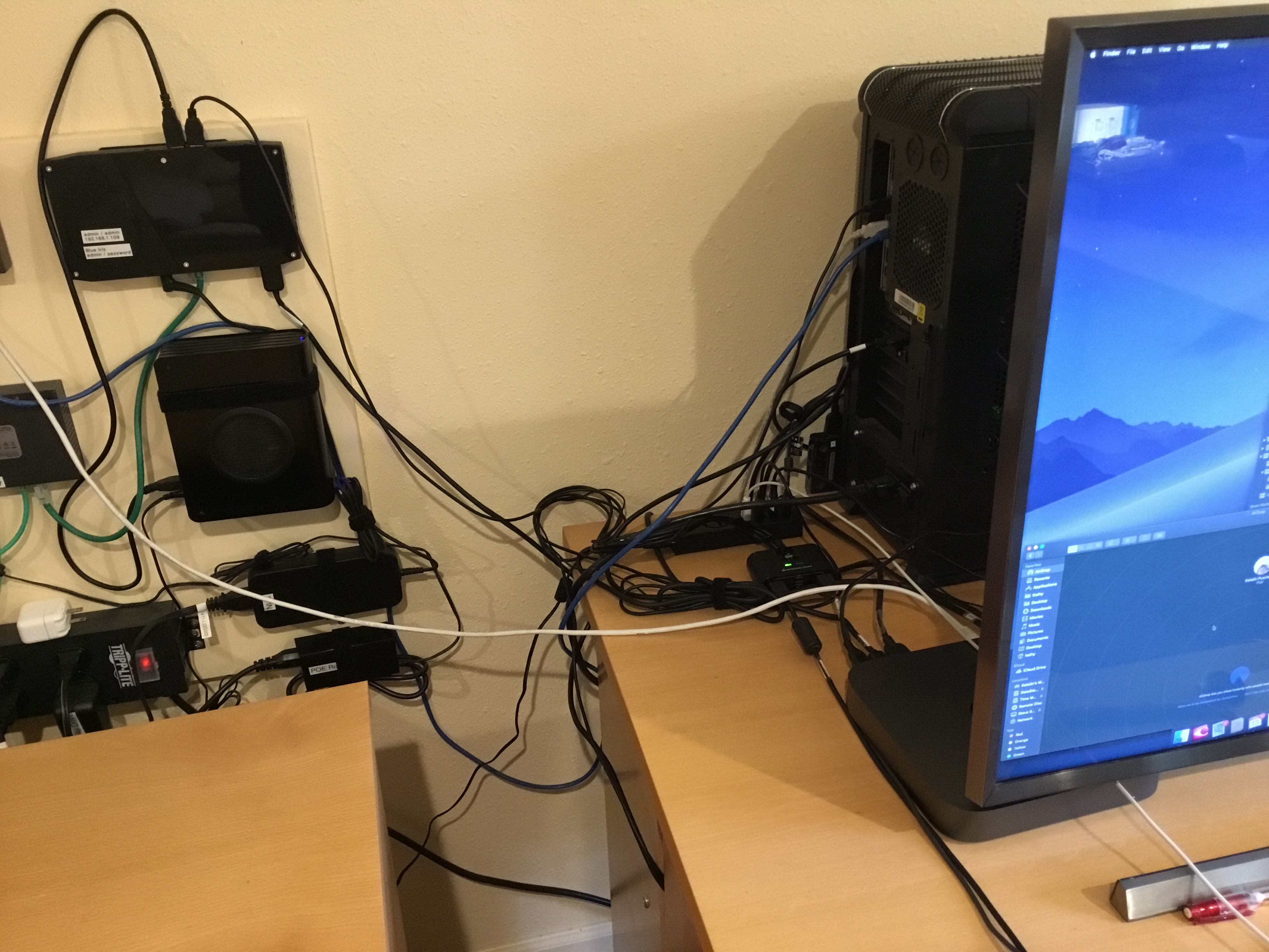

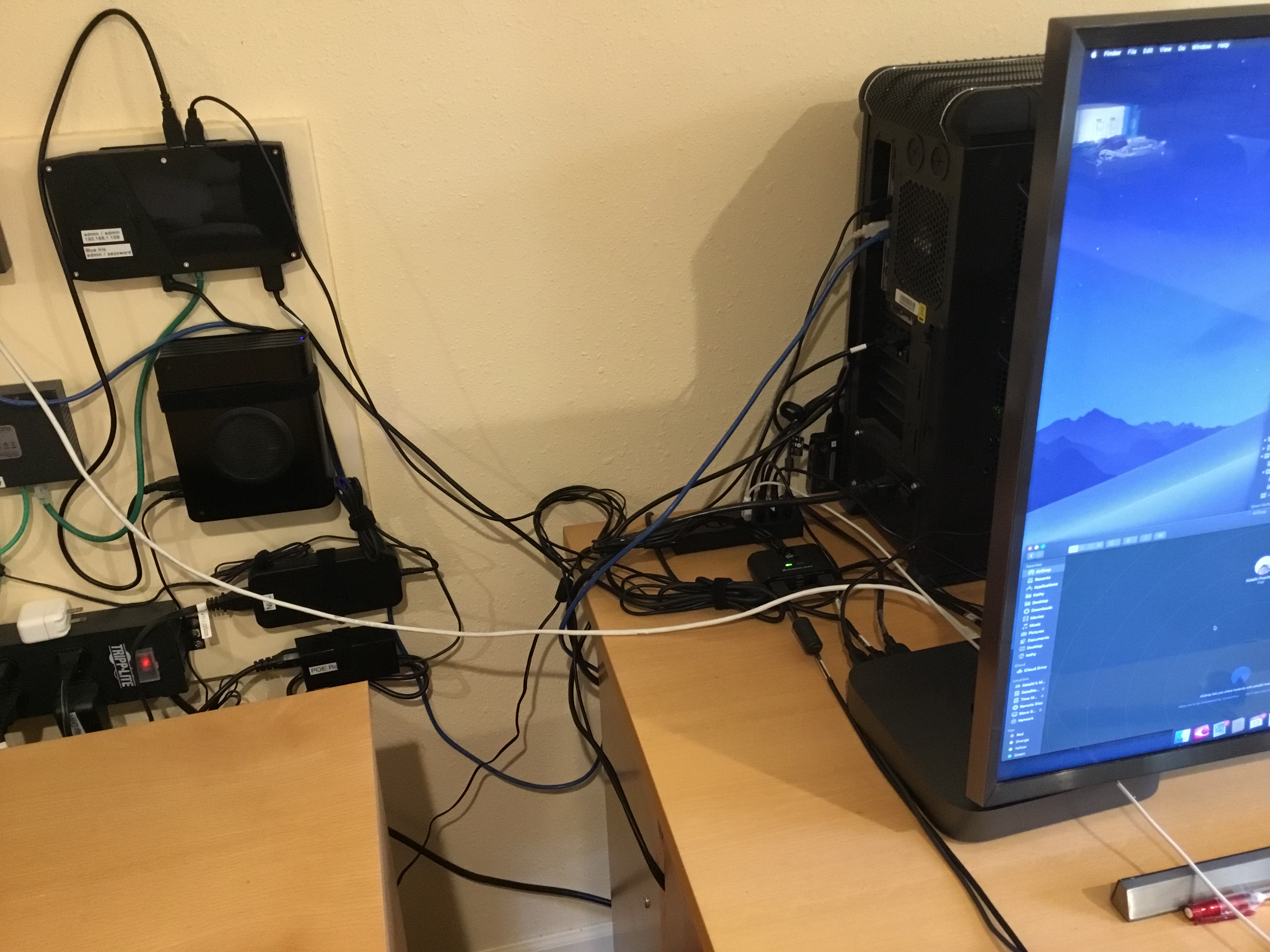

Mine is sitting under a Samsung monitor with a PC running 6 hard drives right behind it along with a powered usb hub a keyboardmouse switcher behind it. About 2 feet away are 2 external usb3 harddrives. Another 2 feet away is an intel nuc and poe box for our security cameras. No problems. I5/8gb/1tb. I’m not running anything wifi or bluetooth.
WiFi and Bluetooth is a must for me. My setup is wireless. Hope I don't have any problems with mine once I receive it.
