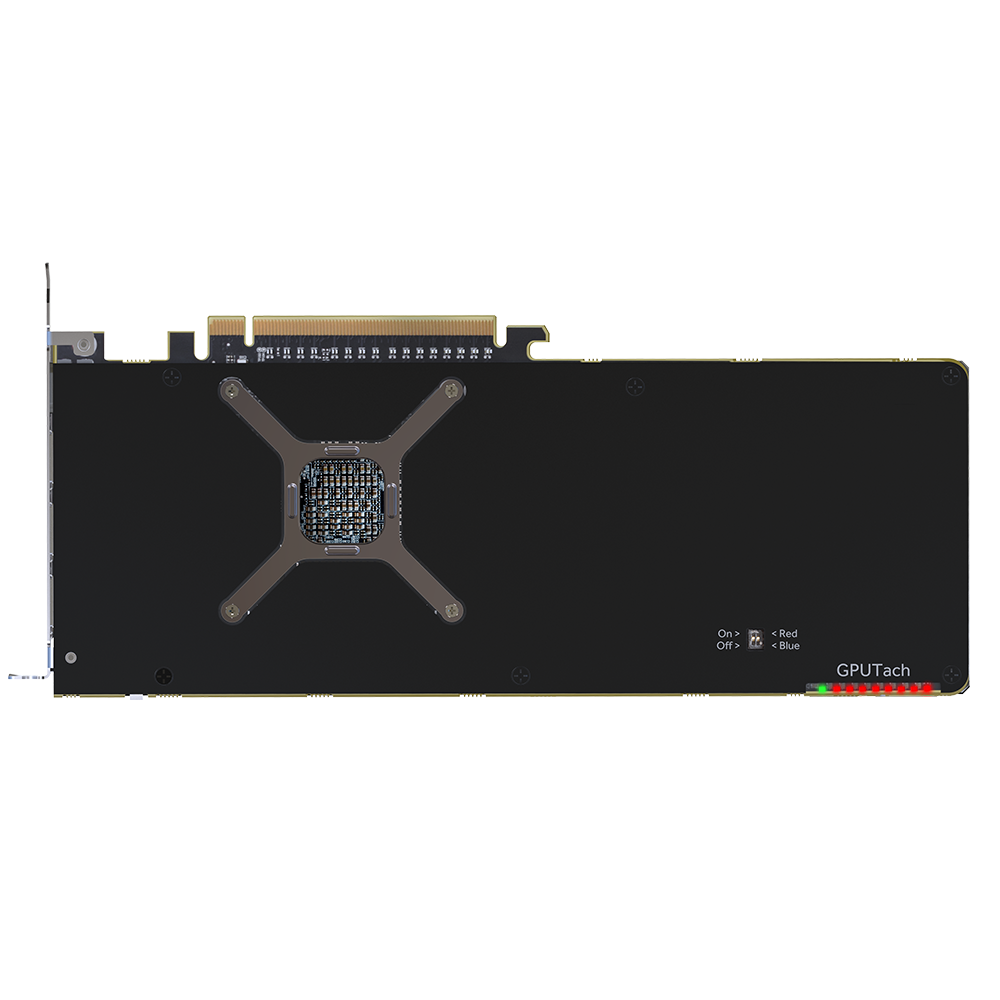

With the power saving ROM selected, VEGA 56 requires less power than a RX 580. No Pixla's mod needed.
See here https://hexus.net/tech/reviews/graphics/108889-amd-radeon-rx-vega-64-radeon-rx-vega-56/?page=3
Sorry, but with power safe as performance we are at the pulse 580 levels or less?
As noise then maybe it will still be a little higher than the 580 ... no?
One way to check this is looking at ROM settings. Sapphire Pulse RX 580 Max Power is 155W + 30% PowerTune (max 201,5W), while normal non-OC VEGA 56 is 165W + 50% PowerTune (max 247,5W). With the 25% power saving setting enabled, Vega 56 is 122W + 50% PowerTune (max 183W).
People that have VEGA 56 can answer about the noise levels.
MacManu77
macrumors regular
Jan 31, 2018
110
4
a little less than 20w of savings compared to the 580 .... I don't understand, however, even how overall the performance is lower than the 580.

Thats interesting, what power cables config should be used for the 2 x 8 pin sockets (assuming the card is used with the power save selected)?
I think that the safest way is to use an eVGA Powerlink and two mini-PCie 6pin. This way you will balance the power input and keep it always inside the safety parameters of the backplane power connectors.
OK thanks tsialex. And with that powering method the vega56 is still generally a faster gpu than an RX580?
tsialex
Contributor
Jun 13, 2016
13,461
13,613
For almost all compute tasks, benchmarks show that a VEGA 56 even on lower power consumption mode is considerably faster than a Polaris 20 or 30 card. For start, it's 56 vs 36 compute units.

I assume the Gigabyte and Msi versions are ok too?
Down here, PowerColor is the easiest one that you can find and practically all VEGAs that you can find on the used market are from them. I never saw a MSI VEGA 56.
tsialex
Contributor
Jun 13, 2016
13,461
13,613
Can't help with these cards, I've been researching the models that I can find here and what my friends have and work. Seems both are reference cards, try to find reviews or images of the back of the card to see if it has the power saving switch.
