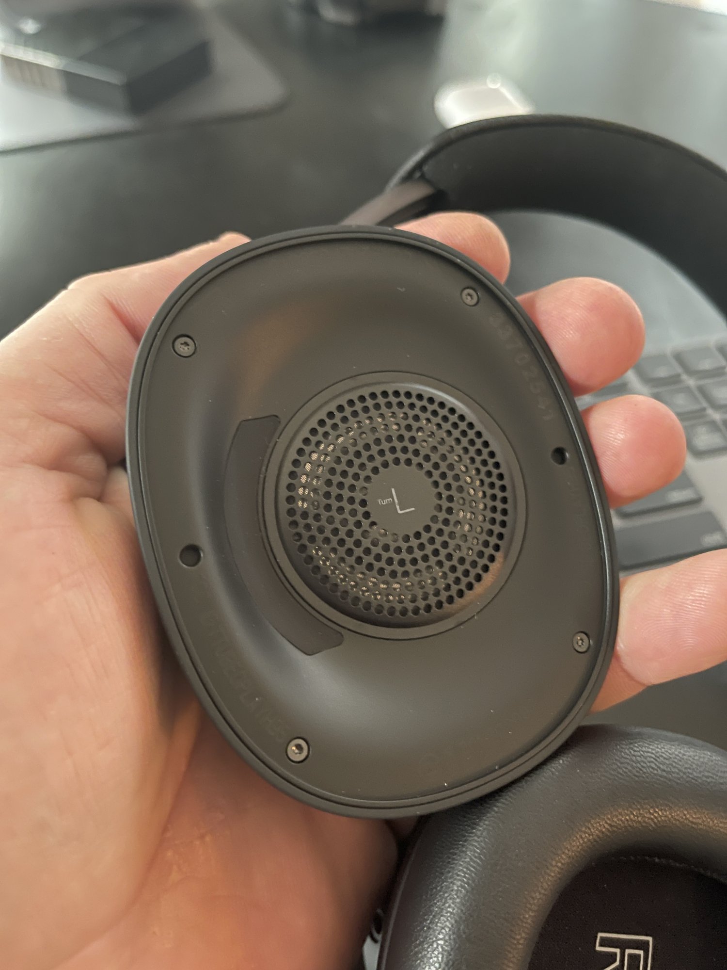

Sad to say this, but mine are going back today because of this. This amount of water after 1-2 hours of listening (this doesn't even classify as "long") cannot be good long term.
I've been through the butterfly keyboard ordeal and don't want to repeat it.

Is this condensation or ear sweat?
It's both.
Air between the ears and headphones is somewhere around body temperature. Sweat evaporates and saturates the air up to 100% humidity, when the moisture starts to condensate. It will always condensate on the coolest and most heat conductive surface, which is - metal parts of the headphones. This is also why the mesh remains dry.

I think the problem is insufficient ventilation, exacerbated by the metal construction.
I feel like the AirPods Max have worse ventilation than the Bose QC35, which feel much less hot and humid for my ears.
I noticed this while taking the AirPods Max off my head: there’s a noticeable feeling of suction as the earpads decompress. If I push the QC35 earcups against my head and then take them off, I feel less change in pressure and I can hear air whistling through a vent somewhere.
So it seems that despite the “mesh fabric” earpads, there is not enough ventilation to keep the humidity inside the earcups in check.
Even plastic headphones would eventually have condensation problems (or sweaty earpads) if they have no ventilation, but the metal construction will make condensation occur more easily.

I get this on my Sony WH1000XM3. I've had them for a long time and it's no big deal. Have none of you owned over the head cans before? Your ears are gonna a sweat and there will be some condensation. I think it's pretty common for this type of headphones.

I can confirm I have the same issue and that it is also linked to the issue of the ANC failing and the wind noise. The drivers get wet and the noise starts up, ANC stops working and sometimes no sound comes out of either ear. A restart helps but this is extremely disappointing.

So you are saying it’s normal for the drivers to be affected and for functions to work erratically due to it?
It’s one thing for them to get wet but for it to affect the functionality is worrisome.

"The typical ear canal is a warm, humid environment. Add a little perspiration and the result is a lot of water vapor floating around inside the earphones. When the ambient air temperature changes, that water vapor condenses"
So is the AirPods max generating more condensation than other headphones by some faulty design?
