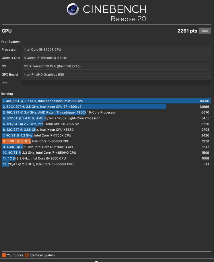

Interesting...did you remove the bottom plastic cover?
Would you mind trying a Cinebench test with and without the fan on?
Based on the observations in the preceding posts, I think these fans are probably a good option to keep a mini cooler while under general use, but once all the cores get active, they don't prevent the CPU temp topping out regardless.
Yes, I have removed bottom plastic cover.
Cinebench with cover removed:

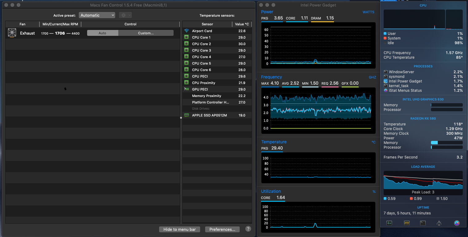

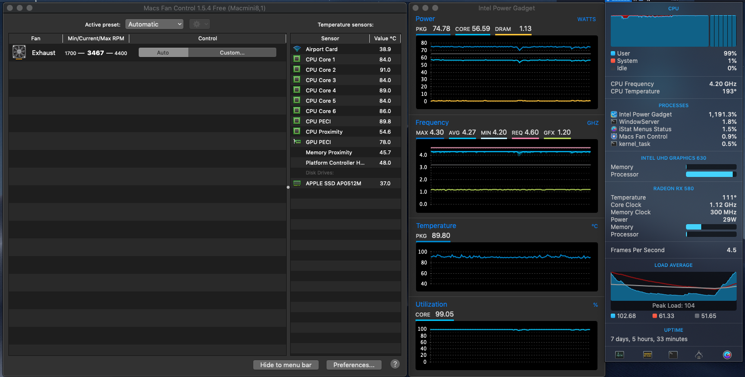

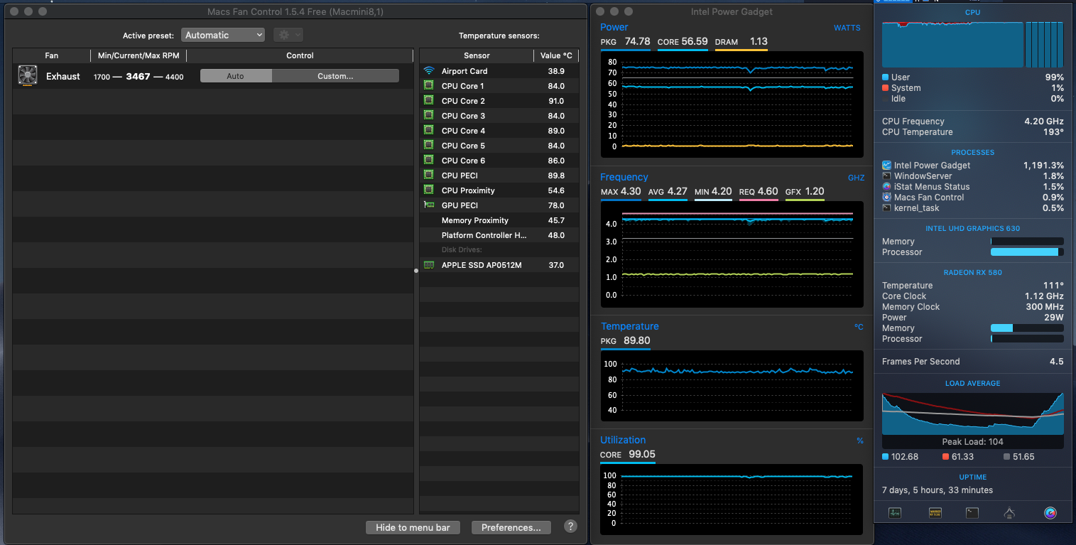

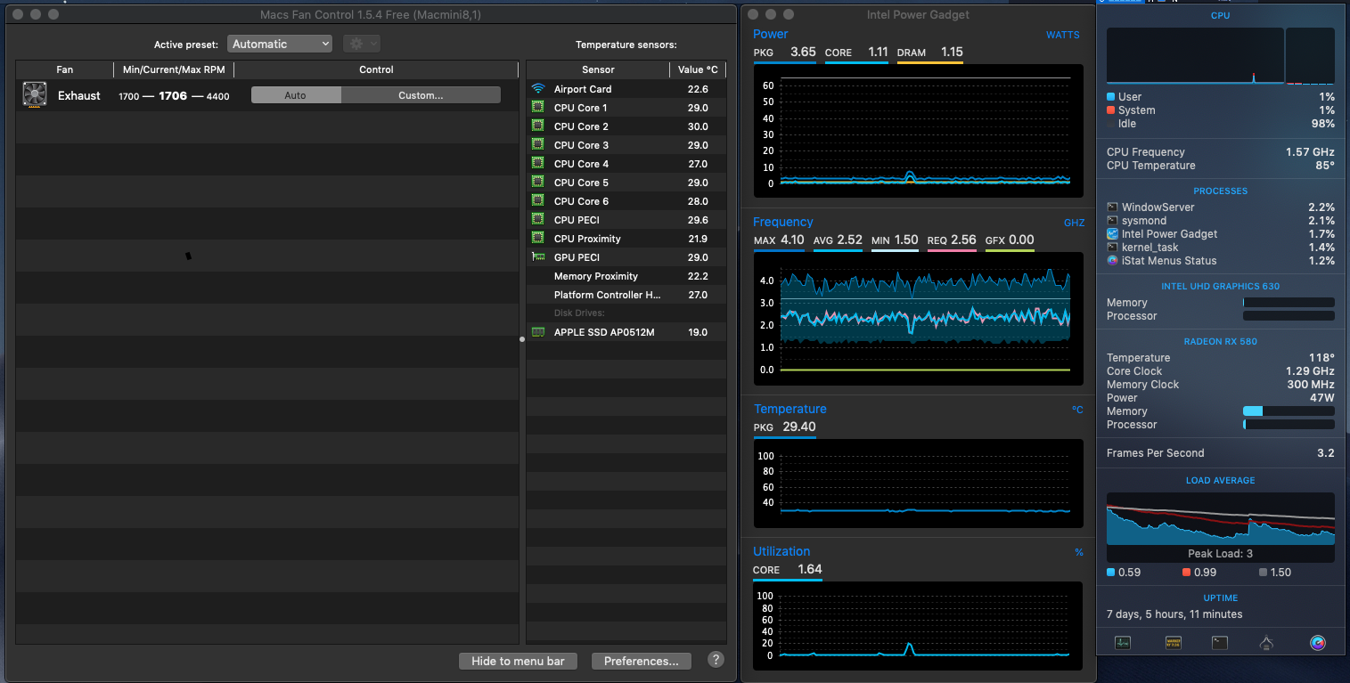

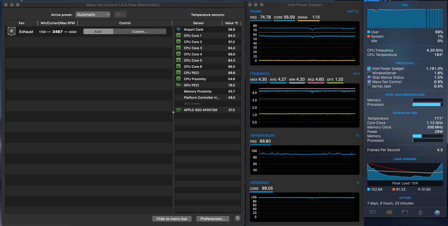

I bought the Speed Designs Base for my 18-i7/32/500. My Mini was regularly pushing over 100c. Because I can't leave anything alone. I replaced the fan on the base with a Noctua NF-A8 5V PVW. Control it with a NA-FC1 and new filter. Had to cut a hole in my cabinet to accommodate thicker fan and filter.
Ran some tests. Post some Screen shots of System Idol, Test and Rig
Macs Fan Control set to "Auto". Intel Power Gadget CPU set to "All Tread Frequency" and Intel Graphics Tests set to "Maximum Frequency". Ran this for 30 minutes then a screen shot below. IPG test mode pushes the Mini pretty hard. I hovers around 90c. Pushing Macs Fan Control to a custom setting like 4000rpm will cut 3 or 5 more degrees off the test.
More info for the discourse
rig
Idle
test

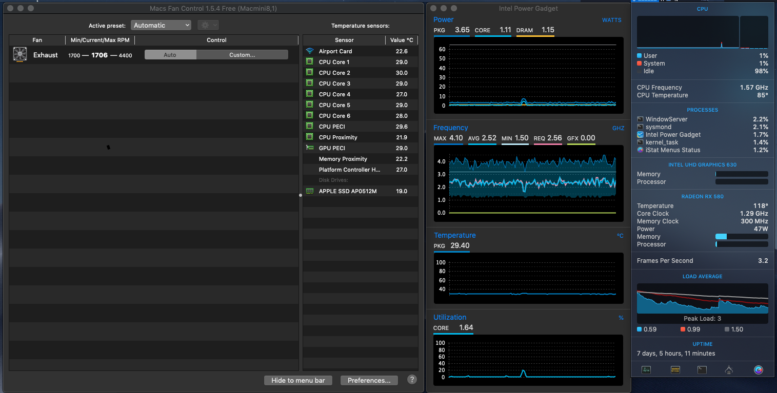

rig
Idle
test

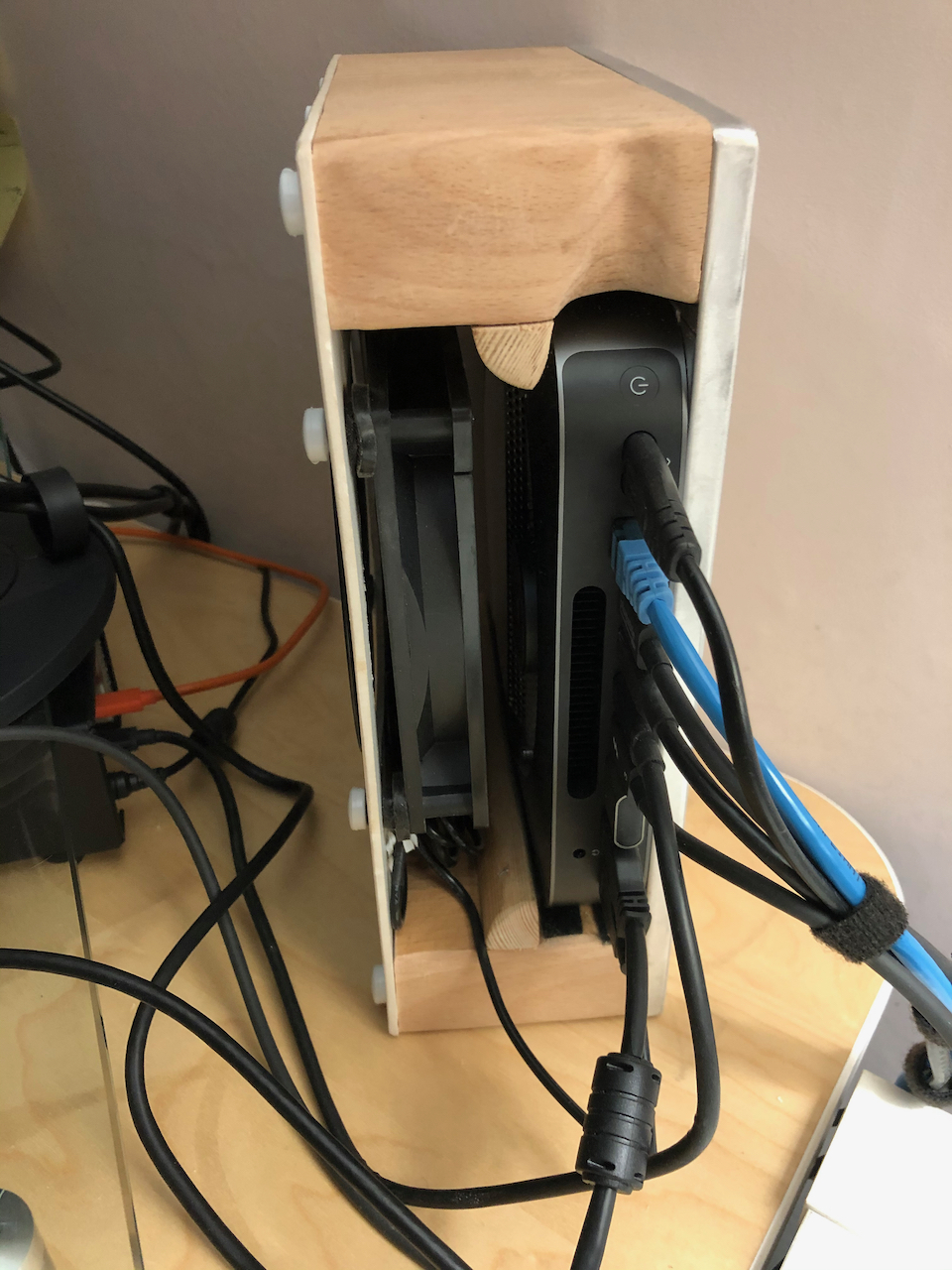

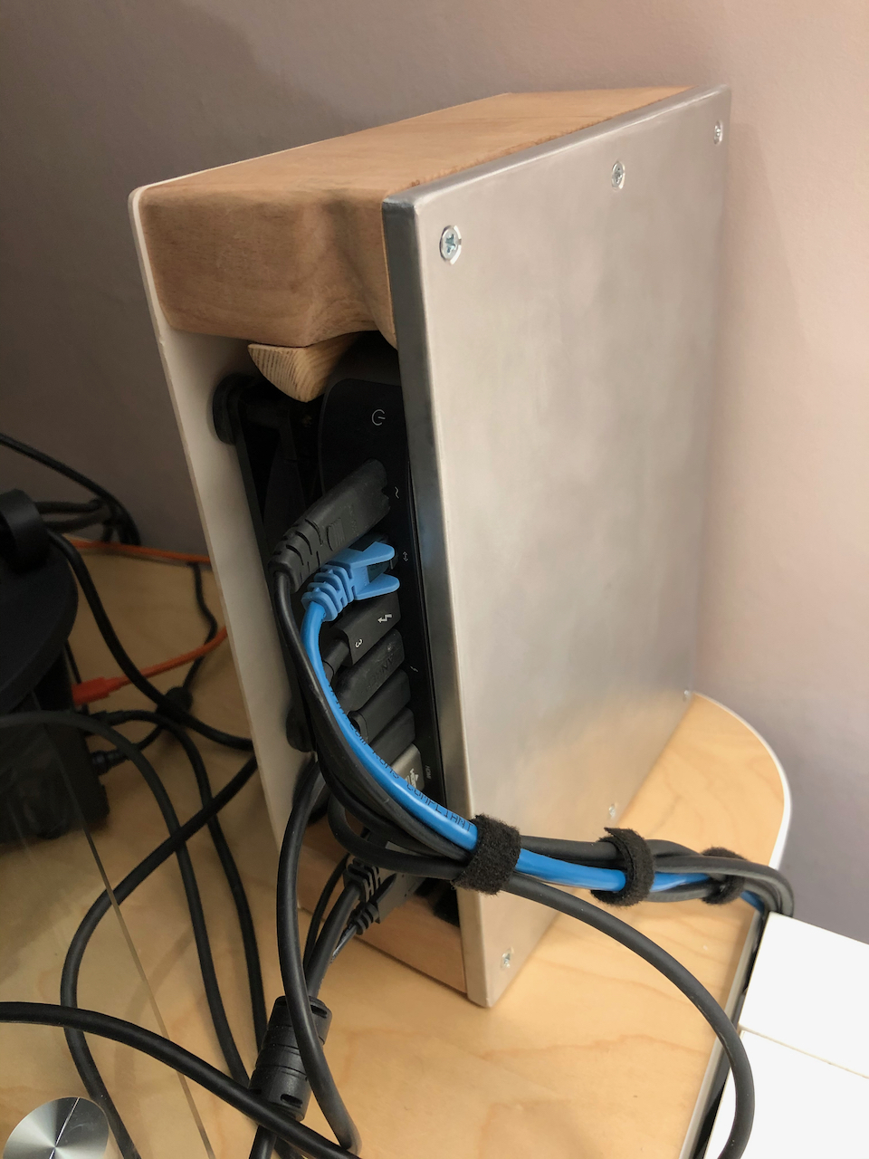

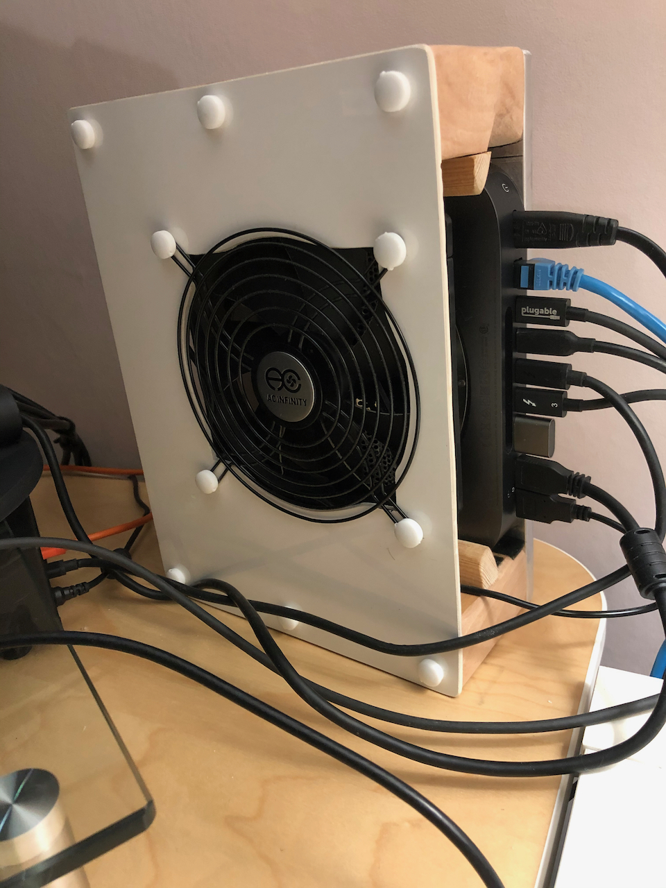

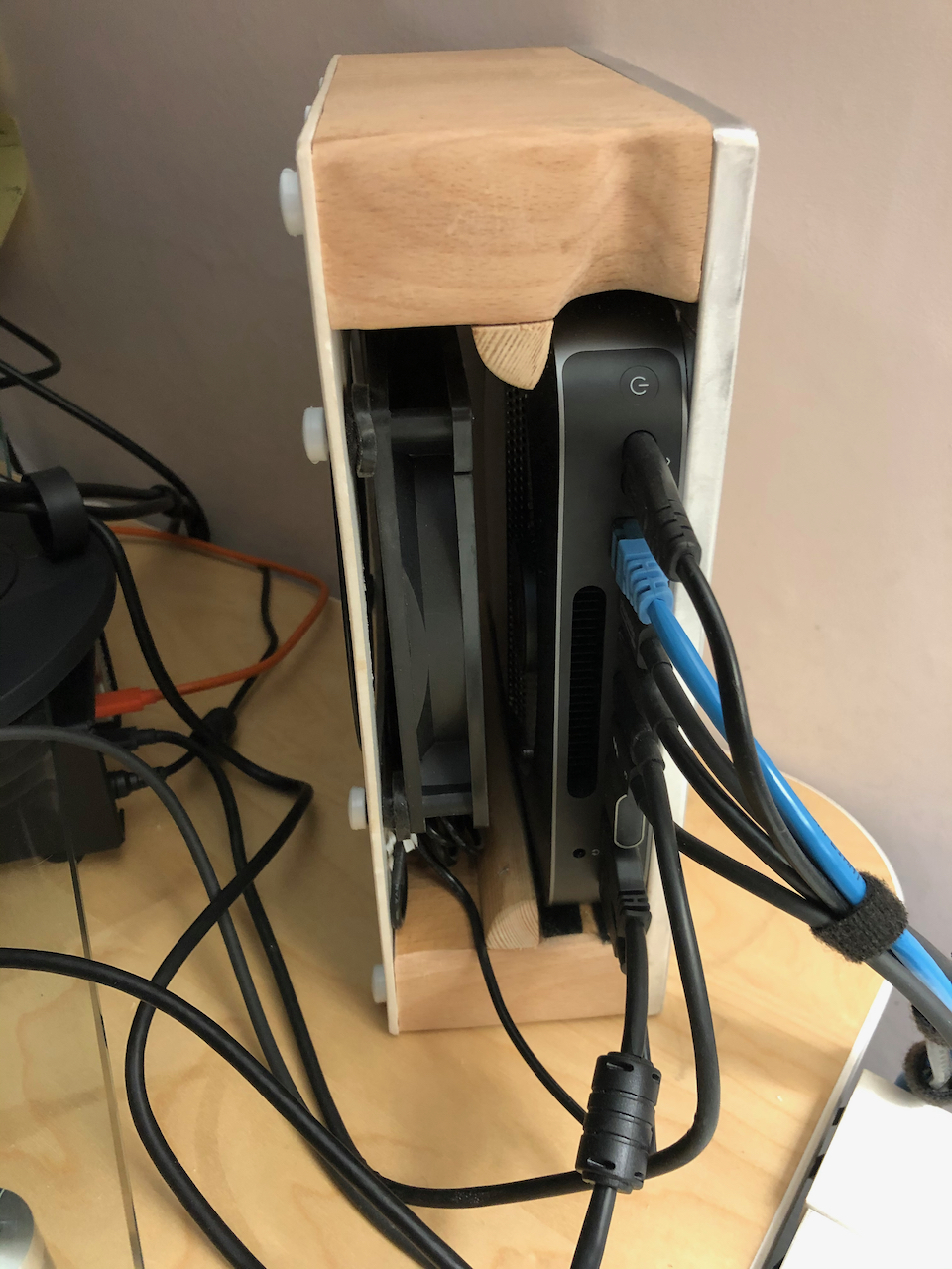

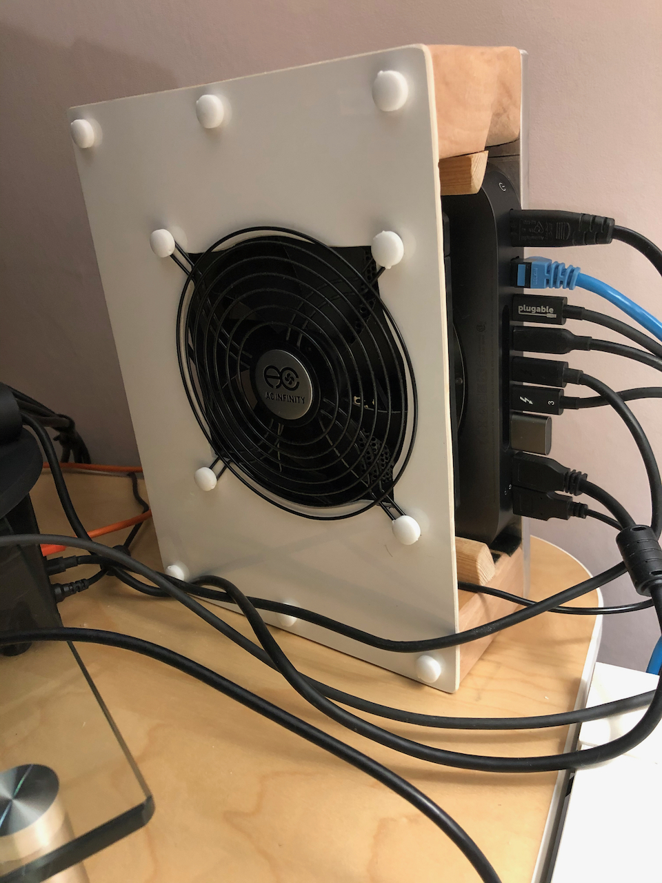

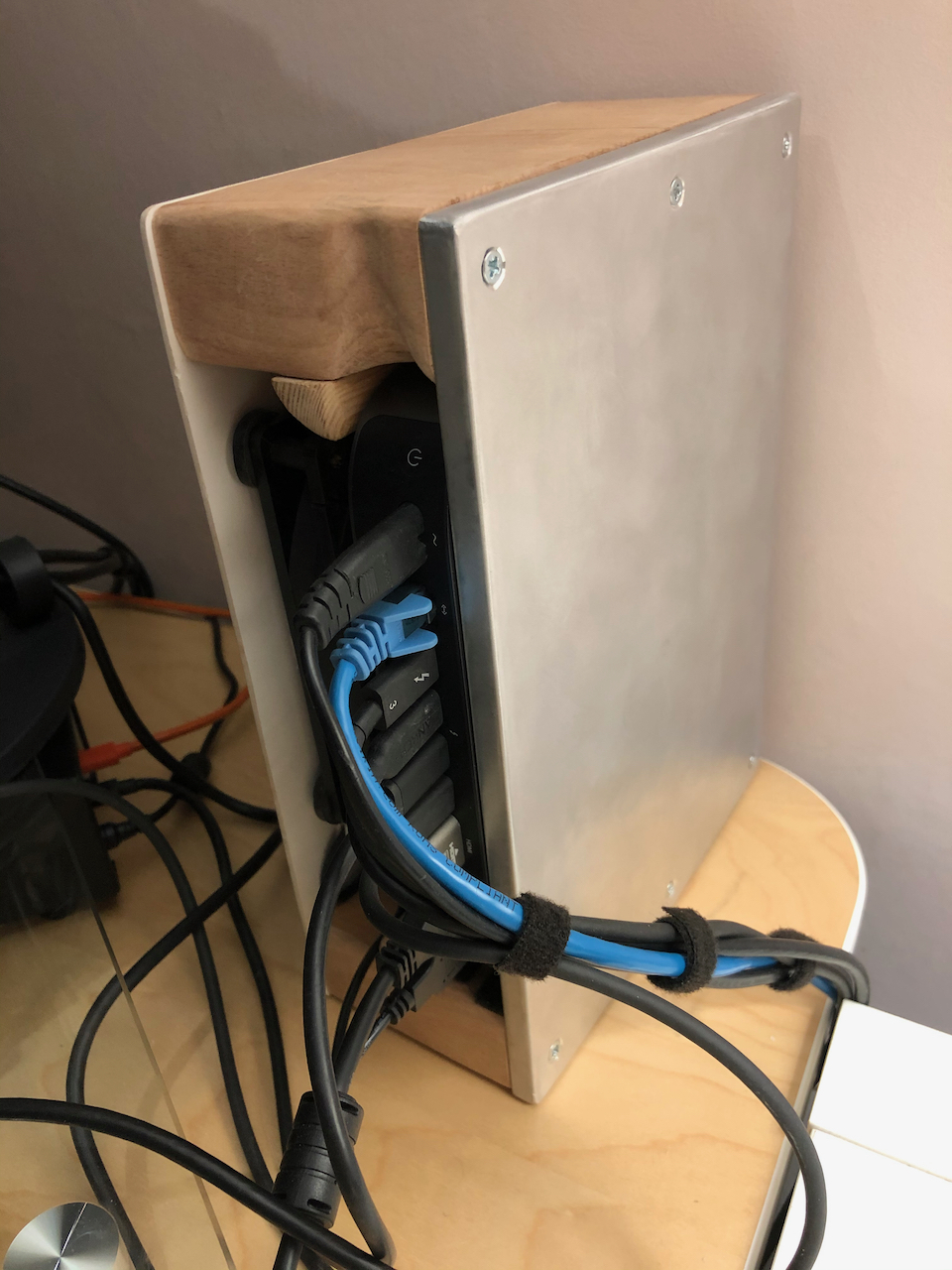

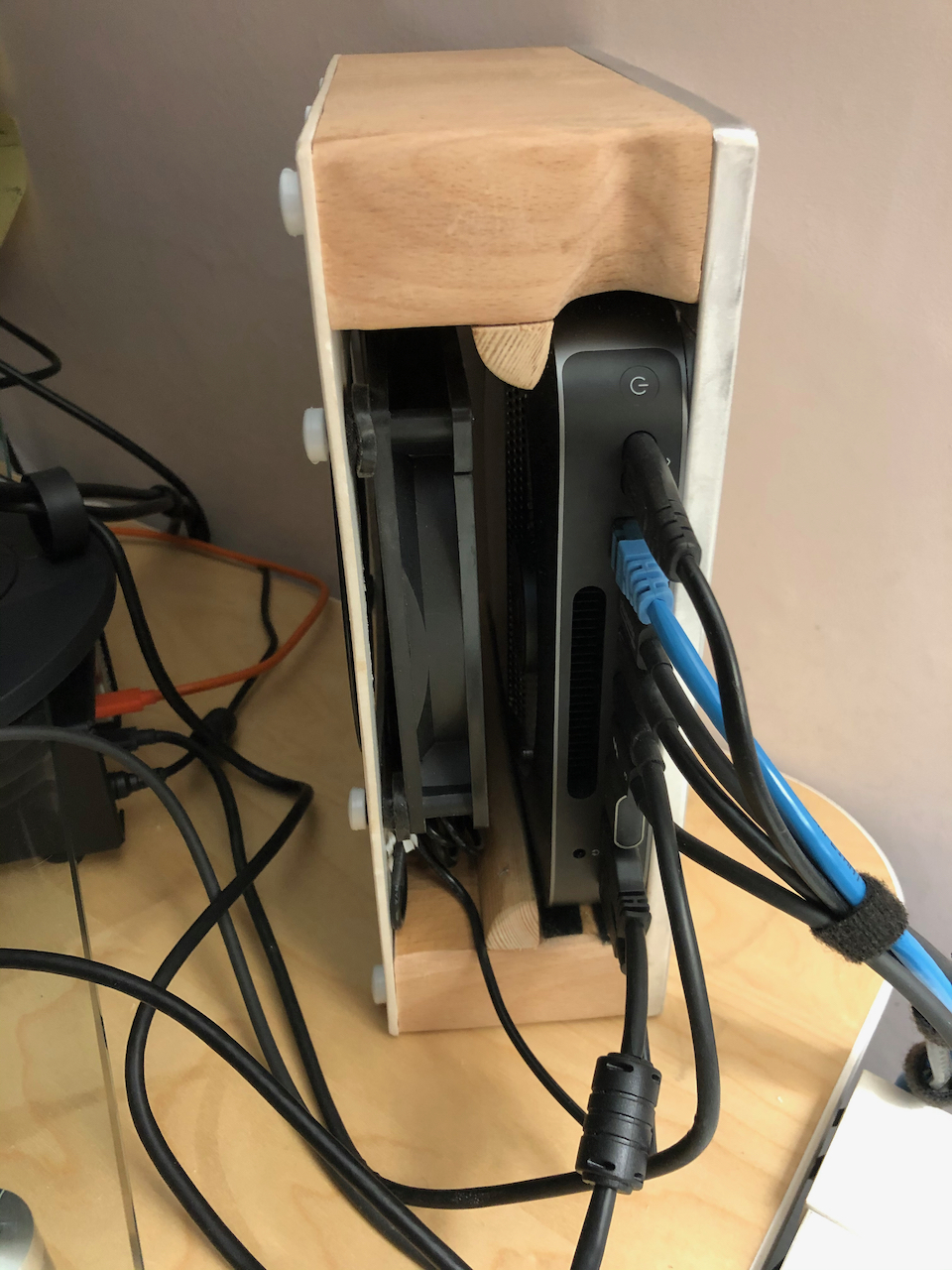

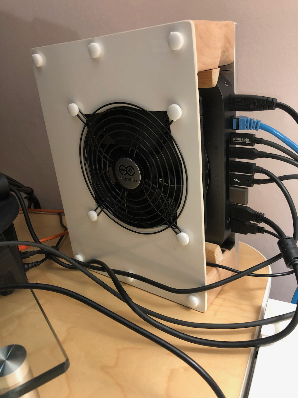

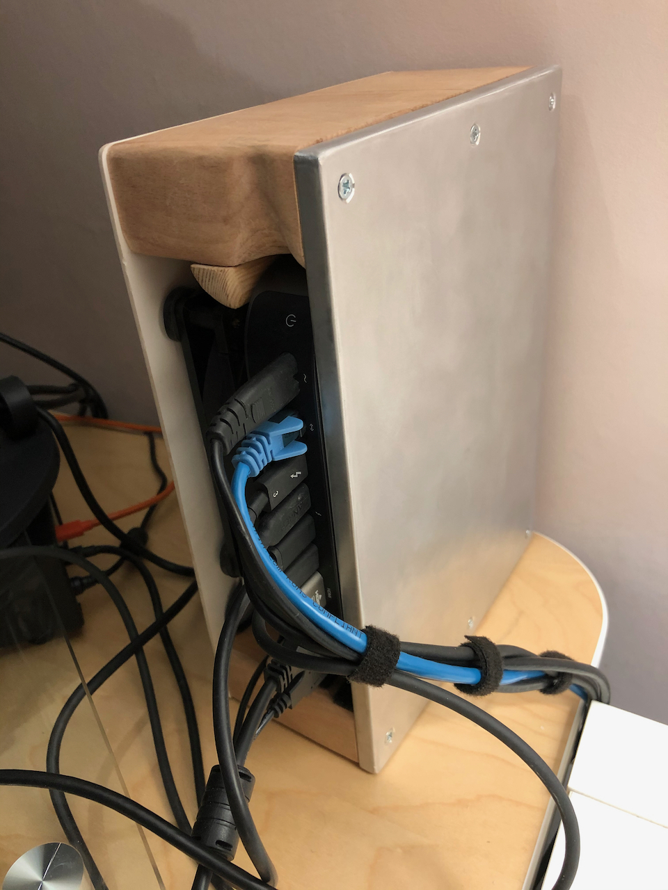

I've built a case that uses a large silent fan to draw in air to the open base. On the other side there is a large slab of aluminium. I used heatsink tape on the aluminium so it has a good contact to the top of the mini but can easily be reversed without damage. There's also a rail and stopper to slide it in and stop it from going out the other side. There's a switch to increase the speed of the fan that plus into one of the USB ports. I shaped the wood so it was easy to access the on switch on the Mac mini as well. The fan is rarely on full speed.
Originally I was going to add a heatsink fan to the aluminium but as the item rarely goes over 50-60c even when using large photoshop files... and maxes out at 90c when exporting large 4k motion graphics I've Neve bothered. The normal running temp in winter is 29-31c and in summer it's been 35-38c under normal use.
The pics are a bit rushed as I just snapped them now to give you and idea of what I've done. Hope there useful.

I've built a case that uses a large silent fan to draw in air to the open base. On the other side there is a large slab of aluminium. I used heatsink tape on the aluminium so it has a good contact to the top of the mini. There is also a rails and stopper to slid it in and stop it from going out the other side. There is also a switch to increase the speed of the fan that plus into one of the USB ports. I shaped the wood so it was easy to access the on switch on the Mac mini as well.
Wow thats creative! I wouldn't be as much, so was just thinking that if I bought a piece of lets say 1cm thick aluminium plate in 30x30 or 50x50 to just put on top, then it would end up in lower fan-noise?
I'd imagine, if the mini is standing free (level not on end) and elevated off the floor and with a nice large heatsink fan attached to it with heatsink tape for good contact then it should help. The top of the mini does get warm so any active cooling will help. The fan on the open base (with no cover) just helps to remove the build up of warm air. The combination of course works best. Try just adding the heatsink first and run benchmarking software to see how quickly the temperatures rise etc and whether the mini maintains max power using Intels free power gadget app. If it handles that well then it should handle most things.
Edit - The heatsink fan would attach to the aluminium plate and I think you can get adapters to convert the power cord to usb so the mini can power it itself.

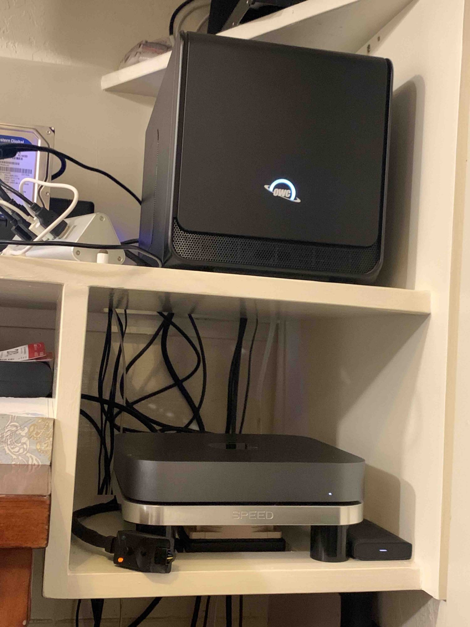

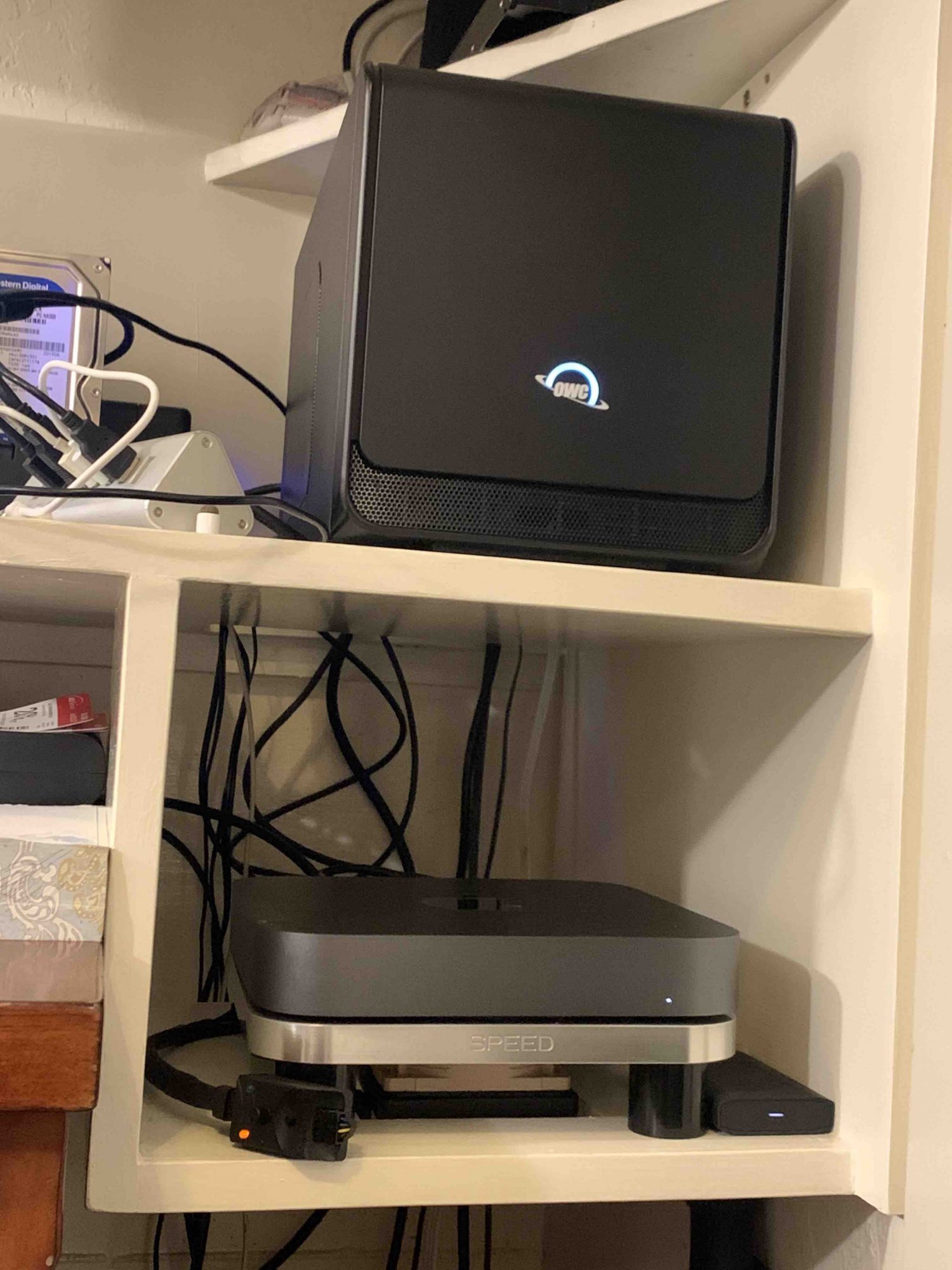

Been awhile since I posted here.
The Speed cooling base has been working well for me. Small price to pay for a good investment. Keeps the Mac mini cool (not even warm) and doesn't look out of place on my desk compared to DIY solutions.
I don't know if you guys are willing to stomach the price, but it's worth it if you want something professionally made.

Do you have to remove the plastic cover from the bottom of the mini to use this SPEED Base?
From everything I have seen and read, yes, the product is designed to have the bottom of the mini removed. I will let you know for sure, since I bought two on Friday. I plan to add some sort of filtering material to the outside of the fan to keep the dust intake down.
